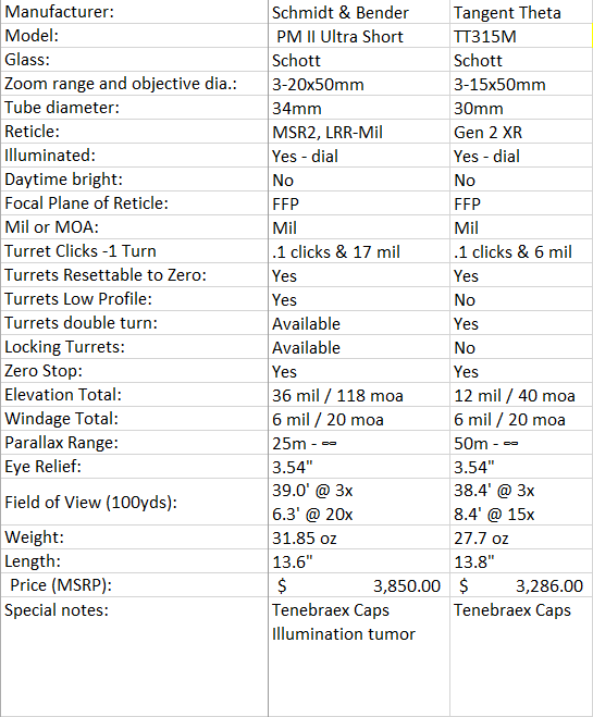

Generally, if we are talking about "bang for the buck" in a precision scope, Delta Stryker 4.5-30x56 is probably it right now. I'll talk to them and see how they plan to get into the US market, but they really should. This is a seriously nice scope.
Ultrashort S&B 3-20x50 is indeed a very nice design, but there are a few things about it I decidedly dislike. It is the same overall size as the TT315M, but a few ounces heavier (~5, I think). I am not a fan of the illumination turret location. Importantly, the only Christmas tree-style reticle available in it are the various Horus designs that I am not a fan of. At all.
ZCO 4-20x50 promises to be in the same size and price range as the S&B, but with a reticle that is more to my liking. I am very curious how that is going to work out.

Now, as a general disclaimer: I think what you have is more or less at the sweetspot of the "bang for the buck" category and going significantly above that gets you into serious diminishing returns.
I have no doubt that you're correct. In most hobbies, it seems that you can spend a lot of money chasing that last 10% of performance.
I see now what you're getting at ILya, not just any 4-24x50 but a premium alpha quality 4-24x50, that excels in every category, not just here or there. Schmidt is probably closest to making something like this, they got close with the 3-20x50, but I agree, a more appealing zoom range would be in the 4-24 as it still gives enough FOV on the low end while providing 24x at the top when necessary. One other request I would say is to keep the weight and length down. Something 14" or less and around the 30oz mark would be ideal (well less would be ideal but I know we sacrifice robustness for weight at times). I guess I keep coming back to the March 3-24x52, if they could put out a better reticle, add high master glass and maybe bump up the parallax to 25 - infinity in order to allow the parallax to be a bit more forgiving, I think I'd really be content with that scope.
That illumination tumor drives me nuts, I've been hoping for a PM III for a couple years now that would resolve that, but I can live with the tumor if they put out a good reticle. I am waiting for the MSR2 to make its way to this scope as I really like this reticle (and someday if the LRR-Mil ever makes it that might be of interest as well). I would have preferred a 3.5-23x50 instead of the 3-20 since they already had a 5-20 but what can we do, they make what they make. The 3-20 is definitely usable and the only reason I haven't invested in one is the reticle and the price as I wish they were nearer to the $3k mark.
In comparison to the TT315M, you're right, they are close, but at 5x more on the top end I think the Schmidt has a distinct advantage. Yes the Schmidt is 4oz heavier but I think it's worth it for 20x vs. 15x and the Schmidt is slightly shorter than the TT. One of my favorite scopes was the Premier LT which is the TT315M's older sister, but I do wish TT would have put in 10 mil turrets with a bit more travel as some will find 12 mil limiting.
I agree, the ZC420 definitely has my interest but I do wish they could have kept the weight down as it's near 35oz. But if the optics and mechanics prove true to their claims and this scope exceeds the S&B US 3-20 US then it's going to be hard to pass up.
