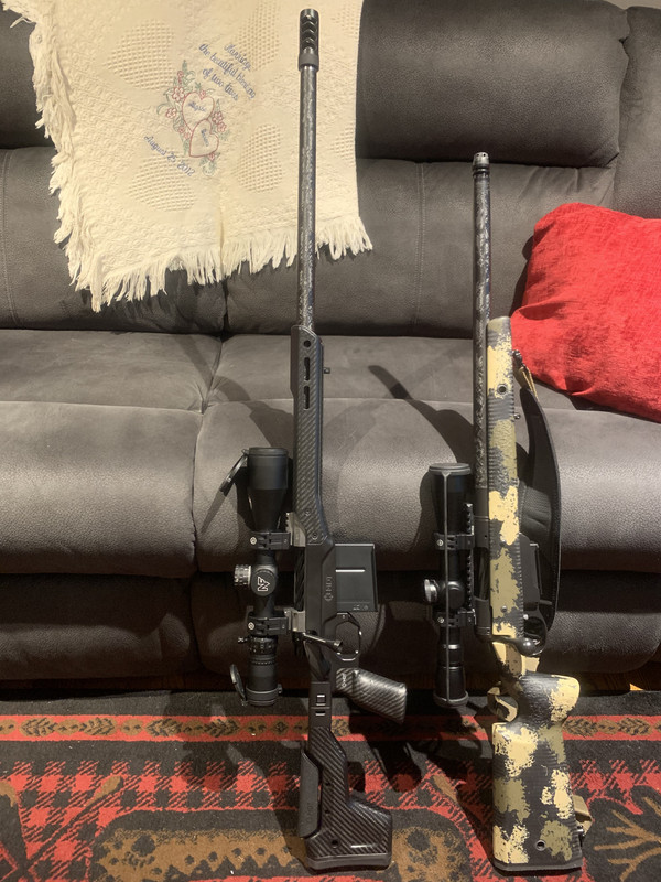

Earlier this year I built a 300prc off the following parts
-Defiance anti-x
-proof 26” full sendero CF
-MDT HNT26 with the folding stock
-MDT 5 round box mag
-NF NX8 4-32
-Triggertech diamond
-ARC rings
Not sure how accurate my wife’s food scale is but with the magazine and no muzzle device it shows 9lb 2.3oz.
Even with the area 419 match brake this thing is a handful, can’t wait to see how the magnus does on it if it ever gets released. The rifle beside it is a 20” 6.5prc full sendero on a savage action, PTG bottom metal, EH1 stock with their mini chassis and a 3-15 vortex razor HD LHT and the 300 is a few ounces lighter.
