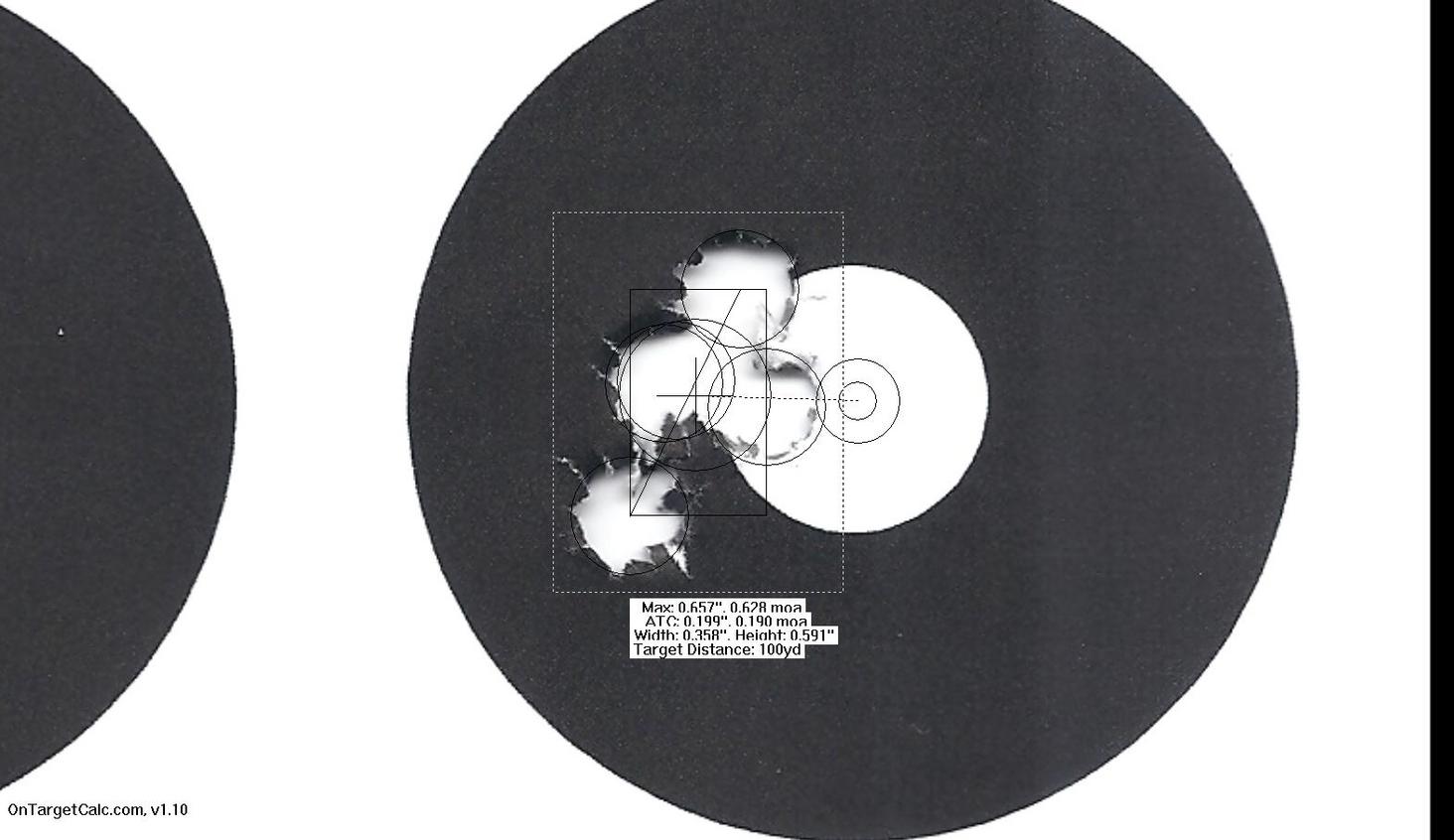

Had the same issues with one I had. The load I finally settled on was 44.1gr Varget, Win brass, br2 primer, 175 SMK seated at 2.81 oal. But It also took over 400rnds before the rifle settled in and started shooting more consistent. Oh, I also cleaned every 50-100rnds until it hit that spot. Here was a typical group with that load.
