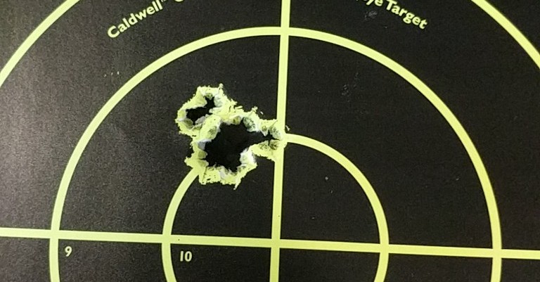

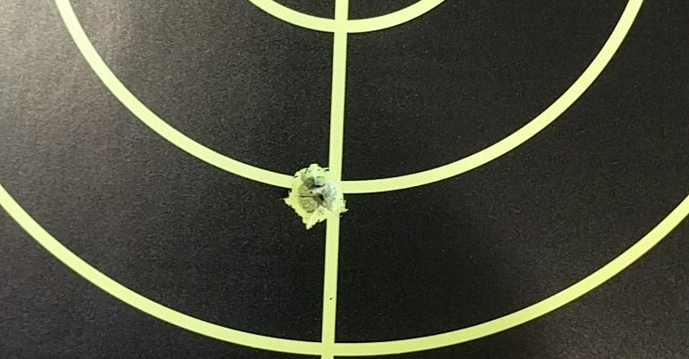

you 100% sure your rifle is zeroed at 100yds? Your actual comeups at 300 and 400 sounds like its zeroed at 150yds or somewhere close. The AB data - 1.0 and 1.8 - sound dead nuts on. I would be very impressed if you were out shootin in 150*F weather - damn impressed :)
Here was initial group. Adjusted and took last shot for cross section.
Distance measured with radius and kilo 2200.

I'd recheck your zero and make sure you not a little high at 100 dead nuts. I'm running almost the exact set up as you with the same bullet at 2758 from a magnetospeed and seeing .4 mils at 200 and 1.6 at 375. This is at basically a 0 ft DA.
