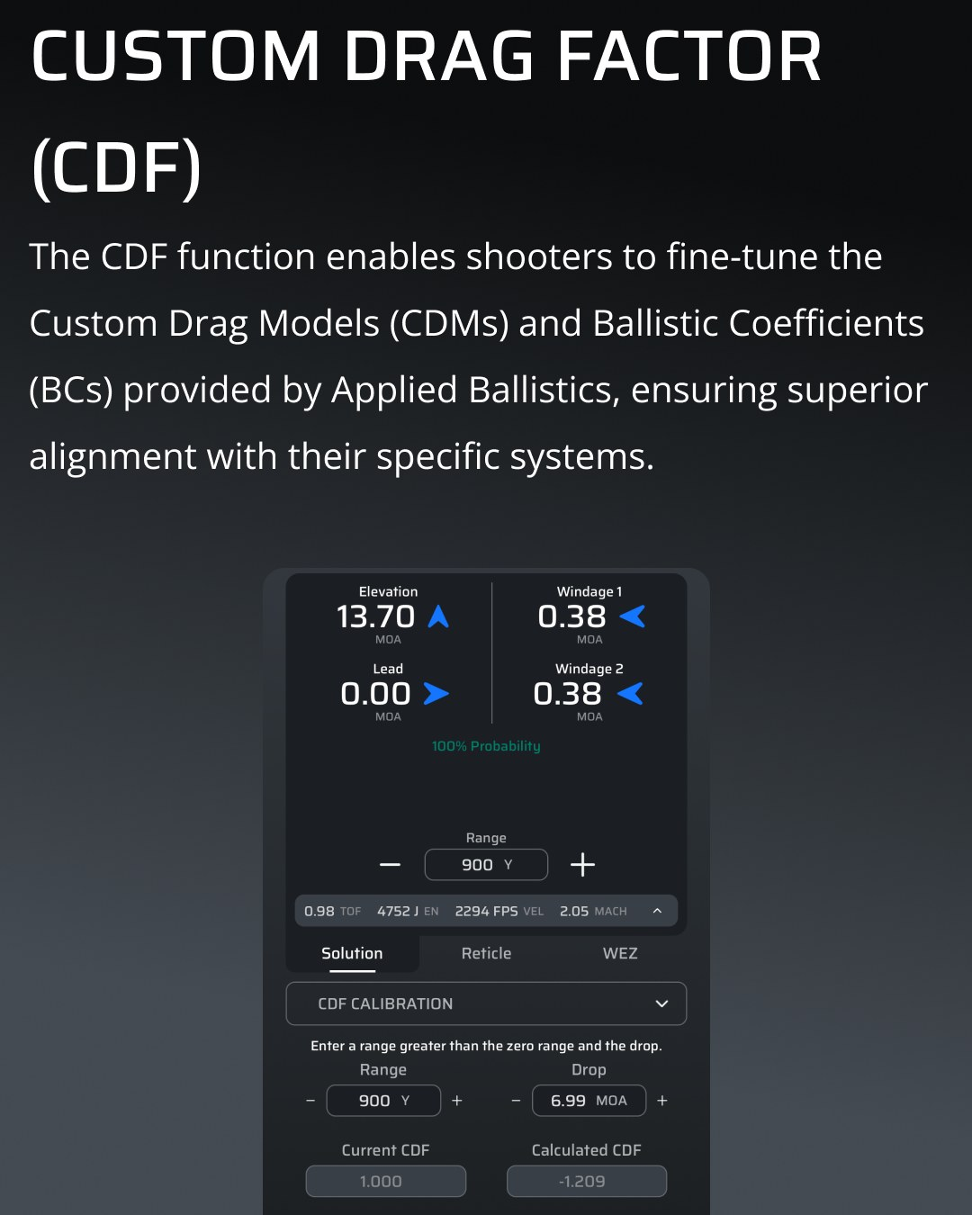

I’m a dummy but if you do CDF on the app and get your correction, can that correction be utilized on the Kestrel Elite?
Will the Elite get an AB update to have CDF?

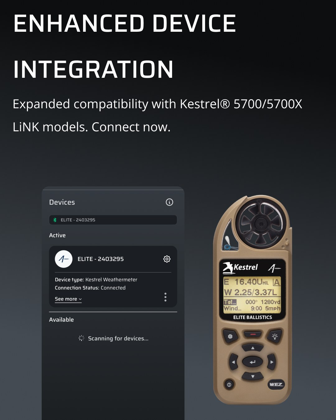

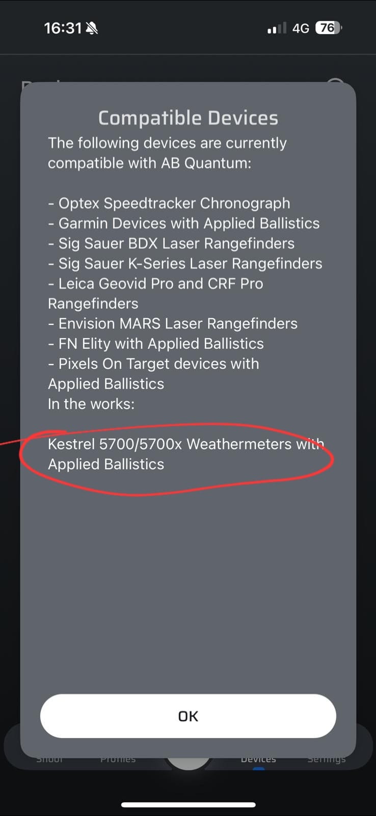

Are we to understand that the 5700 ELITE will not be able to connect with the Quantum?:unsure: Or is it just a matter of time?
I just tried with an iPhone 16 Pro Max to connect a Kestrel 5700 ELITE and the application does not recognize it, does not find it. Instead, I managed to successfully connect a ballistic Garmin Tactix 7 Pro and the status of the application was updated to Elite (y)

All 5700s with AB on them will work. Your app needs to be version 3.2 or newer to be compatible (check your settings page). @adisan77ro
Just got the update on my iPhone and it found the Kestrel with no problem. Not only that, it pushed my rifle profiles TO the Kestrel. Thank you AB for keeping me from having to re-create everything with Kestrel LINK!

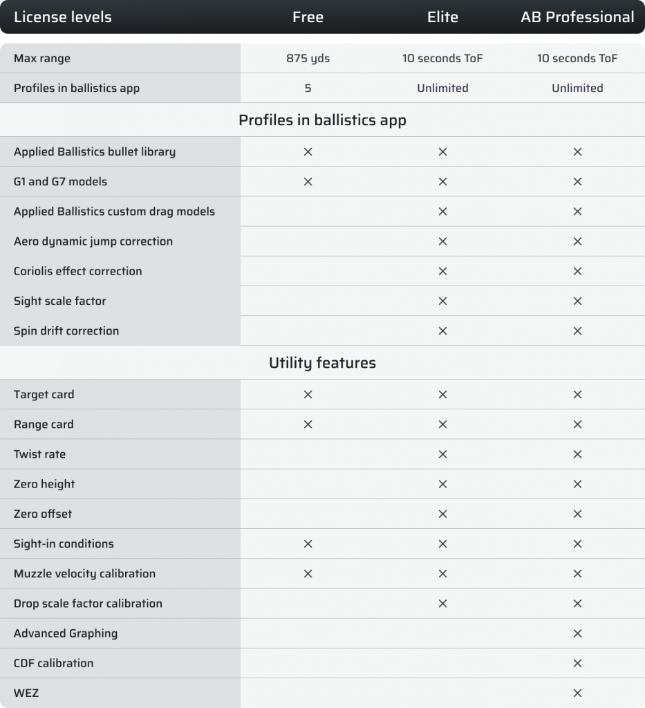

So... I have the app updated to 3.2. Let's say I upgrade to the Professional version. OK. I have a 5700 Sportsman with AB and Link. Does the integration that I will have at that point give me the same results/ features on solving ballistics solutions compared to if my Kestrel was upgraded to the "Elite"?
Yes, it will give you results as if your Kestrel was an Elite. But it will not update the Sportsman to an Elite, and it will not transfer firing solutions to the Kestrel.

Doc I see there is a wez upgrade for the 5700x. If I am happy doing wez on your app, am I losing anything else by not upgrading my 5700x to 5700wez?
You are not losing anything if you upgrade the app itself to Pro and use WEZ there. That is the only change to the software on the 5700X-WEZ. No other new features.

So i just got the update and hooked up with my 5700x , the main feature i found so far is being able to stream the wind and direction ( think kestrel hud ) to the app . Which is really cool i can also update all the enviros off the kestrel so it seems like its intended to be used with a kestrel in a weathervane .
The thing i was hoping for that im not seeing is the ability to type out my target card on the app and just push it to the kestrel . And vice versa . It would be really nice to be able to send your whole target card over and play around with the wind direction while watching your POI / hold shifts on the app to do fast wind brackets .
The third thing is i honestley didnt care about the WEZ feature , but it appears to be paywalled behind a professional tier subscription which is a massive bummer . I thought ab elite was the top tier i own 3 ab elite physical devices and have paid for the old app on android and iphone . To be paywalled out of features now is kinda like wtf man ?
All in all tho neat update i just gotta asses if it makes more sense to run this or just stick with the kesterel because without a way to share target card you kinda gotta pick one of the other

Point 2) This iteration was not intended to introduce target card features from AB Quantum to the Kestrels.
Point 3) WEZ is a Pro Level system. The only Kestrel that will unlock that free is the 5700X-WEZ model.
So if I upgrade my 5700x software to 5700x-Wez software, the Pro subscription is included with that? Thx
Yes, the device will need to be paired to the app every 29 days to retain that access.

Pairing to a wez model kestrel will upgrade to pro license and unlocks WEZ, CDF cal, and graphing?... or just the wez function?
With the upgrade being an option is there anything additional gained by by paying whatever the pro subscription is vs just upgrading or buying a wez model kestrel?

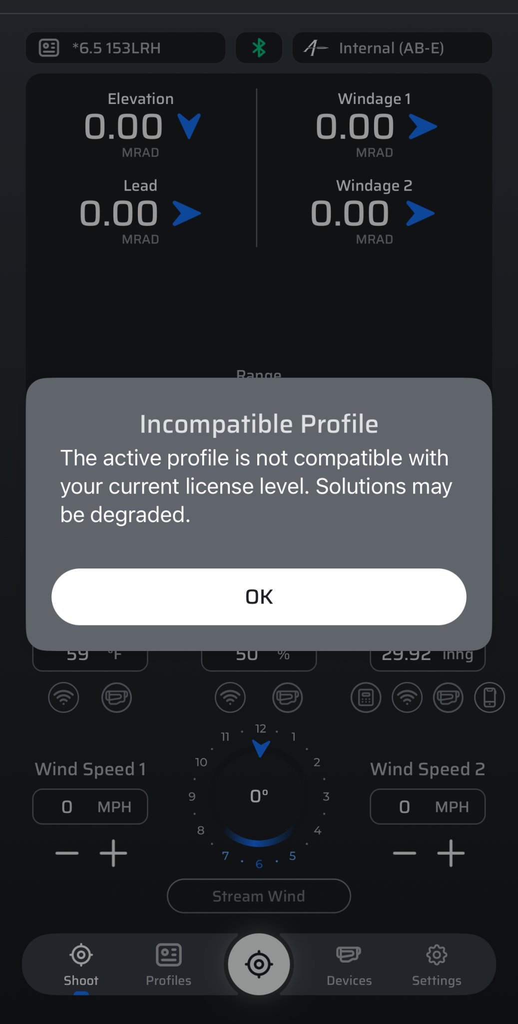

Once I connect my Kestrel Elite with AB I am able to use the Elite features. When I click on Upgrade Subscription (which still says Ultralight subscription level) I only see the options for the professional Subscription.
However, when I don't have my Kestrel actively connected, I'm unable to use any of the Elite features and I'm prompted to upgrade my subscription, which still says Ultralight but now also shows the Elite level subscription options.
This is what I see when I first open the app if I don't have my weather meter connected:

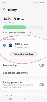

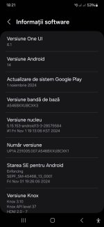

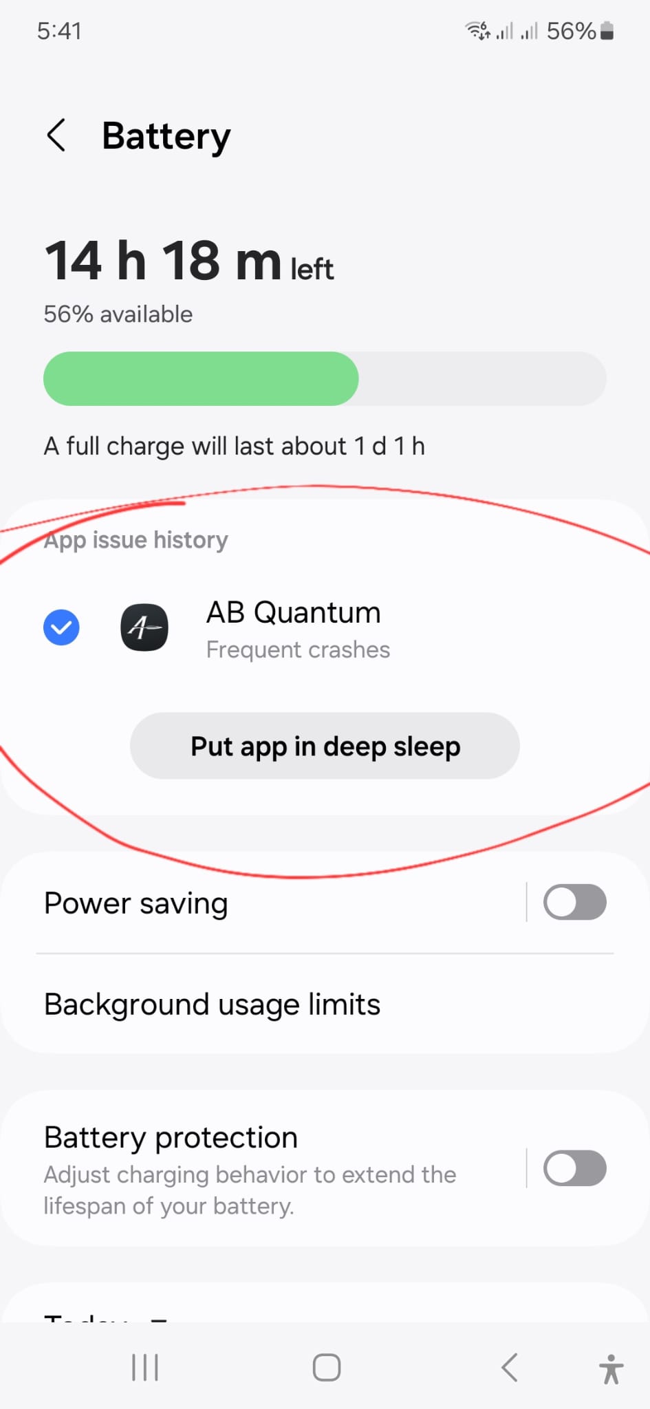

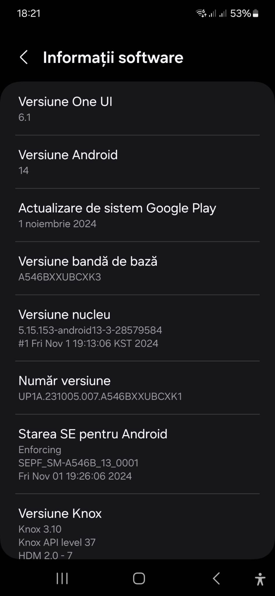

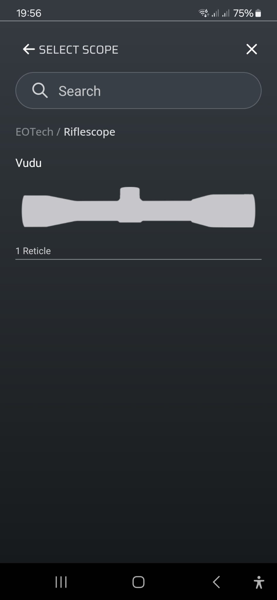

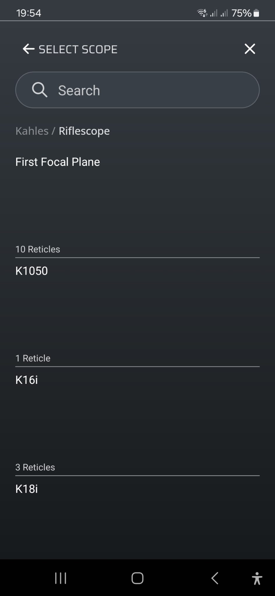

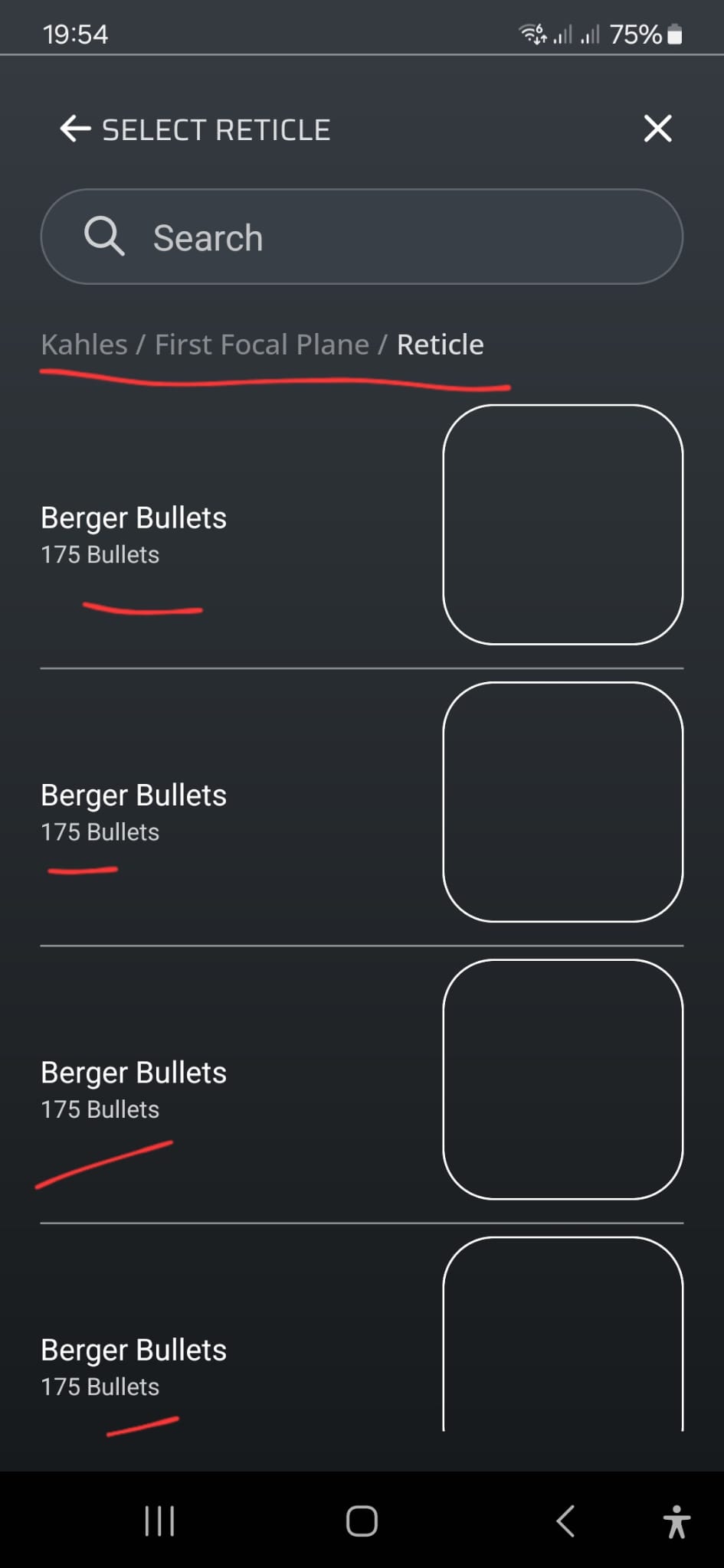

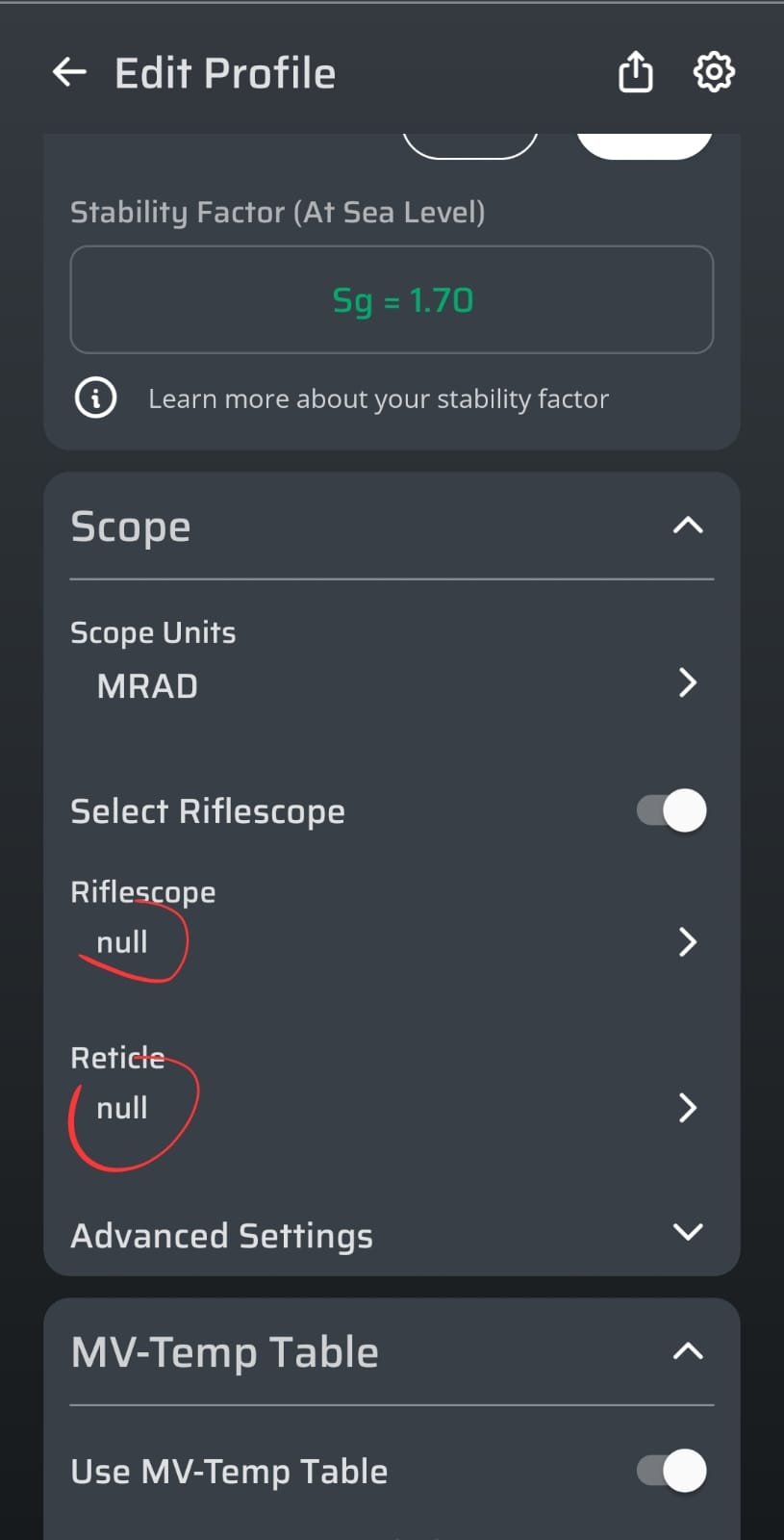

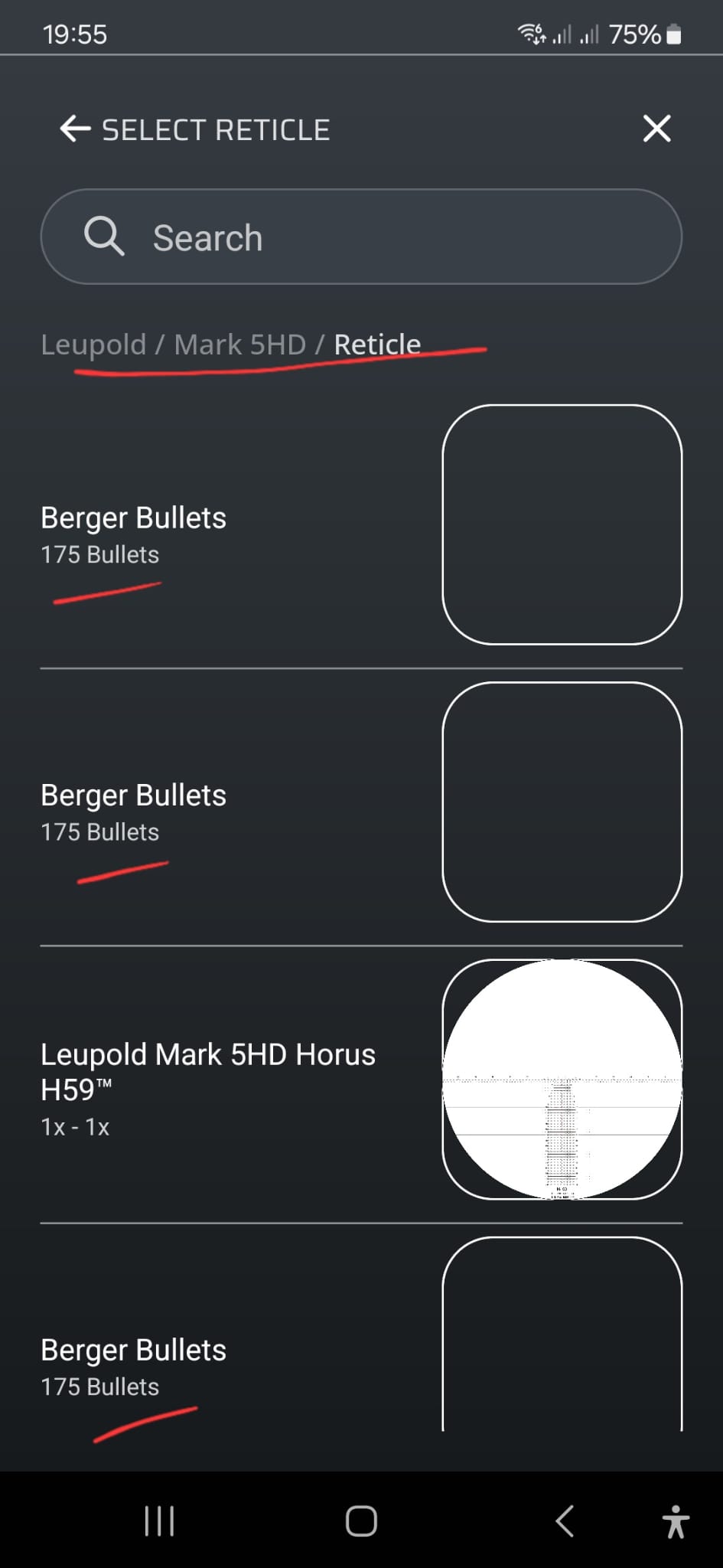

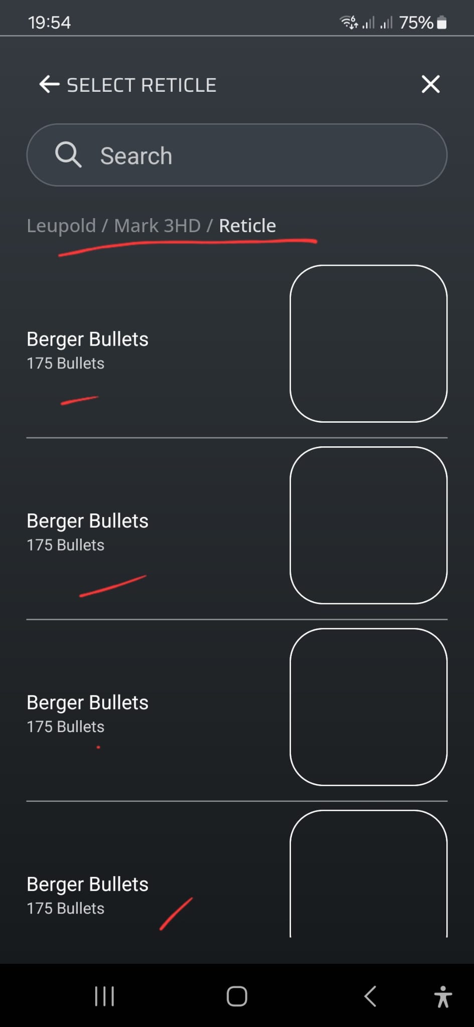

Application blocking problems when trying to synchronize profiles between Kestrel and Quantum, a friend who used a Samsung A34 5G also told me today
In short, the problems observed yesterday and today are as follows:
- App crash when syncing profiles with Kestrel. At Samsung it went for 1 hour without result and at Apple it recognized that there are 7 profiles of which in a few seconds it synchronized 2-3 then it got blocked
- The Export profile function does not work well. The application either closes or jumps to the Shoot page. Only two out of 7 profiles generated that QR code
- Being connected to Kestrel, if you ask to update environmental or target data (Controllers)by pressing the device icon, the app brings some data, but it is not the data from Kestrel (temperature, humidity, pressure / azimut, inclination etc. are totally different from the data in Kestrel), regardless of whether Environmental from Kestrel is set to Live or off
- If you press the "support" icon in the next step, when you press "Continue", the Quantum application gives an error and closes.
P.S. : Yesterday I had version 3.2.0, and today I uninstalled the Qantum application, I reset the phone and reinstalled Quantum with version 3.2.1, (on Samsung) but the problems persist as described above

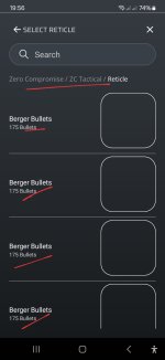

1. When using WEZ and selecting different "Confidence" levels High, Medium, Low or Custom the number that auto populate in the different data points means + or - by whatever the number is given correct?
Example when choosing Medium for Range it auto populates 10 Y so that means the Range error shouldn't be off by any more than 10 Y + or - correct?
Have you ever noticed this situation in the application?

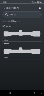

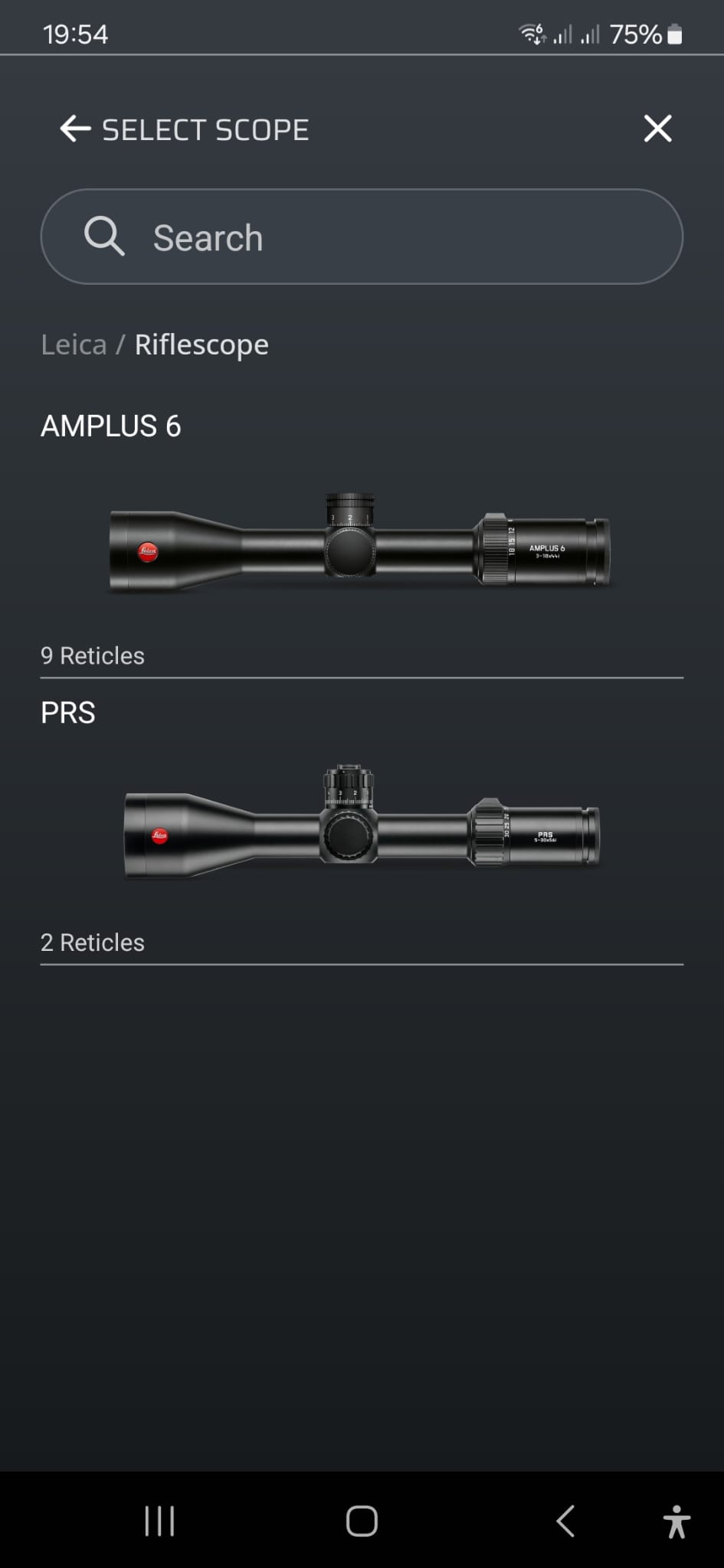

I started to think that there might be some incompatibility with my Samsung A54 phone, but I also installed the application on a Samsung Note 9 and saw that things look the same.
There are a few brands of scopes where the options seem fine, but in the case of the majority things seem mixed with mentions of Berger ammunition. I noticed this when I saw that the settings related to scopes and reticles disappeared from my profiles. Now the mention "null" appears and when I wanted to reset the reticle and scope option, I saw the errors in the attached images.
P.S. Today, I noticed that the live wind and environment data update works during the Kestrel connection. In the target data, only the distance is updated without the fire direction and angle

1) Is your app up to date? Are you on version 3.2.3+ for Android or newer? It appears you are still on an outdated version.
2) Do you have the PIN function turned off on the Kestrel? (This is necessary)
3) Do you have a good battery in place? New?
Kestrel is working as intended in that case.
Those are place holders, it means the data has not been downloaded. That's an indicator for us. It is best to do this over WIFI, as with 700 high quality reticle images it can take a while.
