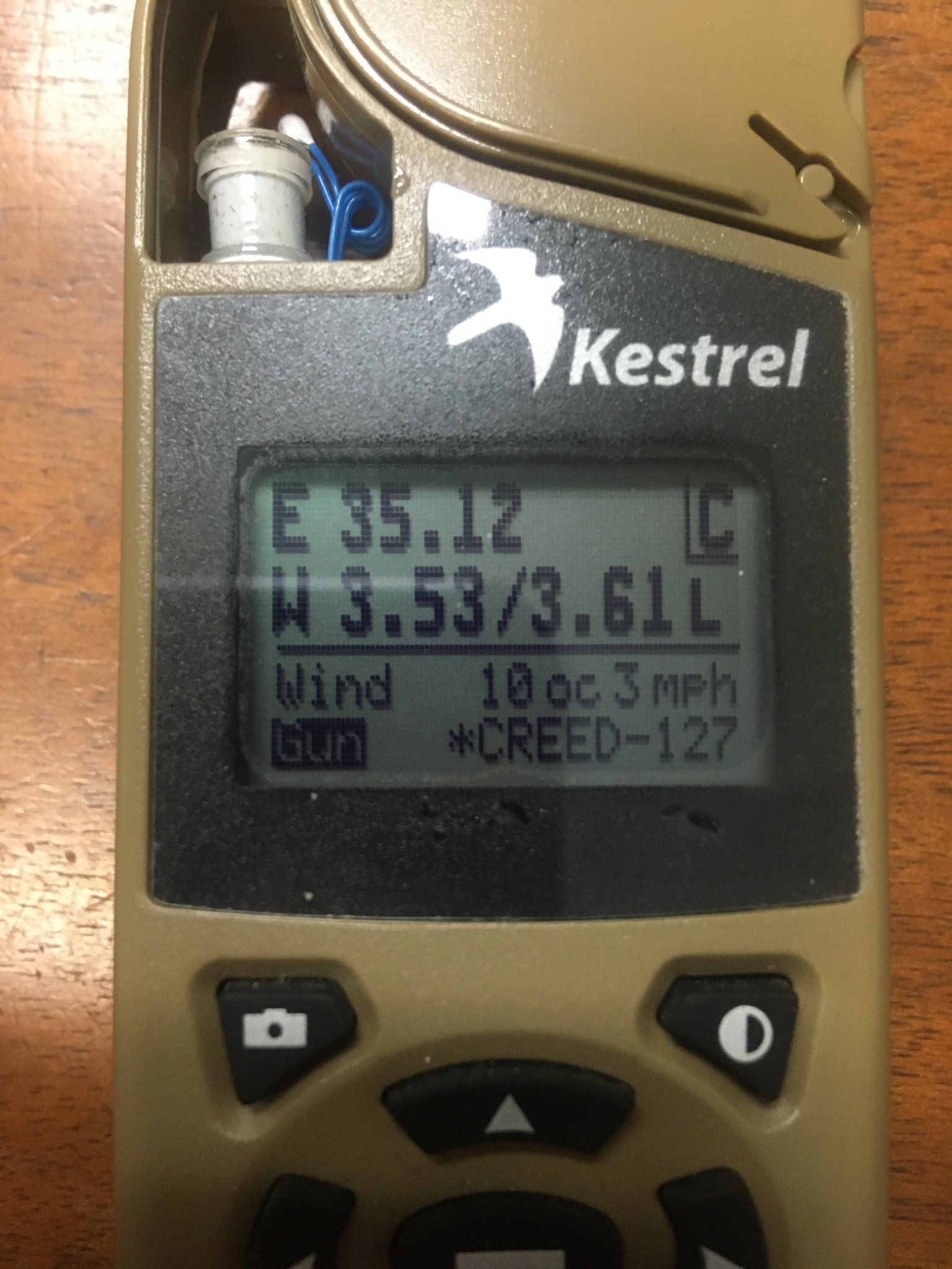

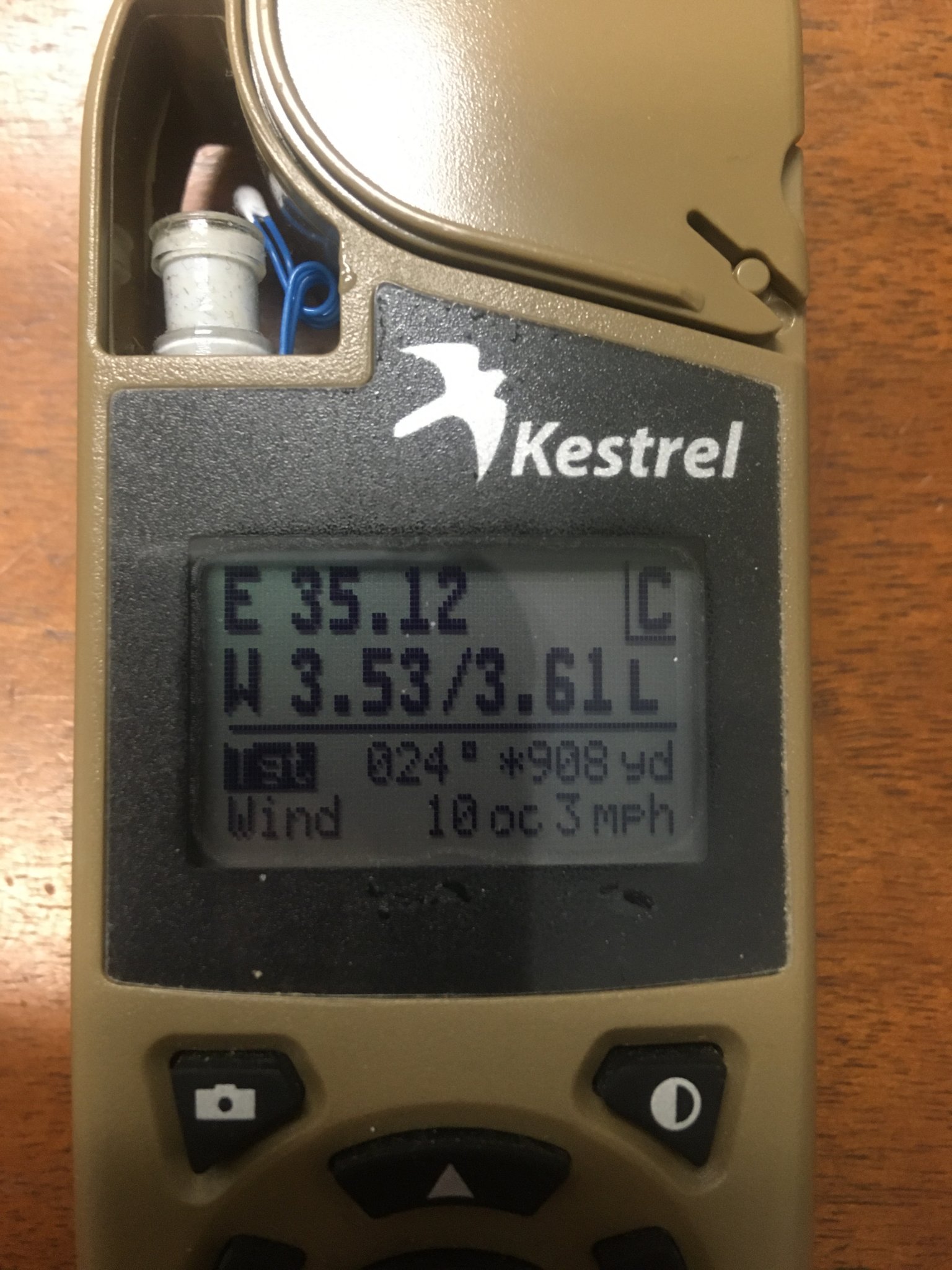

I thought that but it stays from 25-1200 on a 6.5 creedmoor also none of the other targets ABDE do itNever noticed that. Maybe your bullet is going transonic at that distance and the asterisk is indicating that?

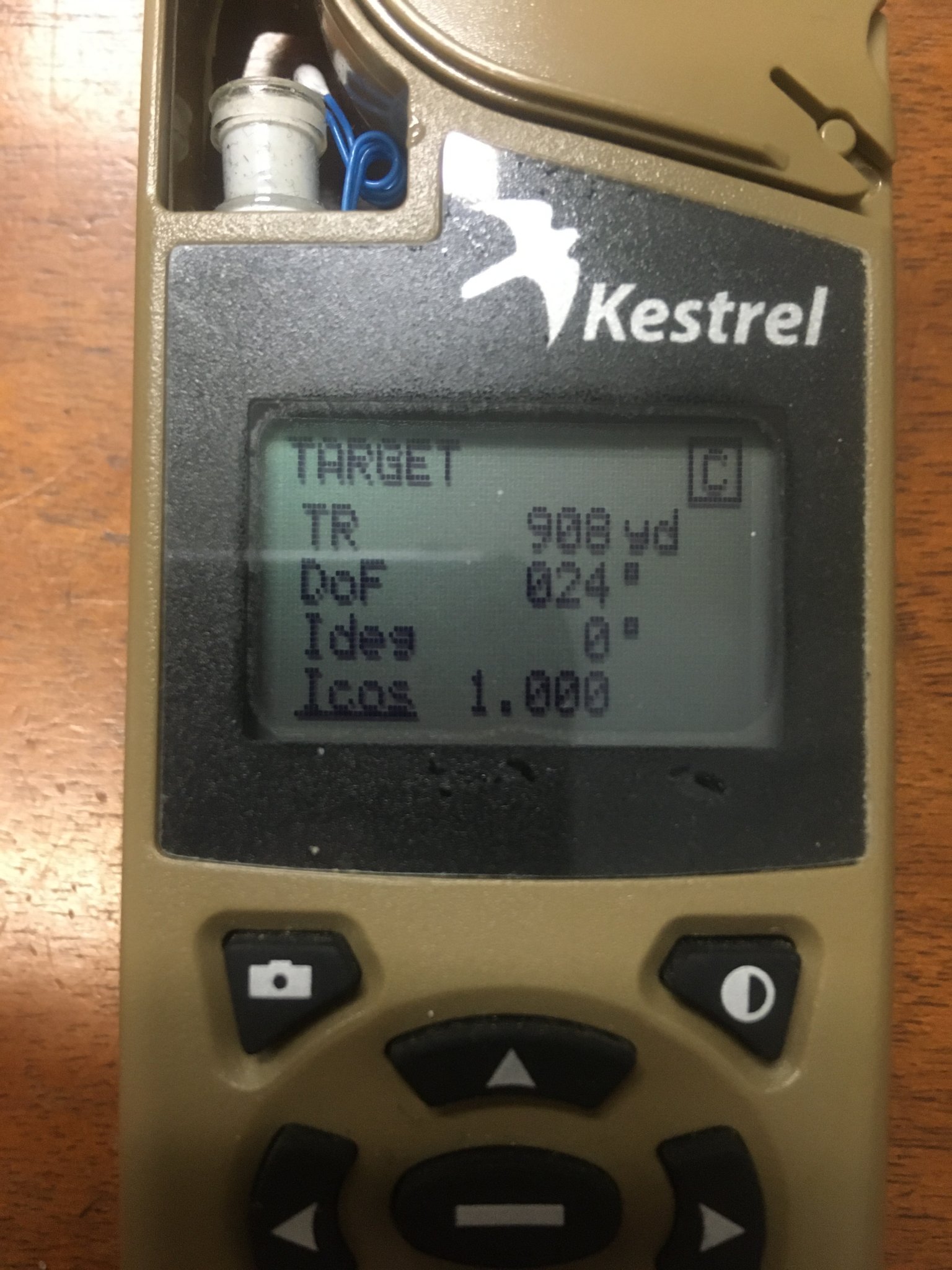

I’ll look at it but I think it’s at 0’You have probably input an inclination to the target.
Zero it back to 0°
Thanks for the reply maybe you can tell me if I’m looking at this incorrectly I’m stumped at this point. Also is it normal to show an asterisk before gun name as well?Yes this signals an inclination angle is being used on that target.

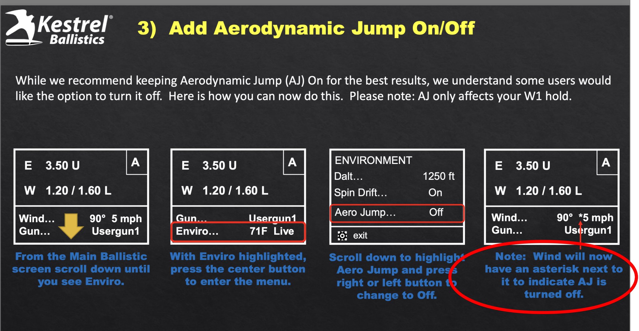

It’s showing version 38The asterisk indicates the profile was created in the Kestrel and not a custom profile created by Applied Ballistics. As for the inclination code showing up with no inclination, can you check your fw version in the About menu and let me know what it is.
Cleared!Try this to clear it. Set ideg to 0.0 then capture the wind and DOF .

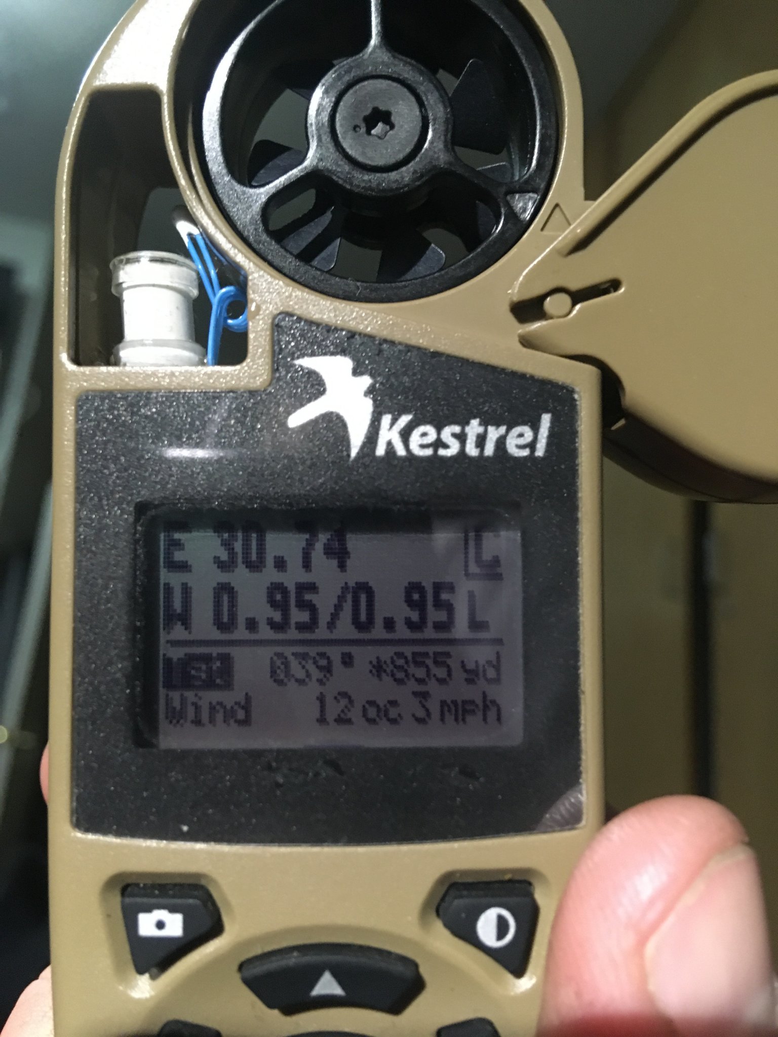

Did you ever get an answer to this? It's happening on my 5700x and I can't figure it out..@Kestrel Ballistics
Can you tell me why does an asterisk appear next to a wind speed entry?
No, but I looked it upDid you ever get an answer to this? It's happening on my 5700x and I can't figure it out..
