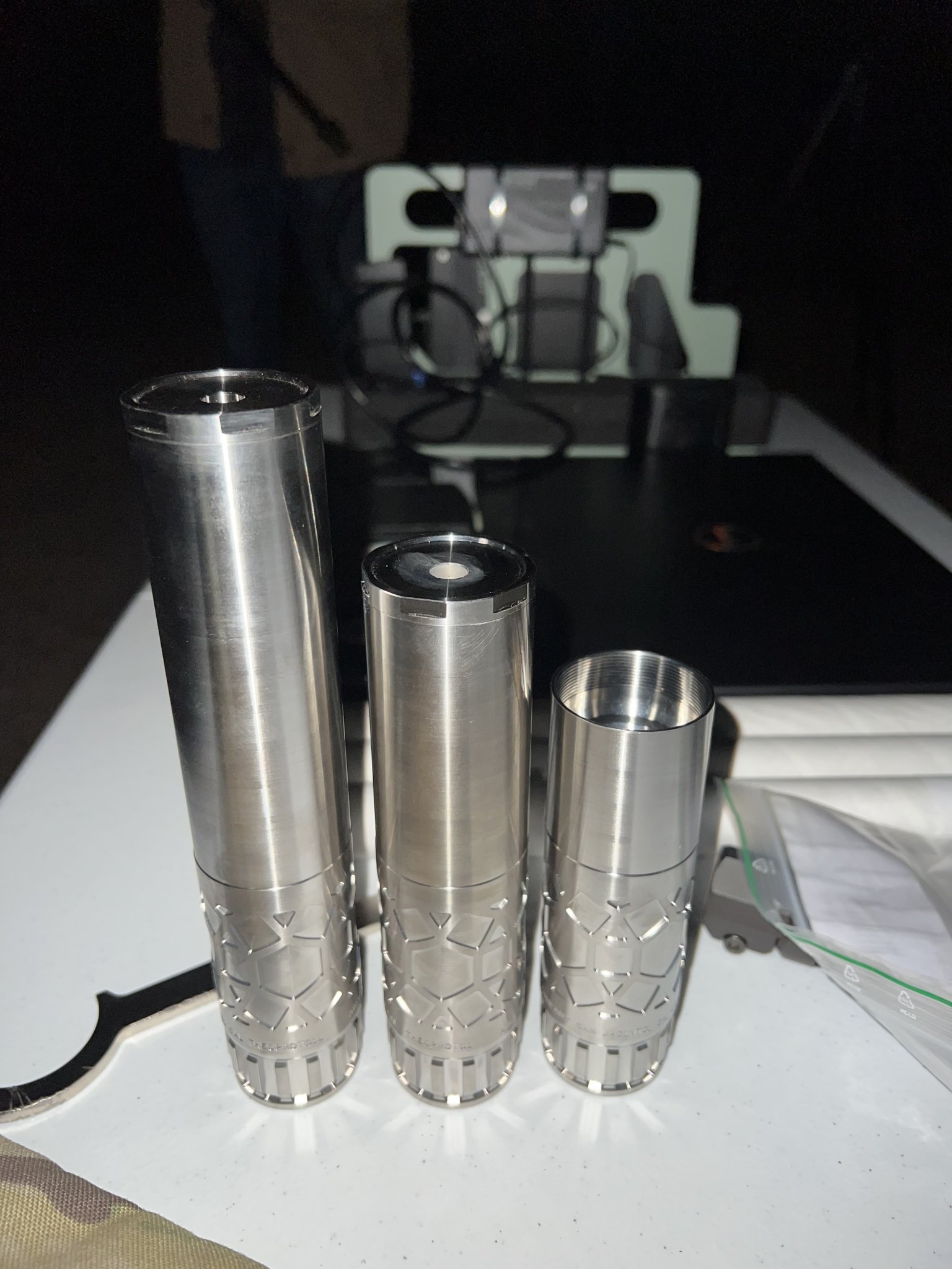

Hey Everyone,
We finally got the laser setup, tested, welds xrayed, production running, website updated and ready to ship!
As always, shoot me a PM for a Snipershide member discount. We are doing an introductory 15% until the end of the year then 10% running through 2023.
Theorems ship with the following:
(1) Closed front end/exit cap
(1) Vented front end/exit cap (for a limited time!)
(1) Multi-tool (for exit cap and mounting adapter)
(1) Mounting Adapter (buyer's choice)
More pics coming…

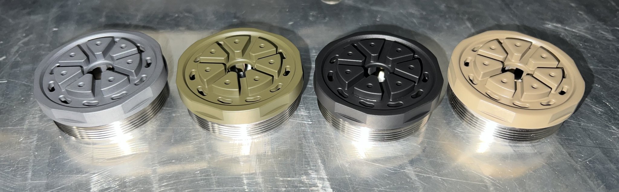

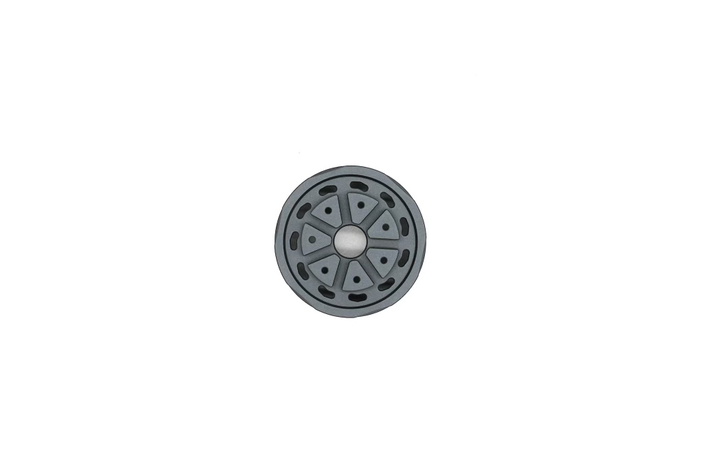

Also, do you have any pictures of your vented end caps?
I went to order one, but didn’t realize the L model was not available….
Reactions: hic28
When will the thorium – L be available?
Website is being updated right now! Check back in an hour or 2.
I don’t have a pic of the vented end cap on my phone and I’m not at the shop to snag a pic. I’ll have some grab a pic
