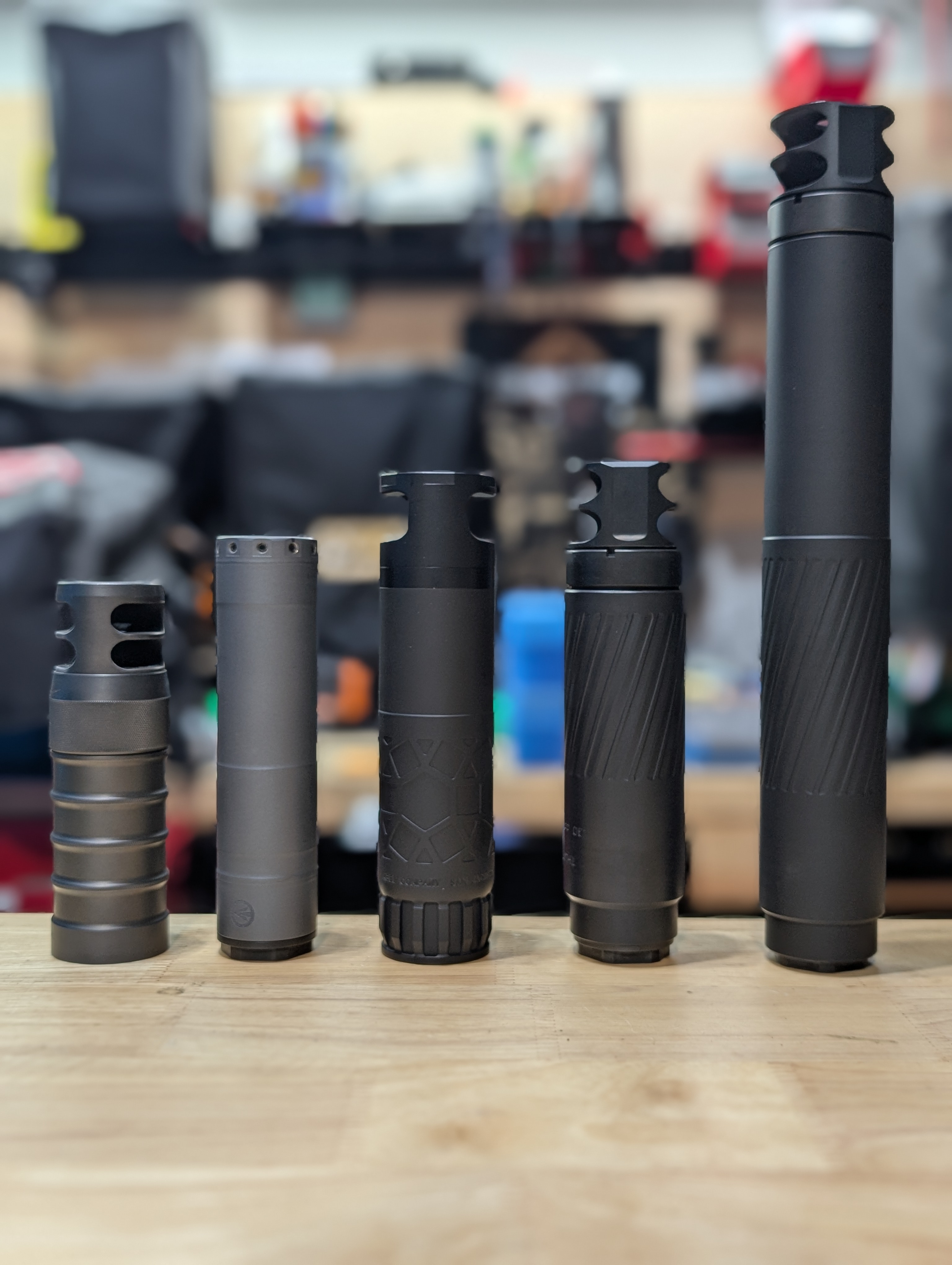

    Cant beat being able to swap the can to cal specific endcaps for max suppression and back to a break for positional shooting.
    They also make a vented cap that works well with gassers.
    I have 4 TBACs and they are great. Abel is right up there in terms of quality.
    Way ahead in terms of bang for your buck tho.

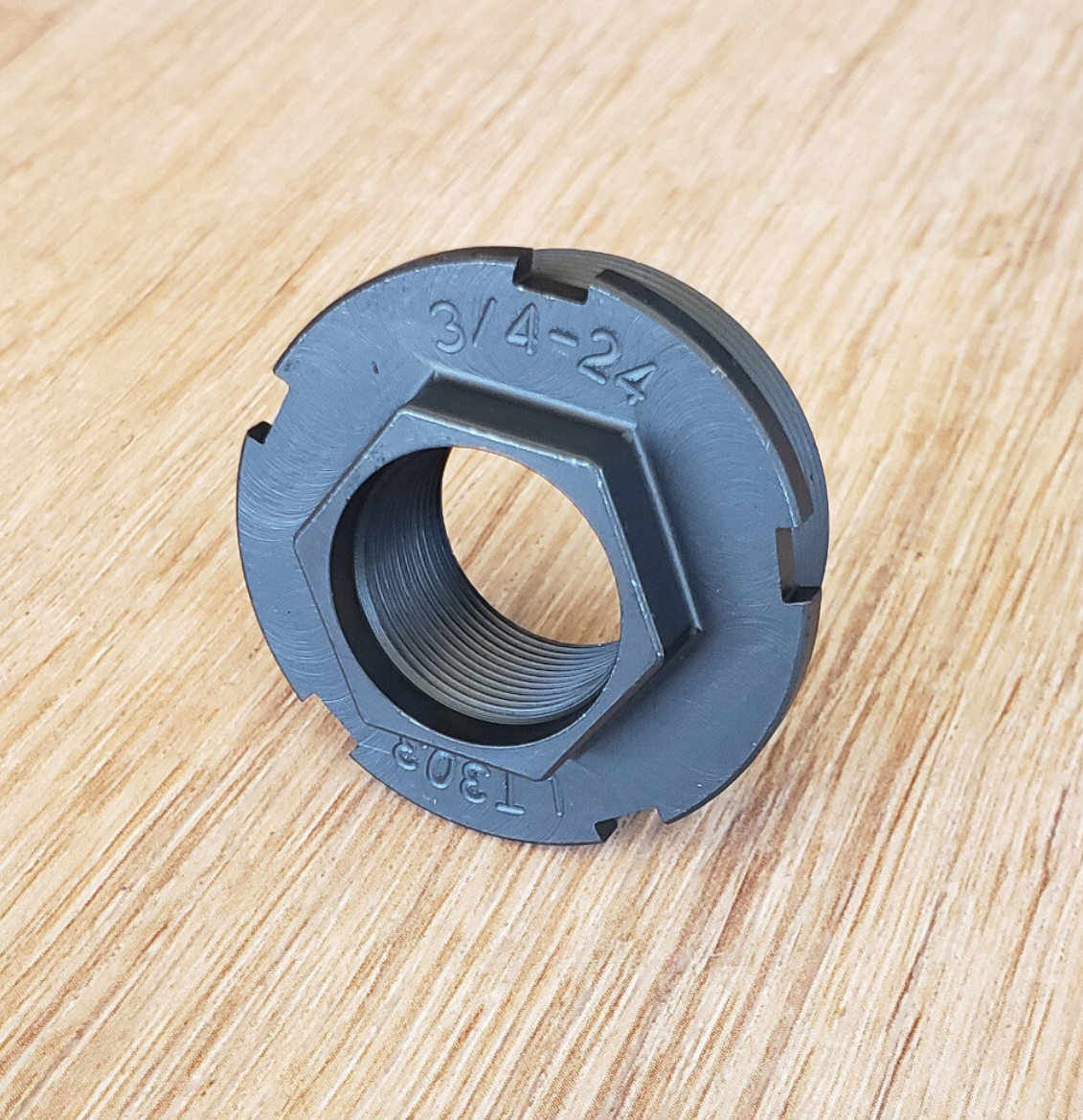

    Any thoughts on direct thread to barrel with the Abel? I’ve never attached a suppressor directly to the barrel. My barrel (Bartlein) was threaded in 3/4” for some reason by the dealer I bought my gun from and Abel told me they are releasing a 3/4” direct thread adapter very soon. Right now they only have 1/2” abhd 5/8”. I’m not sure if it would fit other 3/4” muzzle devices.
    Any hub adapter with a 3/4-24 muzzle end will work with your ABEL can.
    TBAC makes a quality 3/4 hub. You can run that and the Theorem/Biscuit no problem.
    Reactions: kthomas and 021411
    I think you mean 1-3/4" (1.375") x 24 DT adapter...
    I was telling the OP he didn’t have to wait for any Abel branded HUB size mount that accepted 3/4-24 muzzle threads. I guess I should have spelled it out better.
    Edited to clarify even more:
    Get any brand HUB mount (1.375x24) that allows you to direct thread a 3/4-24 muzzle.
    PC: Black Ankle Munitions

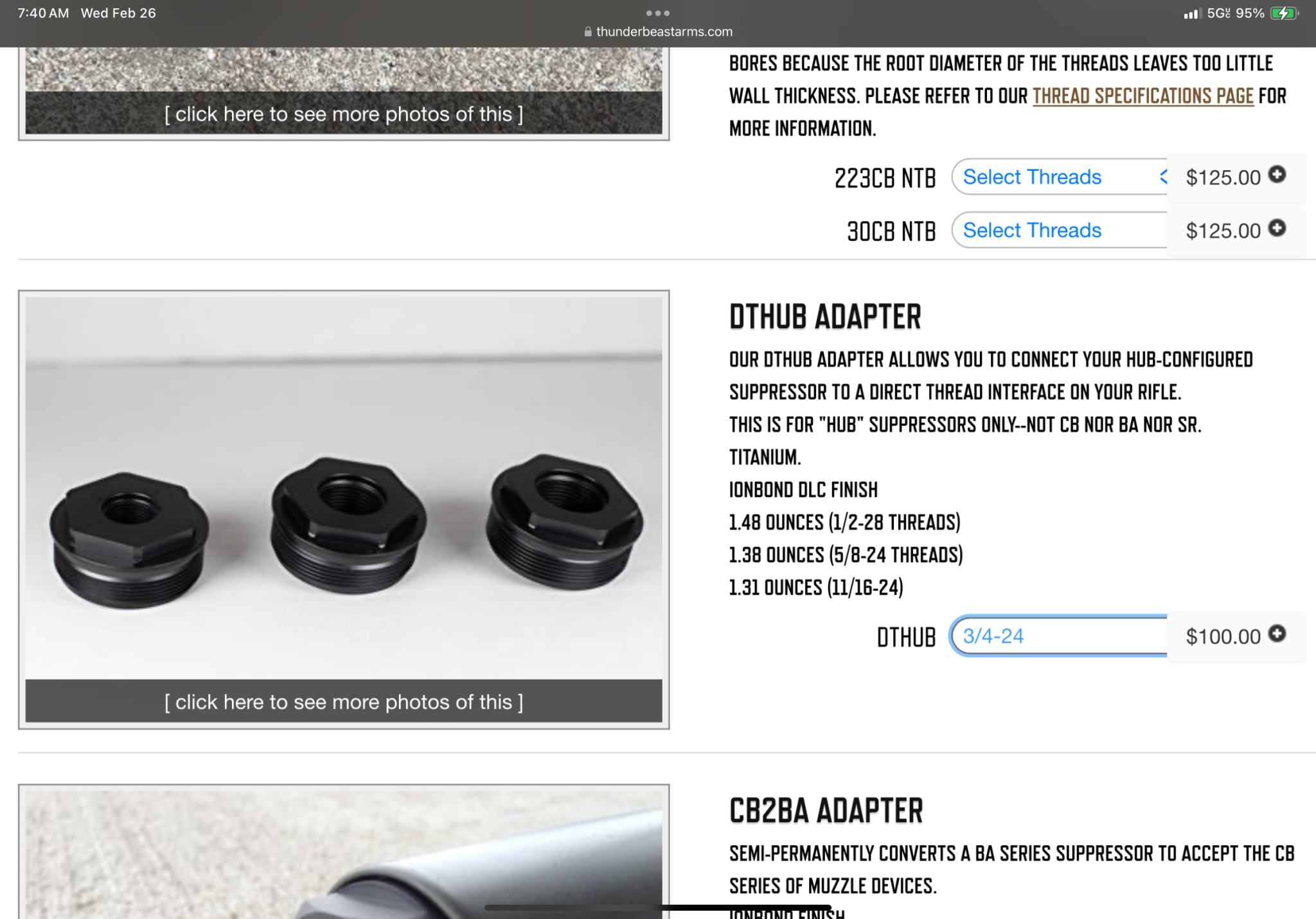

    Thanks, so this will fit the Abel? Abel said theirs should be out very soon but just wanted to confirm this is what I’d need and would fit.

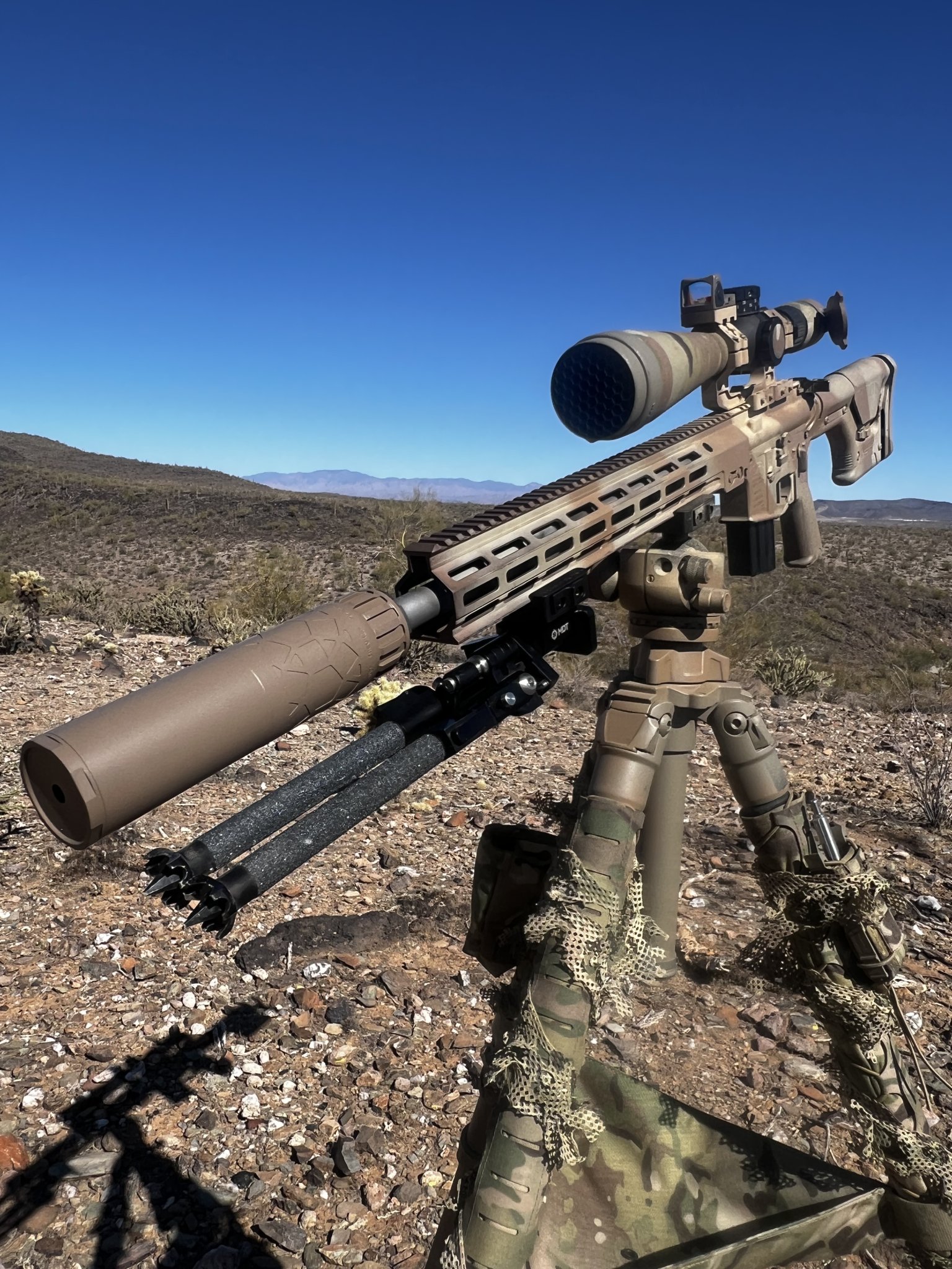

    I direct thread my theorem on my 18” AR.
    Results are awesome 1/2 moa @100.
    Waiting to get my biscuit out of jail.
    Abel’s machining is awesome compared to a couple other high end can manufacturers.
