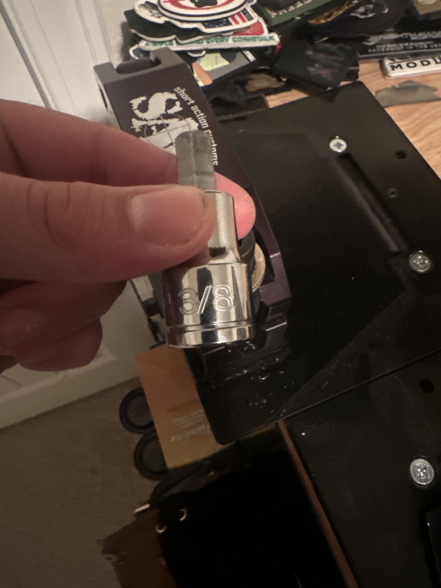

For the big cross bolt that tightens the top and bottom together? That's a 3/8" allen socket. I bought one off Amazon just for it, and it stays in the box with it for when I need it. Also, you're supposed to torque it to 35 ft. lbs. to hold a barrel in place and keep it from slipping. Be sure to use the supplied non-adhesive drywall tape around your barrel shanks. It works like rosin, but without the mess, and it will protect your finish.
Sunex 3/8" Allen Socket

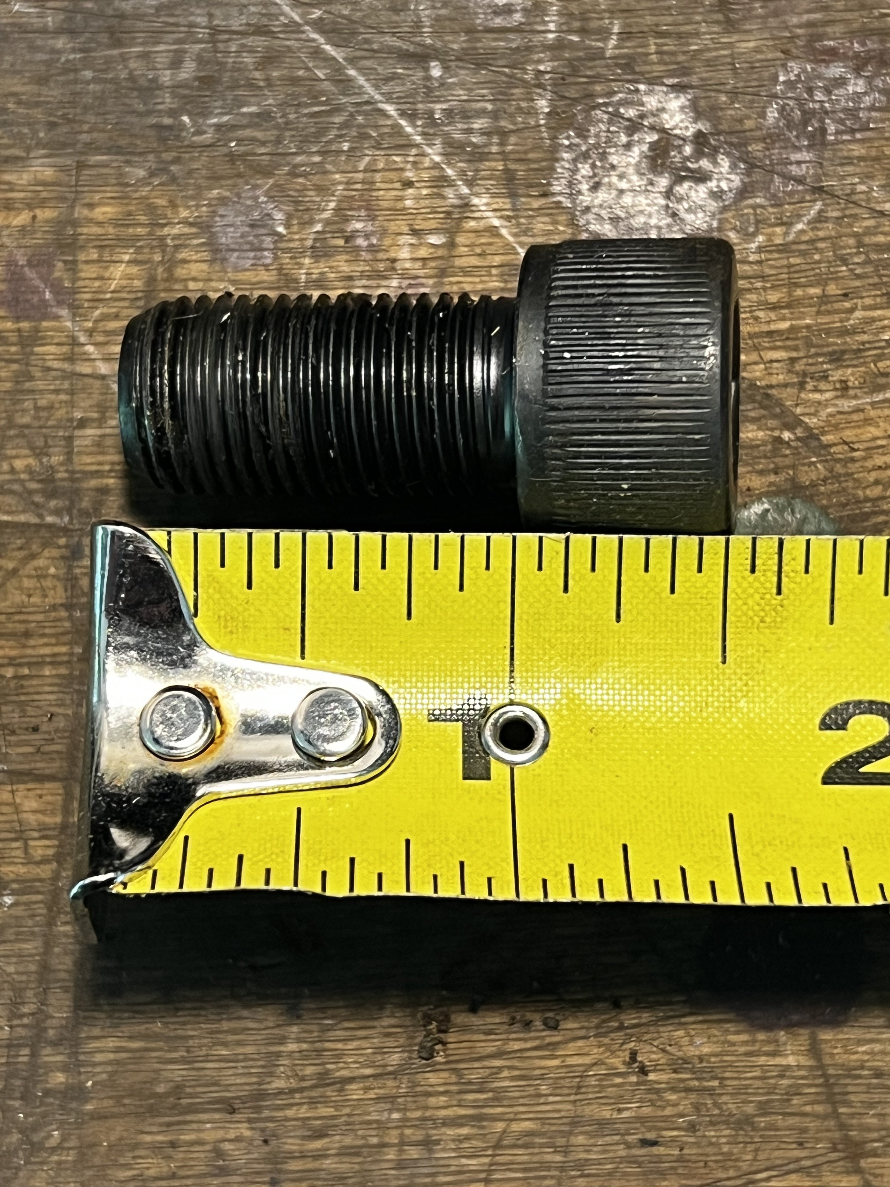

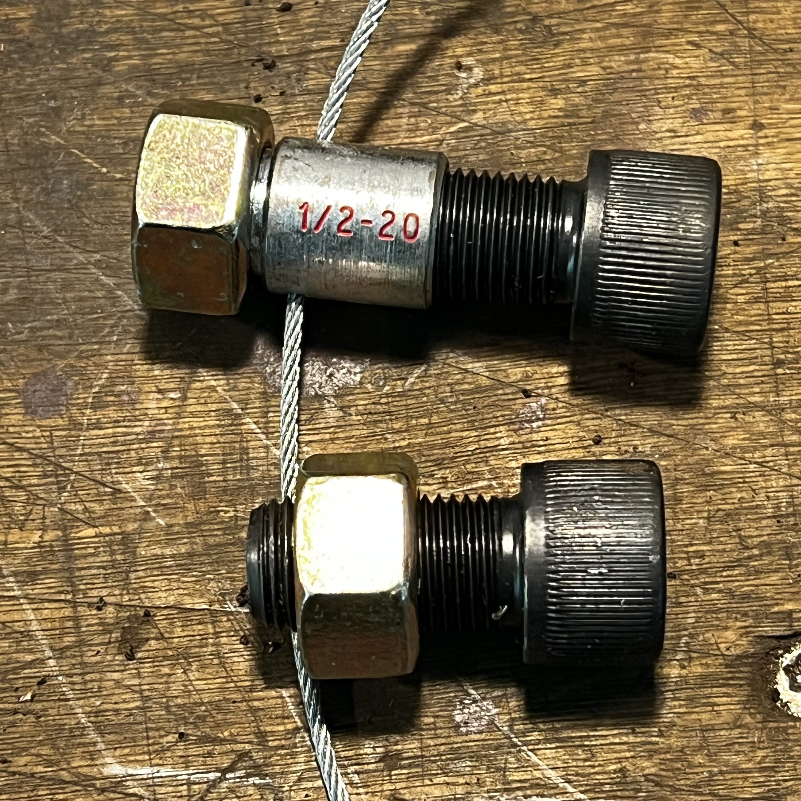

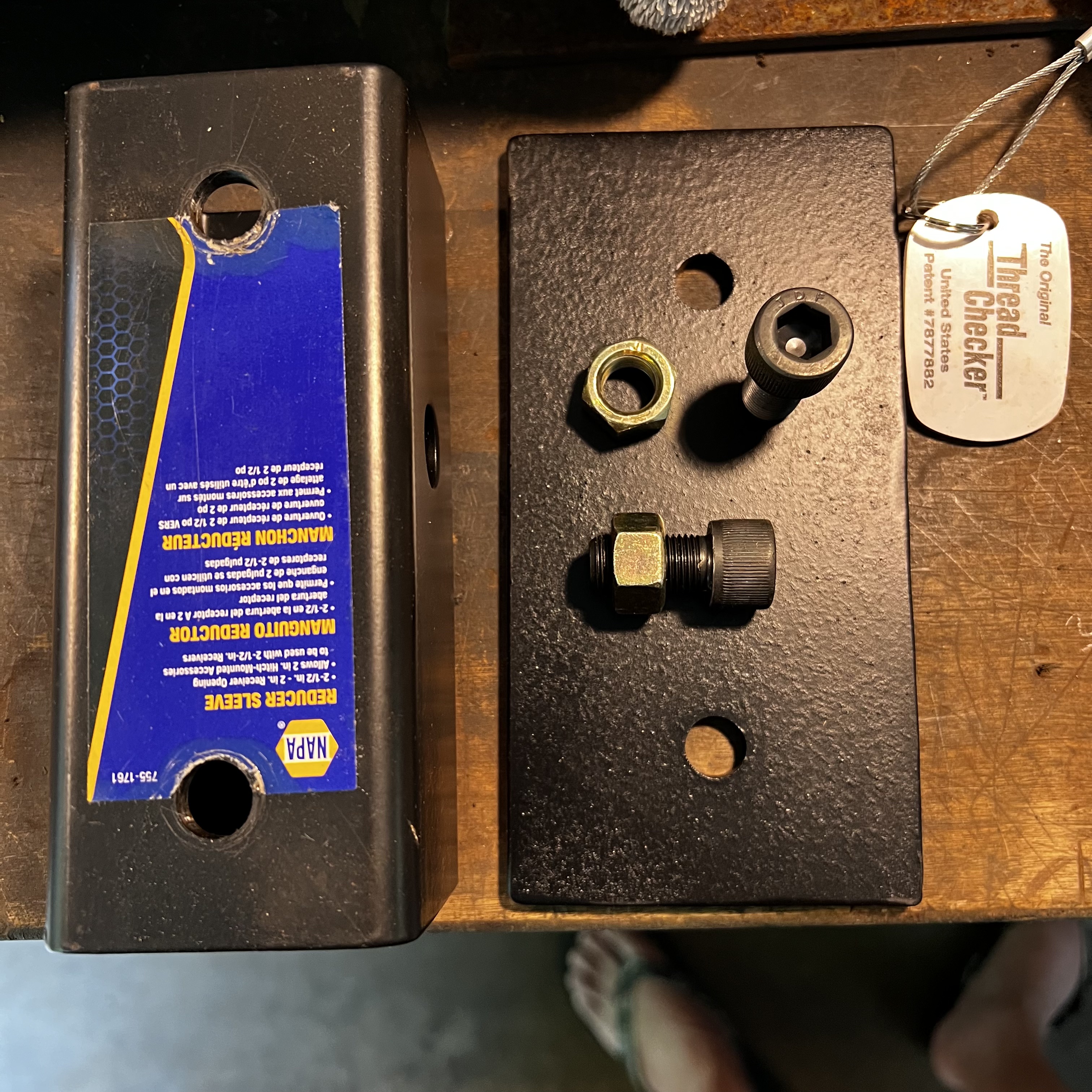

Thanks. So it supposed to have nuts and screws for ARCA base installation in the package?

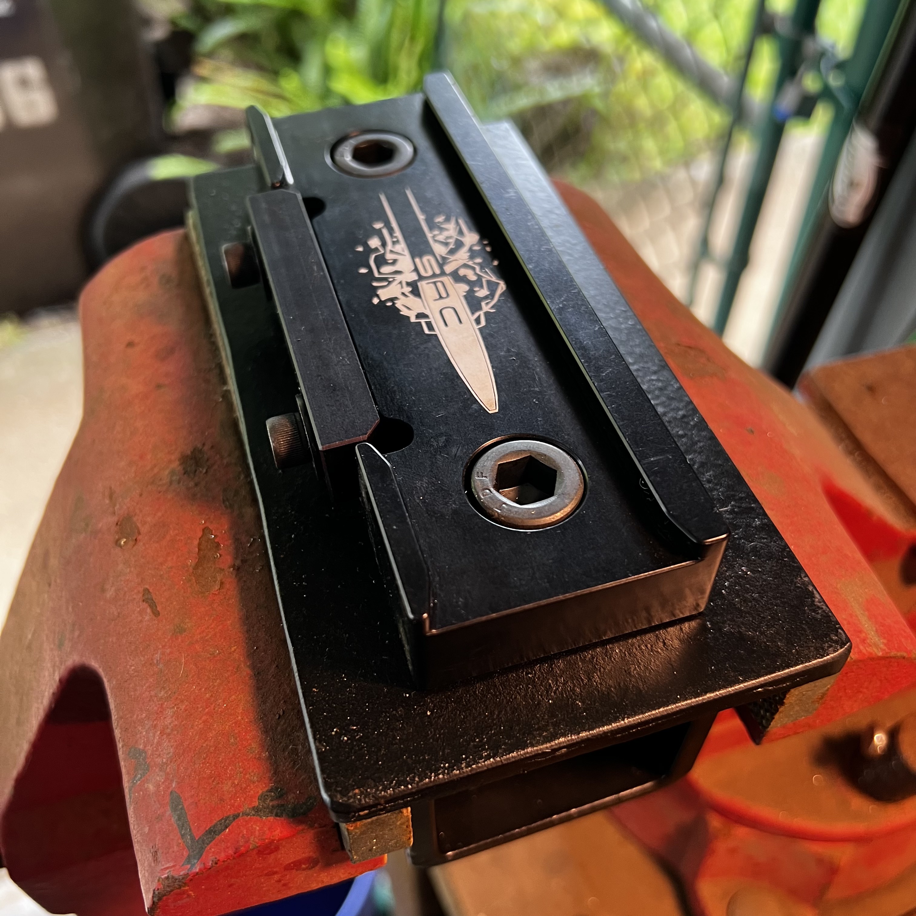

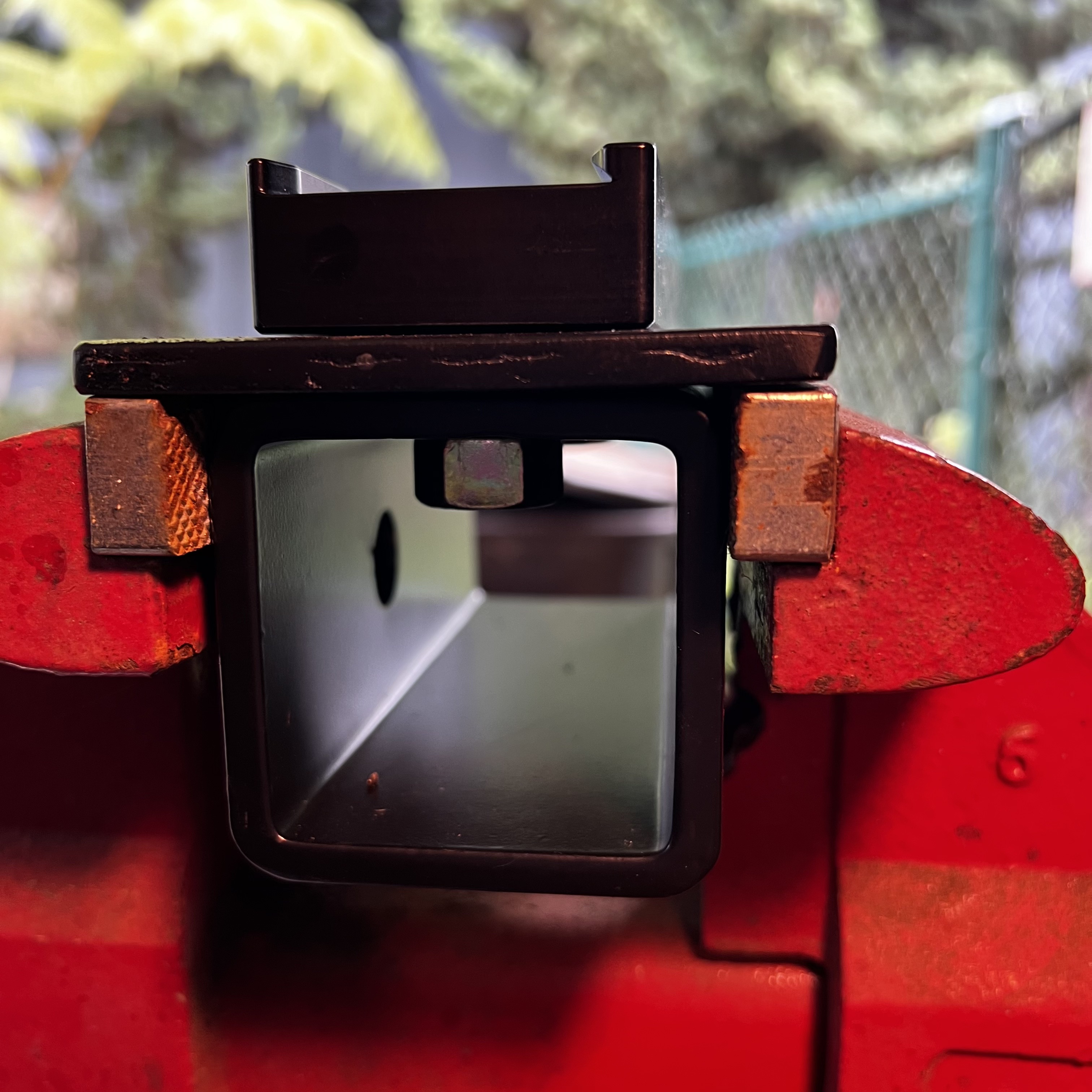

I use mine differently and mount on my vise and remove it when not in use, so I don't use the bench mounting plate, but I don't think it came with mounting bolts and nuts for that. I'd probably still contact them and find out what type, diameter, etc... they recommend.
3/8 for torque. I have to use a conversion from my 1/2 drive
