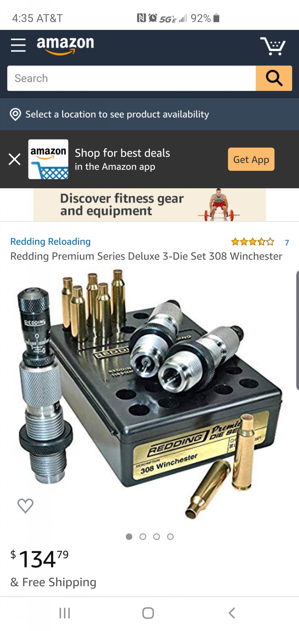

Anyone have an opinion on this die set?
Redding is just fine too but getting into reloading with a bushing neck sizer and body die, etc can all just be confusing and risk not making quality ammo.

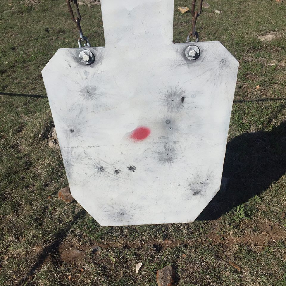

If you're consistently able to cover a 5 shot group from your 308 with a dime, you're already shooting in the 3's. Skip reloading altogether and buy more of that ammo...

I can fully recommend that Redding Premium die set you're looking at, I've only used Redding dies. I started using the Deluxe set that comes with the 3rd neck sizing die, though just because that was what was sold to me when I first started reloading. The only issue I ever had with them was on the seating die, I found it quite difficult to achieve a consistent seating depth, which was frustrating as I was loading for a target .300 Win Mag. I never used the neck sizing die, so I when I began loading .308, I went for this Premium set you're looking at now, especially because I also wanted to try out the micrometer seating die. Though as others have stated above, if you're only loading out of necessity rather than for the best precision, and you're only shooting a standard rifle without any kind of special chamber, either would be just fine, just go with whatever's cheapest. But if you are looking for greater precision, I'd recommend the Premium set.

Does Redding make a FL sizing die? Or would you recommend a body die, neck die and a seating die? I plan on getting a micrometer seating die.

Yes they make a full length sizing die. You dont need to split sizing into two steps unless you want to pull the press handle twice as many times.
I use their FL sizing competition sizing die. I anneal and am less worried about over working brass than rounds than won’t chamber or pulling a press handle twice.
These are tighter than other dies - Hornady One Shot lube didn’t work well for me in these, I now use Redding’s imperial wax.

Things like micro adjustable seating dies, hany if you load different bullets a lot the Lee is not as fast to set but works fine.
Dies for adjustable neck tension with the collects nice but for later lessons as I see it. I just remove material from the expander stem on the lee.
Some of the better dies may give better concentricity.
They are normally polished more inside ect.
I certainly won't argue best with anyone but a Lee set is functional and good to learn on. Many valid points on all the posts.
One thing I did not remember seeing was to make sure and get a universal decap die, that way you can clean brass and pocket before running in sizing die keeps things clean and less chance on damage.
It's a lot of satisfaction making a good load.
I will look into the lee dies. I like the idea of buying the dies I need based on quality and recommendation as stated in previouse comments. I understand that probably isnt the best or most effective way for a beginner to go about it. I've done a tone of research and understand the fundamentals of reloading although there are some details I still need to read up on.
My main concern is the quality of the load. I want to shoot for accurace and good conentricty in my loads. I'm just running a Remington 5R milspec gen 1. Its pretty new but I'm getting GREAT groups with it. I just want to make sure I but right products to achieve my goal which us quality, accurate ammo.
I do appreciate all this info. This gives me allot to dive into. I love this stuff.
What I would like to try and do is kind of start by recreating the round that I know works very well in my Remington right now which is the Federal Gold Medal Match Sieraa Match King 167grn. Not sure if it's entirely possible because I am new to this but if it is I feel that's a good jumping off point if I start with new shells, bullets, primers and powder. I've already looked into different powders for that load and I can get thos bullets from the local add pro.
Use Hornady bullets. They are as good if not better, higher BC, and cheaper. 178 hpbt/Match/ELD-X are all great choices.
