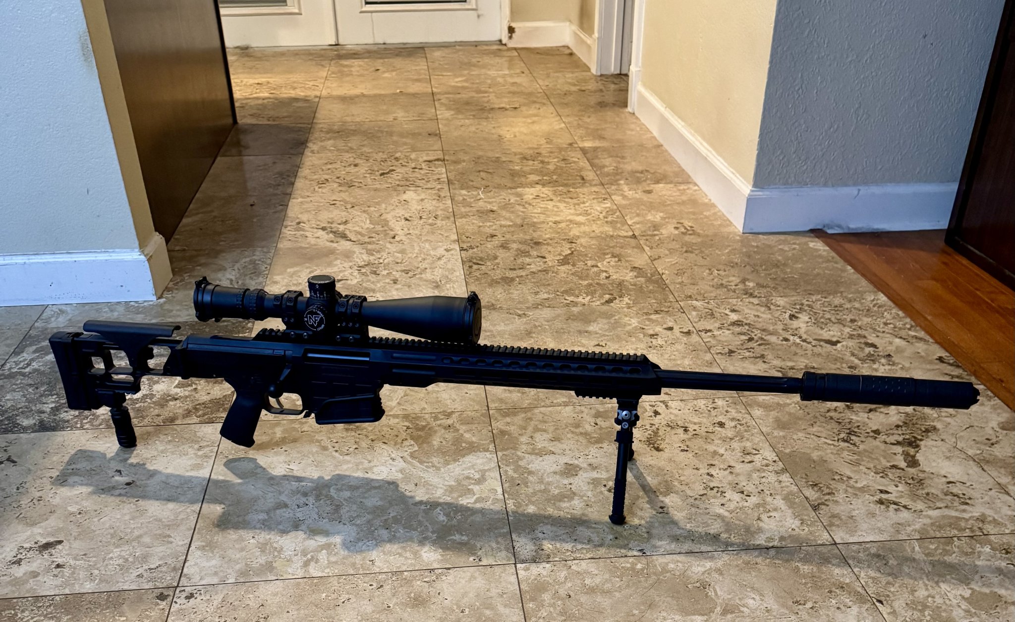

I originally considered the Kiji, but read it maxes out at 400 yards while the D2 will illuminate out to 1k. Any other options? Rather not spend $3200 on a MAWL but will of if I have to
I agree, it looks like 9 and 3 would likely interfere with the PVS30. The 338 is a 26” barrel (pic is with the 24” 308 barrel) and the Hybrid 46 is roughly 8” long. I wouldn’t be doing quick follow-ups, but do you think it could still present a problem with a diving board mounted D2? This would be the main host for the PVS30.
