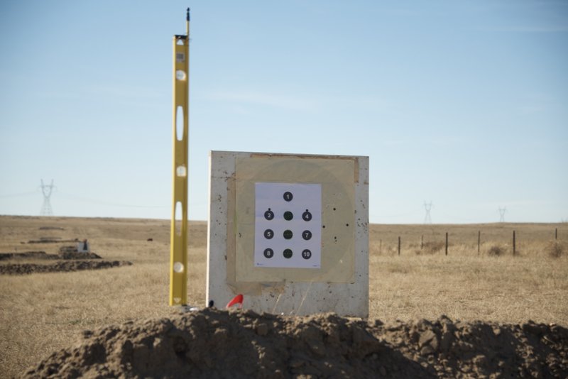

Here is a great way to test a scope and not have to get something crazy...
Put a 4ft level at exactly 100 yards, you can then bag the rifle in or use a sled style mount to hold it in place. Once you have it bagged in, place the reticle at the top of the level, and dial the scope UP. the reticle will move down the level and you can gauge the mounting and tracking making sure it follows the level straight, then, when it reaches the bottom count the number of clicks it took to move 4ft ...
Should be about 133 click with a mil scope or 13.3 mils ... or 45.6 MOA if you have a true MOA scope
That's a test I've never heard of, thanks Frank! To the OP, buy the best optic you can afford and dial away. All optics can fail eventually, no matter what brand or price point (ask me how I know). Keep good data, run tracking tests periodically, etc... and you'll know when it's not performing as it should.
I do basically what Frank is talking about but I use a big piece of cardboard attached to pallet or a piece of plywood and I measure mil marks or moa mark and put dots. I put marks for elevation and windage then I mount it perfectly level at 100 yds and double check that all the marks are level.
I measure the 100yds with a tape measure and then check with laser rangefinder. Then put rifle in a vice and dial away and make sure every mark lines up. I've also shot the target like this as well just hold on the bottom make, dial up and every shot should hit the dots.
mabye over kill and a little more work than franks method but gives me piece of mind everything is lining up.
