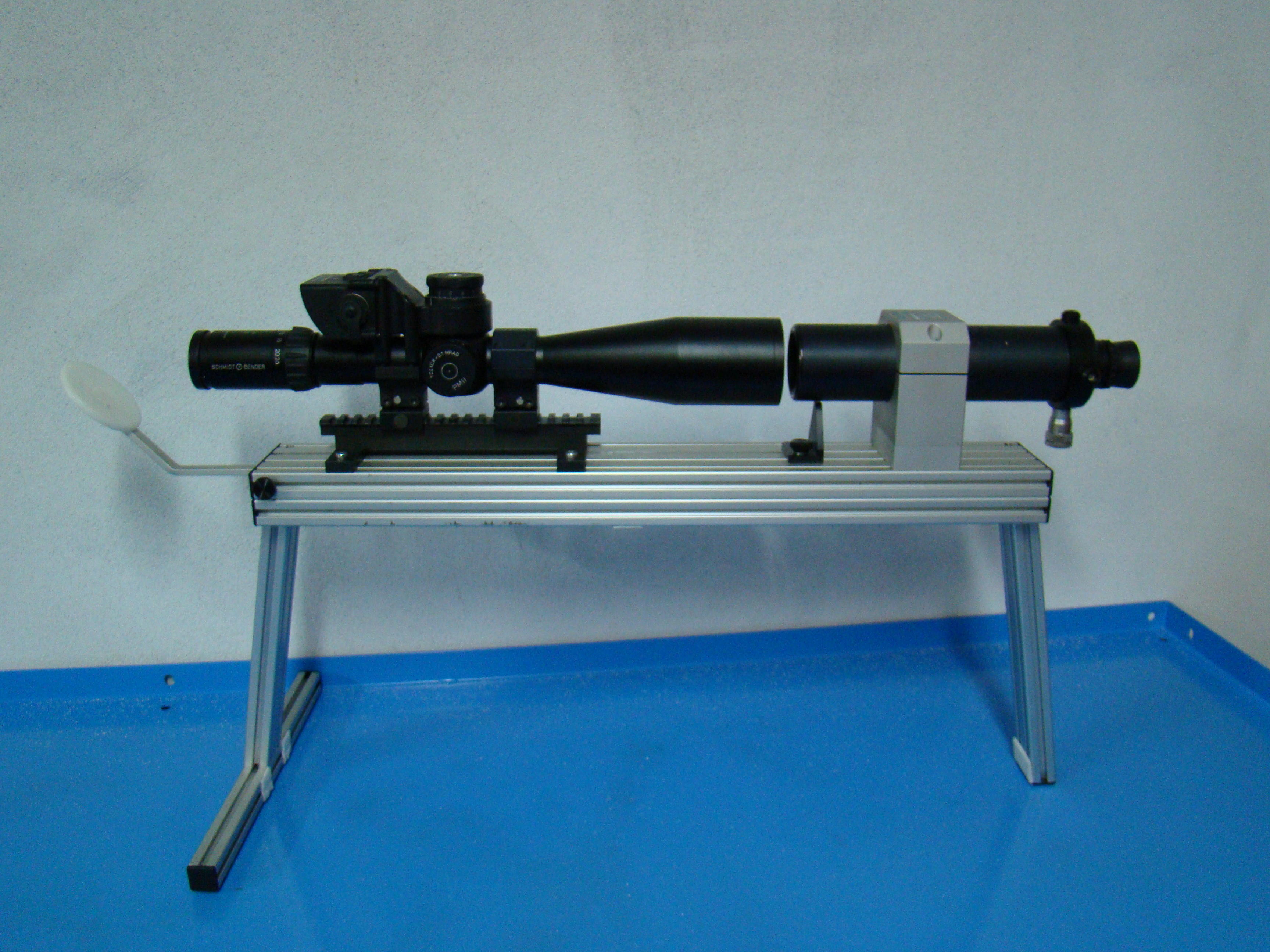

In our workshop we test the tracking and actual clicks value of our customers' scopes, through an Hensoldt/Zeiss optic device (see the picture); it's a really accurate instrument.
After more than ten years of tests, I can tell you that we never saw an error of more than 0.1mil, with a single top brand only, that's Nightforce. With other top brand scopes, along with exemplars with almost zero error, we found sometime errors from 0.3 to 1.2mil (3% to 12%!!), along a 10mil travel, compared to the nominal value (0.1mil)
