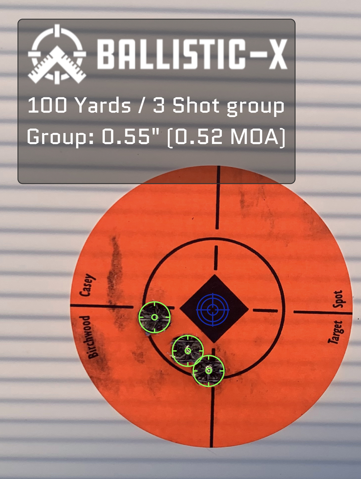

Here is one of my rifles. I zero’d after putting about 10 rounds on the barrel. Just used 30gr of varget and I have a tuner that hasn’t been adjusted since before barrel speed up and such.
This is with 200+ rounds. Mostly all barricade and off rocks for practice. Some tank traps. In the floorboard of back seat of truck *without* a case. So it’s been tossed around and bounced around a couple weeks.
I wouldn’t have an issue shooting a match with this zero still. Might make a mental note if there is a 100yd paper stage at dots, that’s about it. If I take it out again in a week and it’s about the same, I’ll adjust up .1. Maybe right .1, but probably just the up. Sun is also in my face pretty bad. So I wouldn’t mess with it just from this sample.
