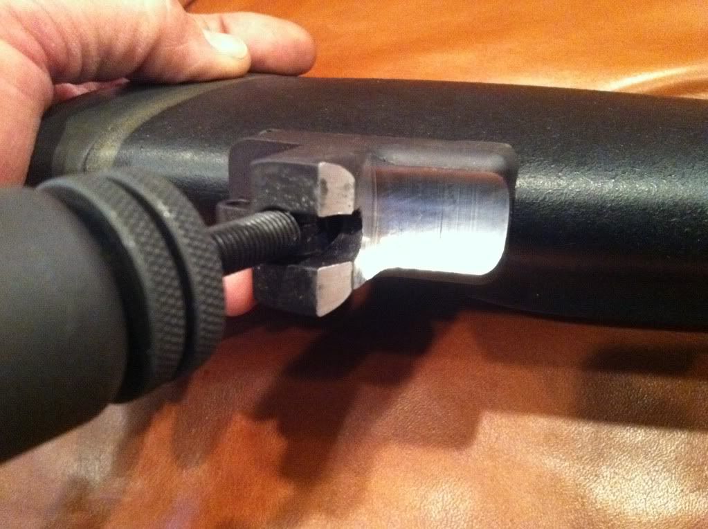

For target use I like mine. However I improved it by milling a flat at 45* from deployed to stowed to allow it to be used for lower bipod heights. Before I had to run my atlas at the third notch for level use, now I can get allot lower.
IMHO, b+t should make them this way anyway.

Here are some pictures of what I did to mine. It allows me now to have my atlas bipod on the lowest setting and have the rifle level or firing slightly up hill.
The next one we modified we got allot more drastic and machined more of the base to allow the monopod to tuck up tighter to the stock. This model was the lowest height quick adjust available.

I'm not really worried too much about raising the barrel. If I lower my monopod all the way and still need to bring the barrel up. I can always extend the bipod legs a notch.
I do like the flexibility that your modification allows. My only concern would be possibly bending that adjustment bolt. It doesn't look like too heavy duty of a bolt.

Jeepocabra, We actually did that modification in prototype (1999) and found that by doing so neither the stowed or 45 position would hold, meaning that even with the thumb-nut tight to the stock collar one could force the leg out of that position. And if we reduced the 45 flat area, to insure the stowed position would hold, the 45 would not. Is your experience different?
Re: Accu-Shot Monopod ...... Love Em?? Hate Em??
Kasey, my experience is different, in both stowed and 45* positions the pod is locked down well. I can apply allot of pressure to mine in both directions without it being forced out of position. That said, we got somewhat lucky when we did mine, the next one required more work. I should also mention that while I am calling it a 45* angle, it is less than that when compared to the stowage flat.
On the second one we milled like this, the stowed position would not hold after milling the 45*. Se we got drastic and machined the stow flat at a more aggressive angel as well as removing some of the base thickness to allow the stowed position to run parallel to the mounting angle. I'll try and get pics later to better show what we did.

Here are some pics of the second one we did. This one did not hold as well as the first until we made small counter sink in the stock for the sling stud to sit slightly further into. by doing so we effectively move the monopod mounting closer to the stock, altering the angle at witch the erector body of the monopod "exits" the mounting body.
You can see from the pictures that there is a slight bit of hard anodizing left towards the top edge of the stow flat, what we did is increase this cut back and leave the top alone to allow the stowed position to tuck up farther.
This second monopod works really well and tucks up much better to the stock than before we got after it.
I woudn't really advise anyone to do this without careful consideration, I am just an eternal tinker and cant leave well enough alone.

Muttt, Thanks I appreciate you sharing your experience and have shared same with Kody.
Jeepocabra, that looks like some of my prototype work only way cleaner! One thing leads to another and in my case, I'm soon out of material to remove! LOL! We have plans to do what you suggest only from a different approach.
