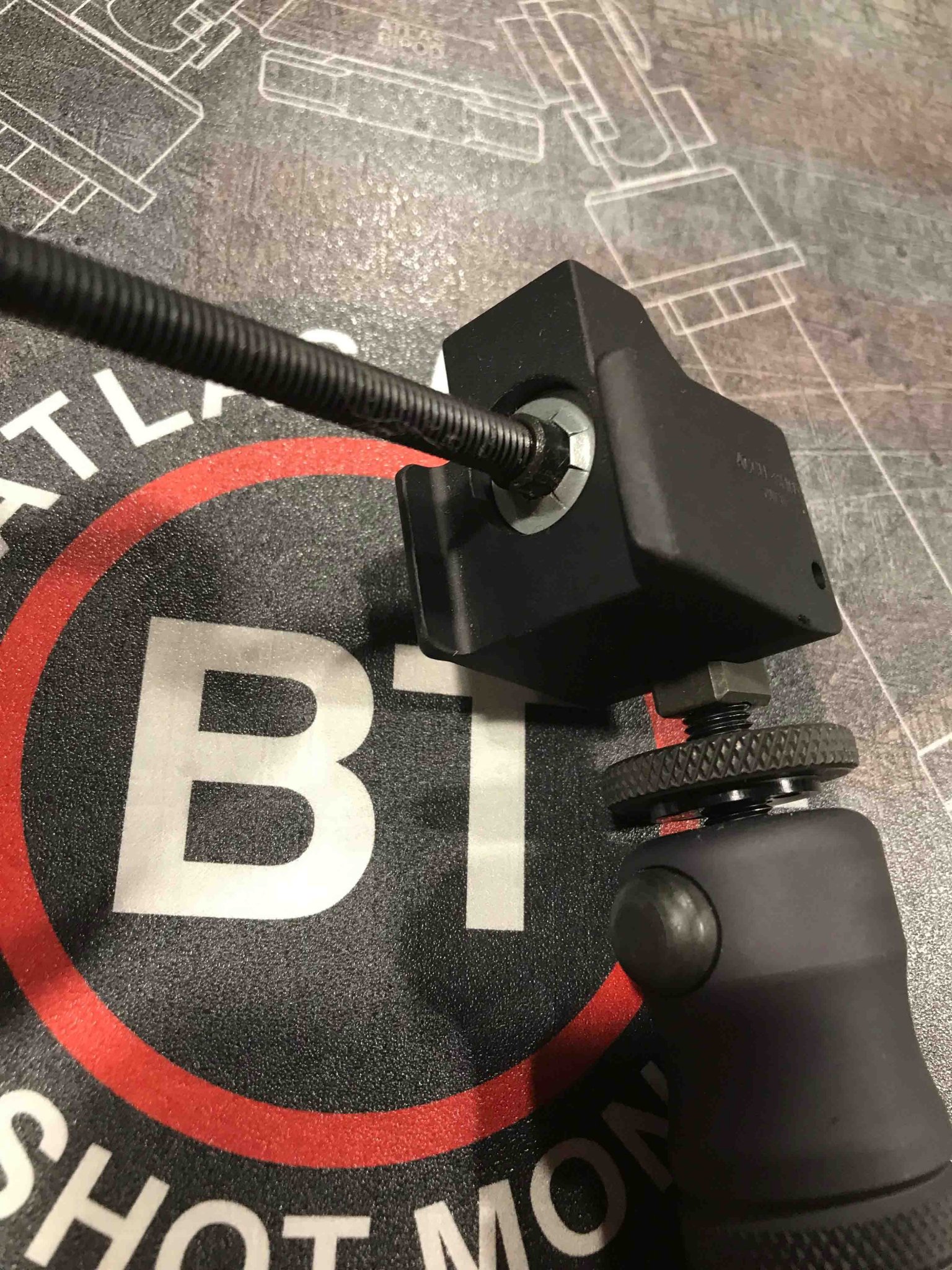

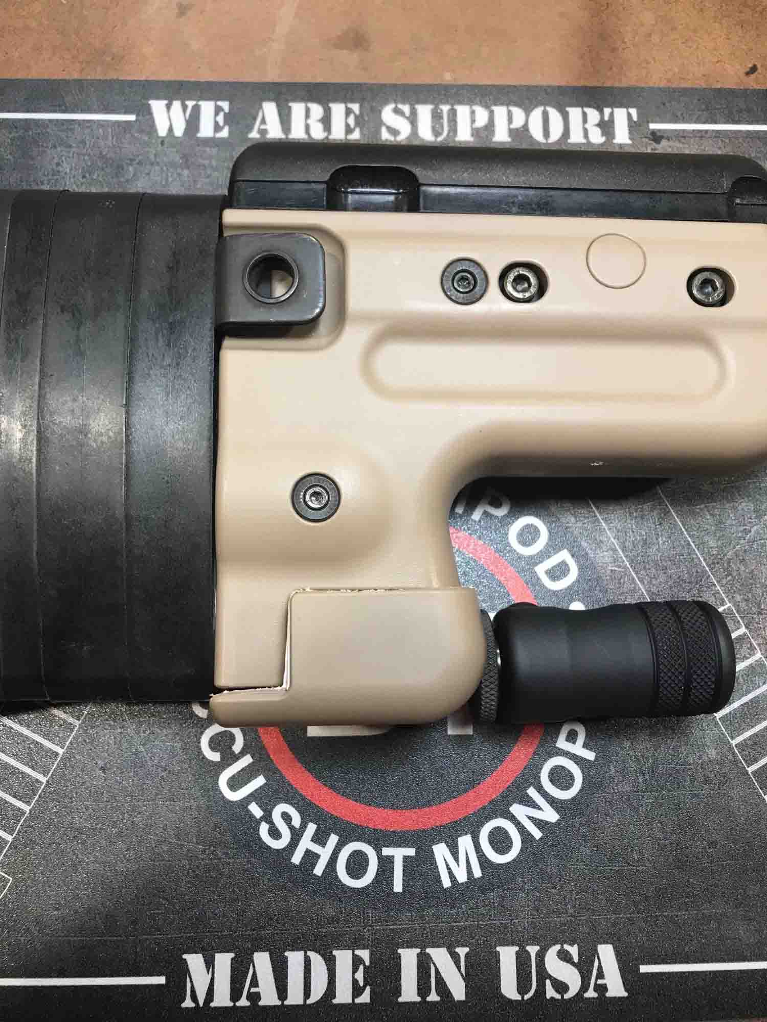

    I know there are parting lines on the but but am not sure how it comes apart. I forgot to try and figure it out when I removed them to install the new competition trigger but I don't recall that they are come apart. There is no instructions to be found anywhere. So the question I have is how do you install it? Is there a procedure?

    The skins have a "parting line" that is used as a cutting guide, (seen on tan stock on link above) I've taken a couple of pictures of mine after the fact... the small "corner" pieces are removed from both sides then the monopod fills in the void and is held in place with the lower buttpad bolt. The BT57 has two "ribs" on each side that engage two sides of the frame. It's a simple, straight forward installation and the results are solid.

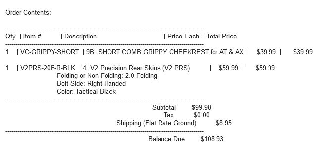

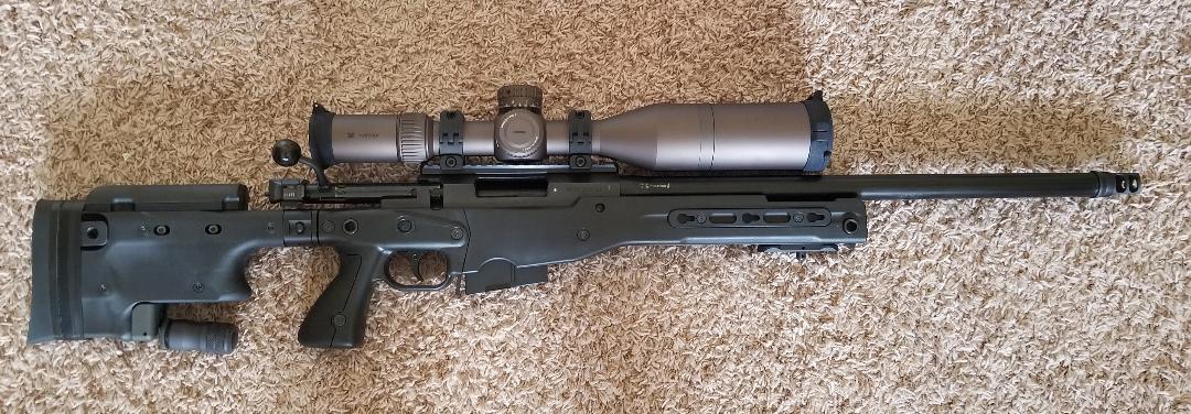

    Well that's kind of a pain in the ass... I went and looked up my old order and grabbed a screen cap, and also took a pic of the skins on my AT (note the hole for the Quickloc screw) showing that they do in fact fit. I'm not sure why VC doesn't list the AT as a compatible model.

    No tellin'. Given all of this headache, the BT57 monopod that Kasey mentioned above may be a better solution.

    You know...he may have thought I wanted the entire set of skins. I am only looking for the buttstock. I'm going to try him again
