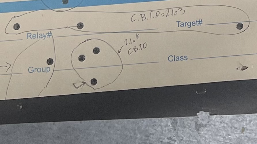

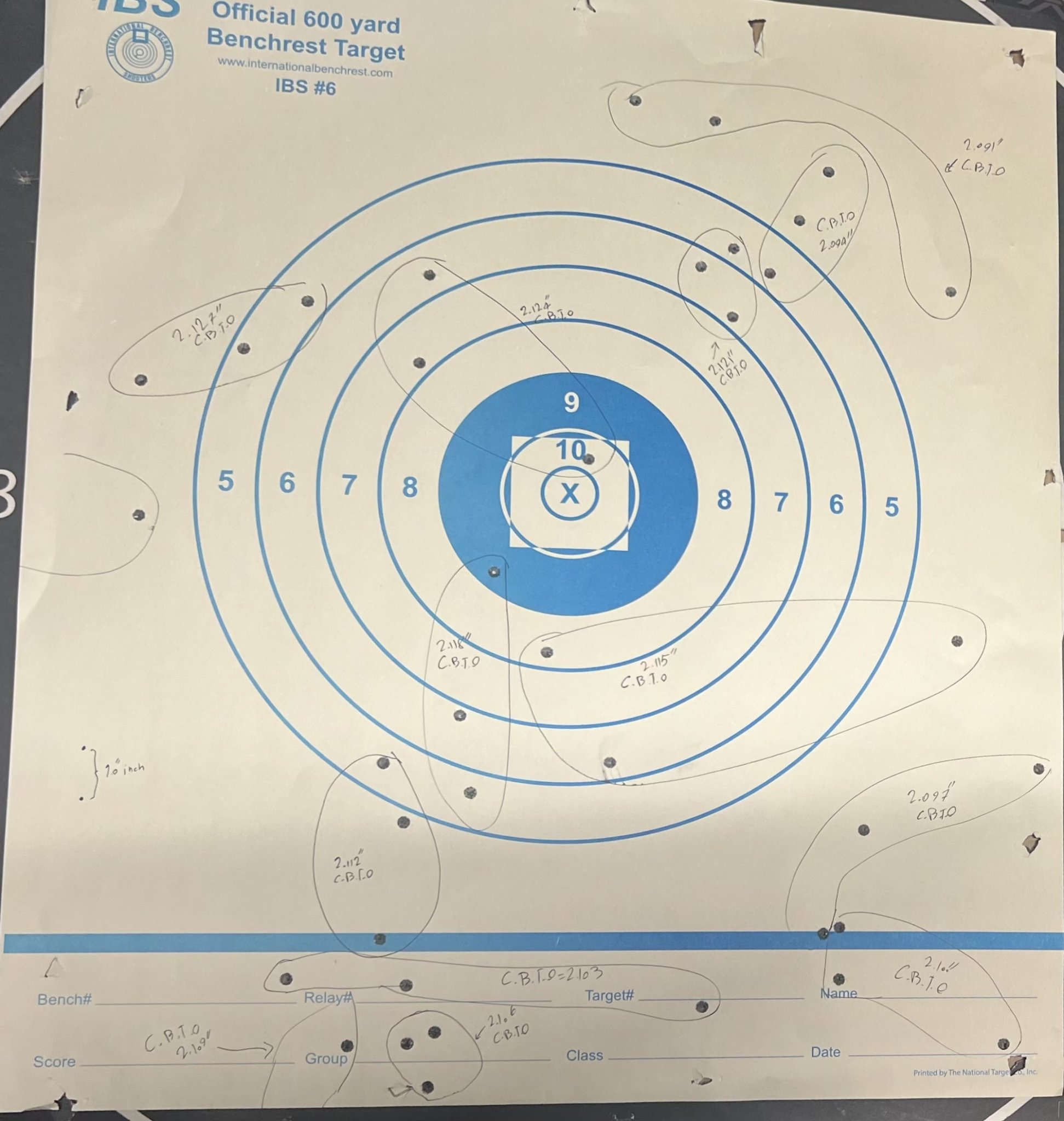

100 yards test showed I have a seating depth node from 2.121 to 2.097 cbto

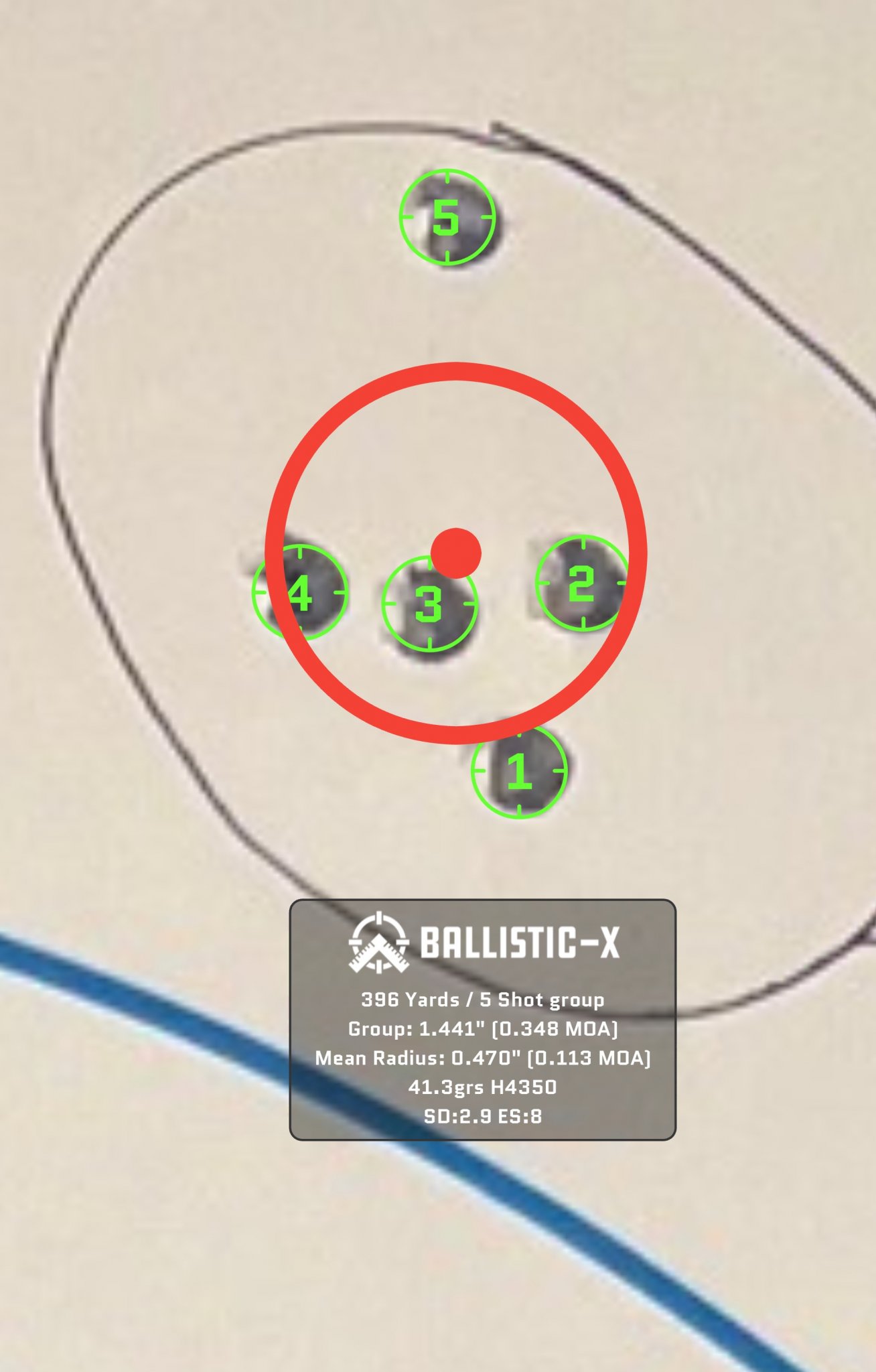

went outside and shot them at 400 yards
Surprisingly the cbto that had the most vertical at 100 yards had the best group at 400 yards
This was all with cci450
So I settled at 2.118 cbto

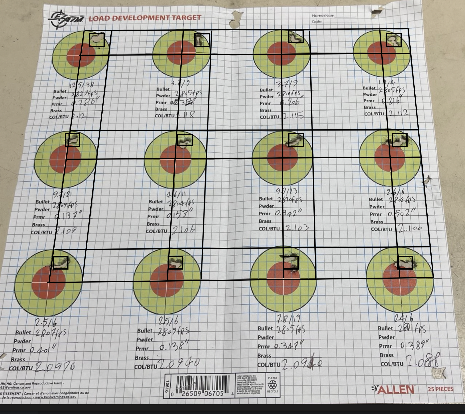

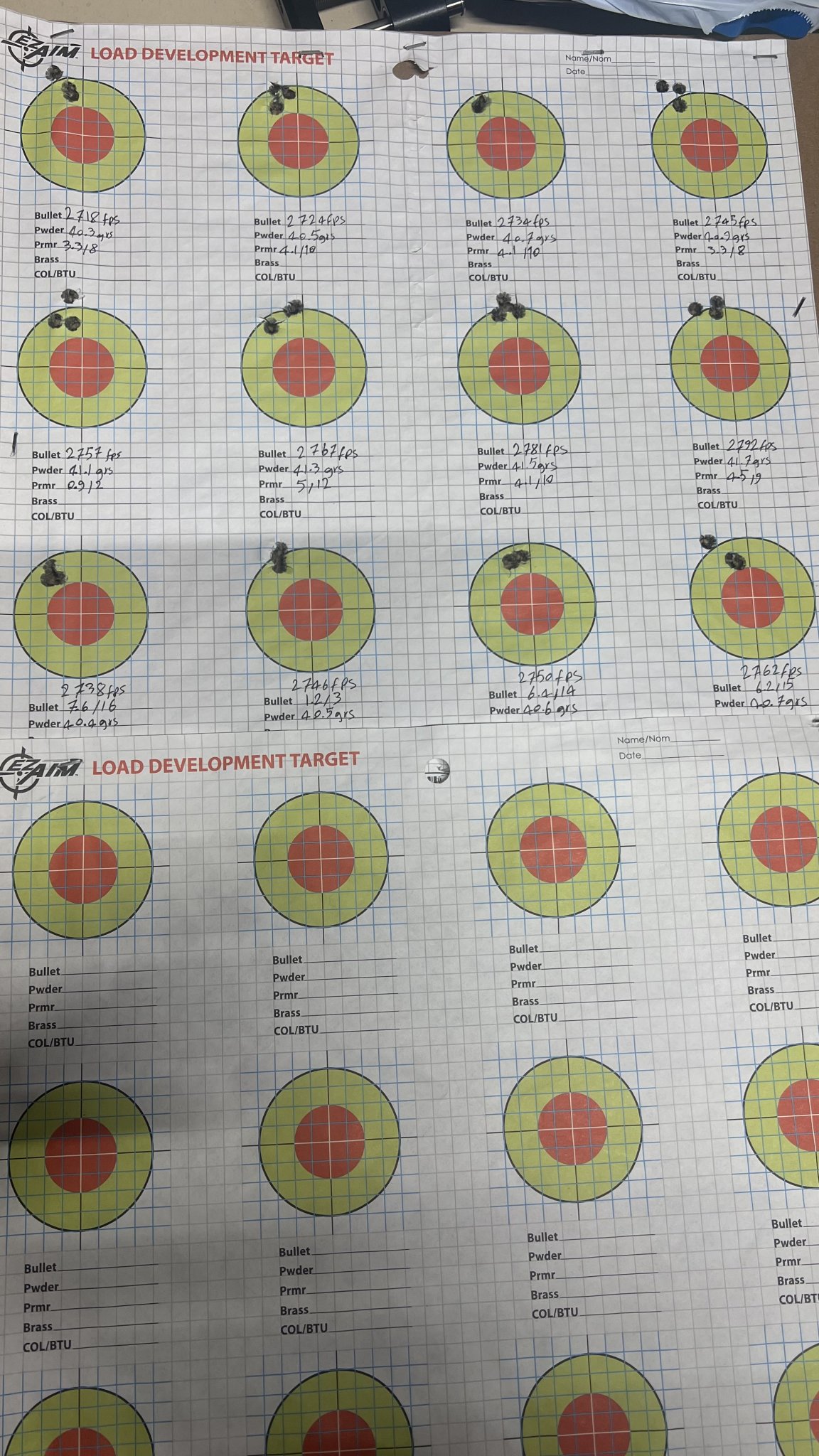

Yesterday I tested the Fed 205m
40.3grs with 0.2grs inc up to 41.8grs
The first 8 groups are the results with Fed 205m
Last 4 groups are with cci450
The storm started and I had to leave.
At this point I am just tired of seeking crazy accuracy just want to have a load that is reliable and I don’t have to mess with it that much in summer time.
Usage of the gun will be shooting bench up to 800-1000 yards
One friend of mine whose a F-class shooter told me if you are changing primers you don’t need to play with seating depth again.
But I don’t see any velocity flat spot with Fed205 but I see some similar POIs
What would you pick to just be done with it?
You can see most of these groups are between 0.1 to 0.3 MOA at worst but something In my mind keep pushing me to seek for more accurate load but at this point I am overwhelmed with all these tests and overthinking everything lol.

CCI 450 and 2.118 is what I’d go with. I always test is .5 grain increments initially and .005” jumps in OAL off the lands. .003” is ok for the jump but I personally only go down to .3 grains on the powder. Testing .1 or .2 grain differences (referring to last pic) for me won’t show enough of a difference compared to what heat or what not might change. If that makes sense!!??
I’d rather have a group that shoots great at say 41.3 grains. But also shoots well at 41.0 and say 41.5. Same for jump. I’d rather see it shoot well at 2.118 but also shoot great with more jump. More forgiving as the lands wear.
Yeah they all shoot well
So maybe I should be happy with .2 and .3 groups?

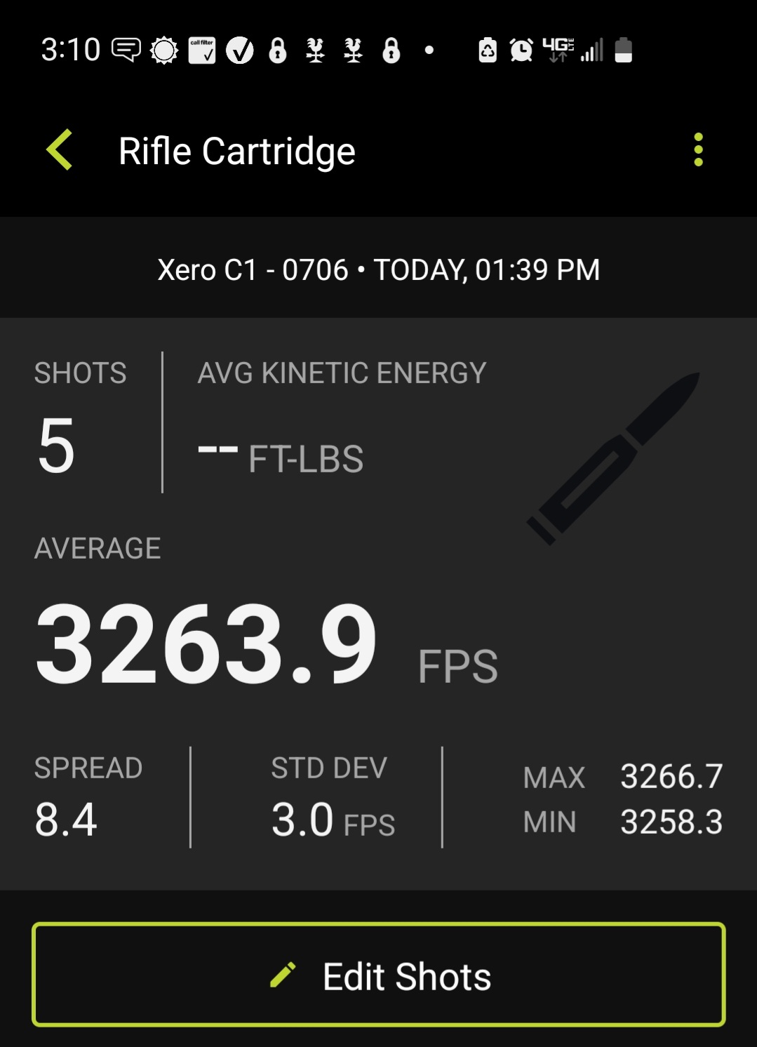

All of this needs to be done over chrono. Those numbers are critical when determine where the gun is shooting flat in a node and lowest es/ sd.
Trying to decide what’s load and what’s shooter from a long range setup at 100 yards is not as helpful as you might think. Whatever load is the best and most forgiving over chrono will get you far.
Which group would you pick to take to distance? I have enough components for testing but not enough time on my hand to drive 2 hrs to shoot the distance
My point is all those 3 round groups are statistically insignificant and even with all the different shit you tried between 3 round groups they generally hit the same spot and are within normal statistical distribution of each other for group size.
Id pick one in the middle of charge weight and seating depth (since they all seem to do the same thing) and run with it.

2.121 @ 41.6gr is what I would test more of. Shoot a 10 shot group, and if not horrible, be done with it.
You're going to get 20 different answers from 20 different experts. 2.121 allows your throat to erode the longest without screwing with seating depth, and 41.6 splits the difference between two possible decent charges - so you can throw a tenth off and still have optimal accuracy.
Frequently I'll test until my velocity is where I like it, and then adjust seating depth to get the accuracy I'm looking for. YMMV.
Just to add a better visual on how little theses groups vary from one another, I've added bolded lines and 1/2x1/2" squares. It isn't prefect as picture isn't perfect.
But it will show you how little these groups deviate from one another. It's not really enough to know which one is better. They are just too similar across the sample.
Thank you for taking the time, so what do you suggest? Do the powder charge test at 400 yards again?
From your data, I'd suggest picking the velocity you'd like and then spending time making the most consistent ammo you can. After having larger sample of that ammo, if it doesn't perform as you'd like, then you can try another.
The alternative would be more testing with a lot more rounds. And based on what I'm seeing so far, the rifle will perform plenty well for your purposes. So, I'd consider it wasted ammo unless you really want to get into the weeds.
Large rifle primer?
Small rifle, cci br4 and cci 450, depending on rifle. That bottom row is solid, pick the 1 in middle, looks like a node from 40.5-40.7. Or look for the next higher node, if you want more speed. It won't make a huge difference on wind calls, and a consistent, accurate load is the most important feature.
Spot on. A shit ton of winning rifles do not shoot tiny groups at 100yds. It is load consistency that wins at distance.
Pick a load that has good margin on both sides and get past 100yds.
You will get more hits at distance.......shooting a .5moa rifle at distance than a .1moa at 100yds.
Also, barrels are consumable. Don't spend yours finding the perfect load just to start over with a new barrel, unless that is your thing.
Just my opinion.......not even worth $.02

3 round groups don’t tell you a whole lot. I mean, they can tell you something if they’re not good.
But tight three round groups don’t tell a lot. Some of those tight three round groups might open up to the same size as those larger (but still rather small) groups with just one or two more rounds on target, while those larger groups may not get any larger with another couple shots fired.
Also, that range is beautiful.

When I was doing seating depth test, 2.109 showed one ragged hole at 100 but it was ugly at 400 yards, that’s how I ended up with 2.118 (1.6” including that top flier

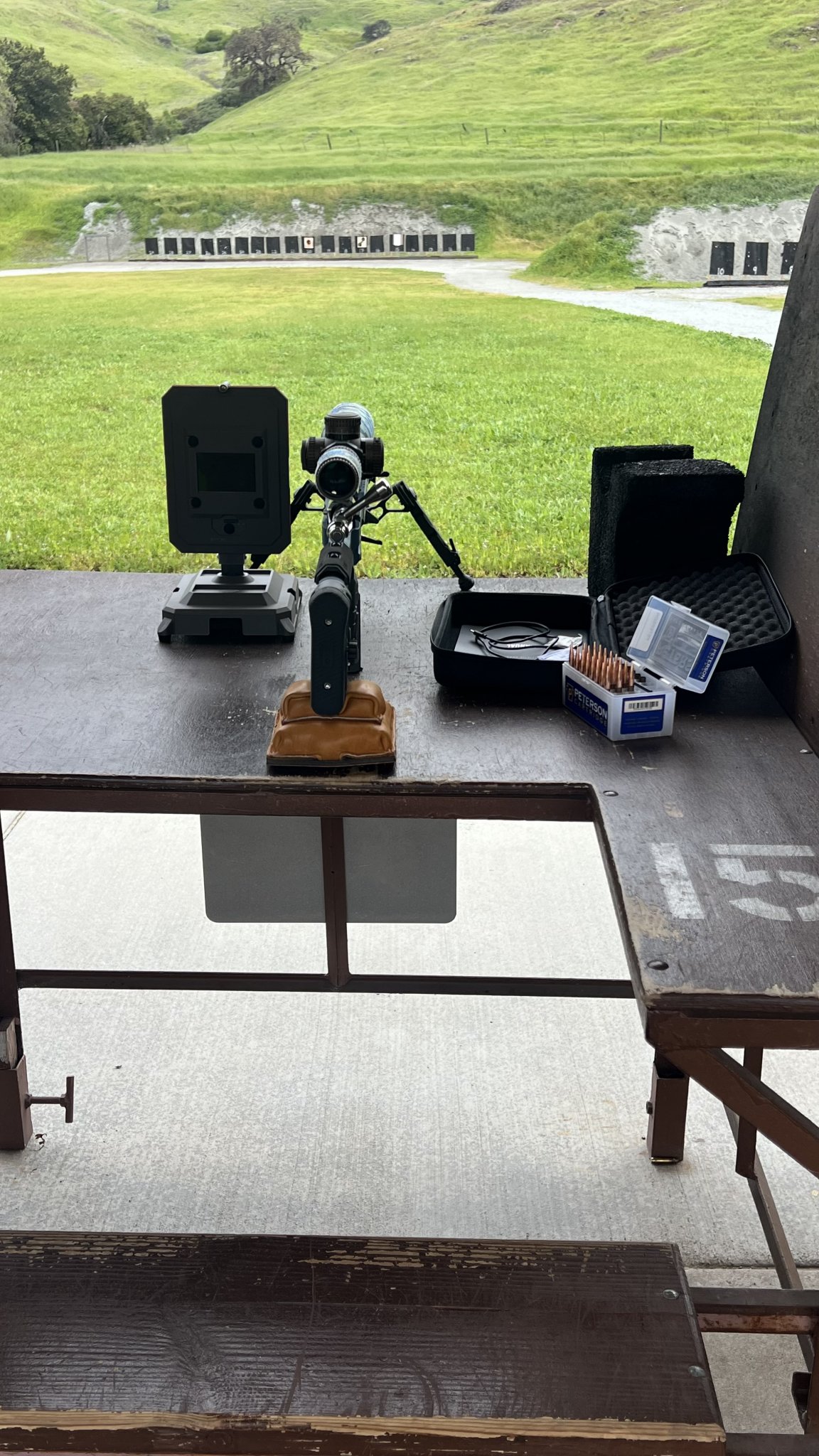

This range is beautiful but unfortunately I live in a area that they don’t support shooting sports, even the 200 yards range is only open once a month! Lol

A chrono would tell you if that high shot was higher fps or maybe just you. But I see nothing wrong with any of your groups.
Pic a couple favorites and shoot them again if you’re concerned. Pic the best of those and start shooting. Learning to read wind and positional shoot etc will be more beneficial I think than chasing 1/4 moa
Even shooting them at 100 yards and going by group but mostly chrono consistency would help. I personally shoot 500 for most of my final loads. Pending weather is good. At that point I’m looking at vertical dispersion more than horizontal in my group size as I’ve narrowed down to good shooting combos already

With a Garmin xero, it's so easy to chrono every shot during load work. As these sharp guys said find a load that does single digit sd and lo 20s to teen es that shoots good at 100 and see what it does at 500-750yds. 22 creed at 750, hit higher than expected and the 5-15mph fv wind didnt help horizontal.

Since I am confident with the seating depth
41.1-41.6 gave me .2 to .3 at 100 a few times and .3 MOA only tried it once
I am gonna go out and shoot that a few more times at the distance to see how consistent it is

went to the Range last week to finalize the load with seating depth
41.7grs H4350 with new jug was giving me 2790-2795 fps with low sd.
Shot this target at 600 yards with heavy mirage and 10-13mph wind from right to left.
