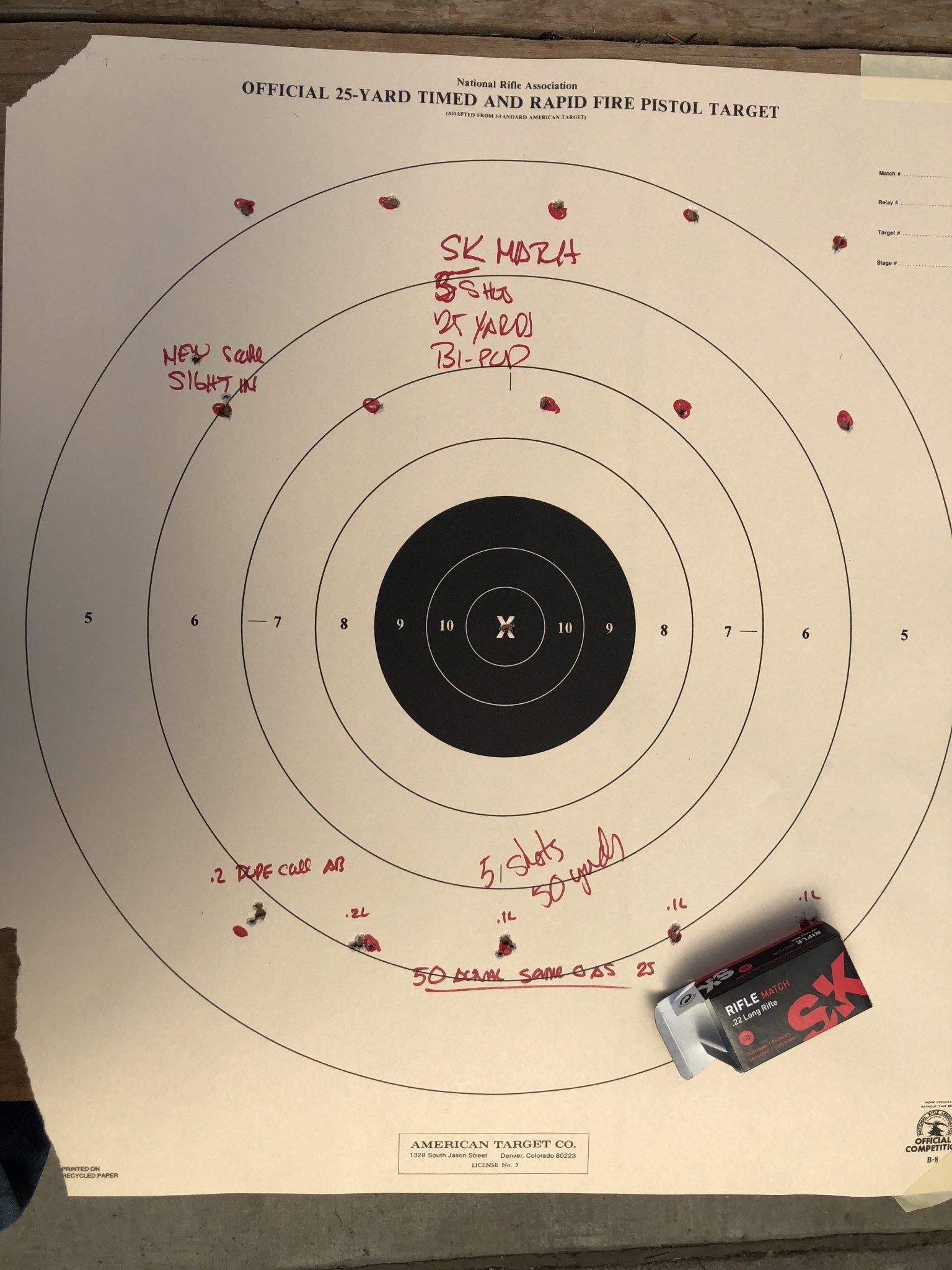

I do not have 100 yard targets to show, but here is 9 (+1 were I sighted the scope) at 25y and 6 more groups @ 50 yards (one in the center X). At 100 all 4, 5 shot groups were well under an inch, but I didn't really pay to much attention as I was just looking to confirm dope for NRL22 type stuff. 0=25; 50=0 100=1.9mils drop.. turned out easy.
It was the first rounds out of my Vudoo off a bipod, not a rest. I do have to say that it out shoots my MKII, my old CZ and the RPR-rimfire. I did not have 50yrd dope use my AB and "surprise" it was off, next group left 1/10 to much wind in, 3-6th group had the correct drop info.
The difference is the Vudoo just shoots and my CZ, MKII and RPR all are VERY specific. The latter 3, all like different ammo; one likes Ely Club another, FGMM better, PRIME shoots way over there, FGMM over here, a total crap shoot, on POI shifts. You need to test the ammo no way around it on most production 22s. The offsets between 22 ammo is just nuts, so switching between ammo isn't so easy on the MKII, CZ or RPR. I must have tested about 20 different types in the MKII, CZ and RPR. The Vudoo, opened the box, sighted in the scope then shot a few groups. 2 boxes down, I was supper happy with my wait for it done. Then ran off to a NRL22 match the following Sunday :)

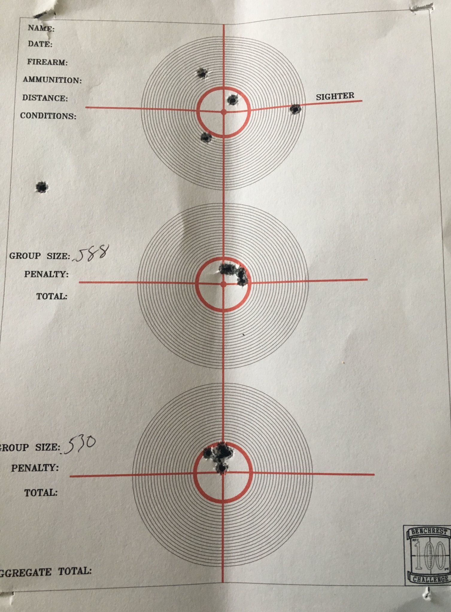

All my current rifles will do .2’s or better at 50 yards and around 1/2” or better at 100 yards (all ammo I run is lot tested ). All my guns are custom fit match Barrels and fully reworked. Equipment is important but the most important parts of the gun are the barrel and the ignition. Make any one of those or both crappy and that gun will be a dog. At 50 yards or closer most setups that are decent will do well but when you stretch out further to 100 and beyond, things fall apart real quick! I like cz’s cause I can easily get the accuracy I want, it’s cost effective, and they function flawlessly in every way. The Anschutz rifles I like as well but it’s more work to get solid feeding and ejection. The benefit with one of those is less work on the ignition side and you get a better trigger, finished rifle, and most of the time and smoother action. I use to build savage mkII’s and while I can get the accuracy right on par, function is where it went out the window! Those magazines are terrible lol. Use to get a kick out of shooting one at the range with a custom fitted barrel and telling guys It’s new right out of the box lol.
This target was from a custom built 452 I did and shot it at 100 yards in a match on RFC (note measurements are outside edge not center to center, ctc those groups are in the .3’s!). The other target was shot with a custom built 455 I did in a klinsky stock, that rifle was absolutely insane!

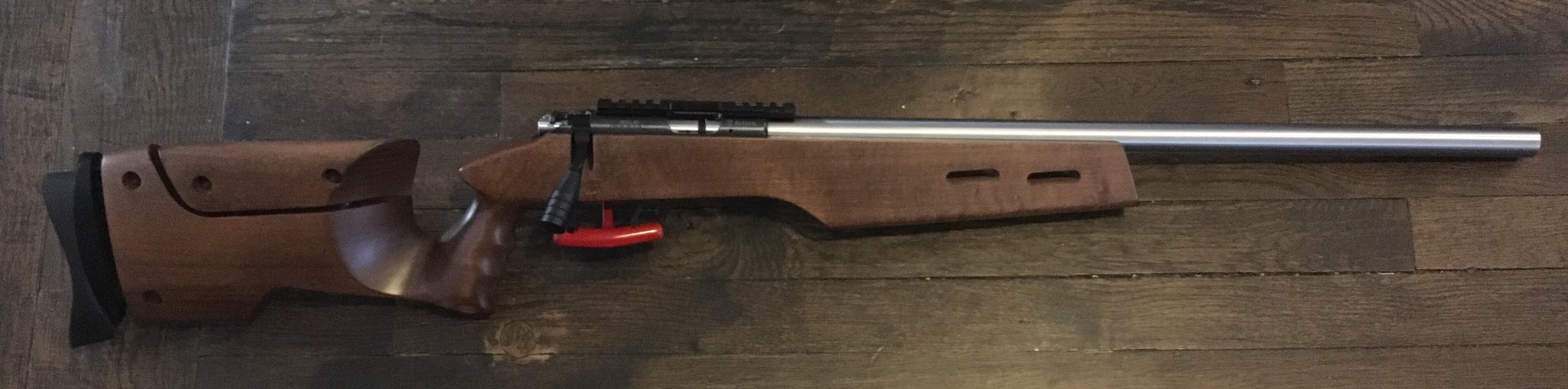

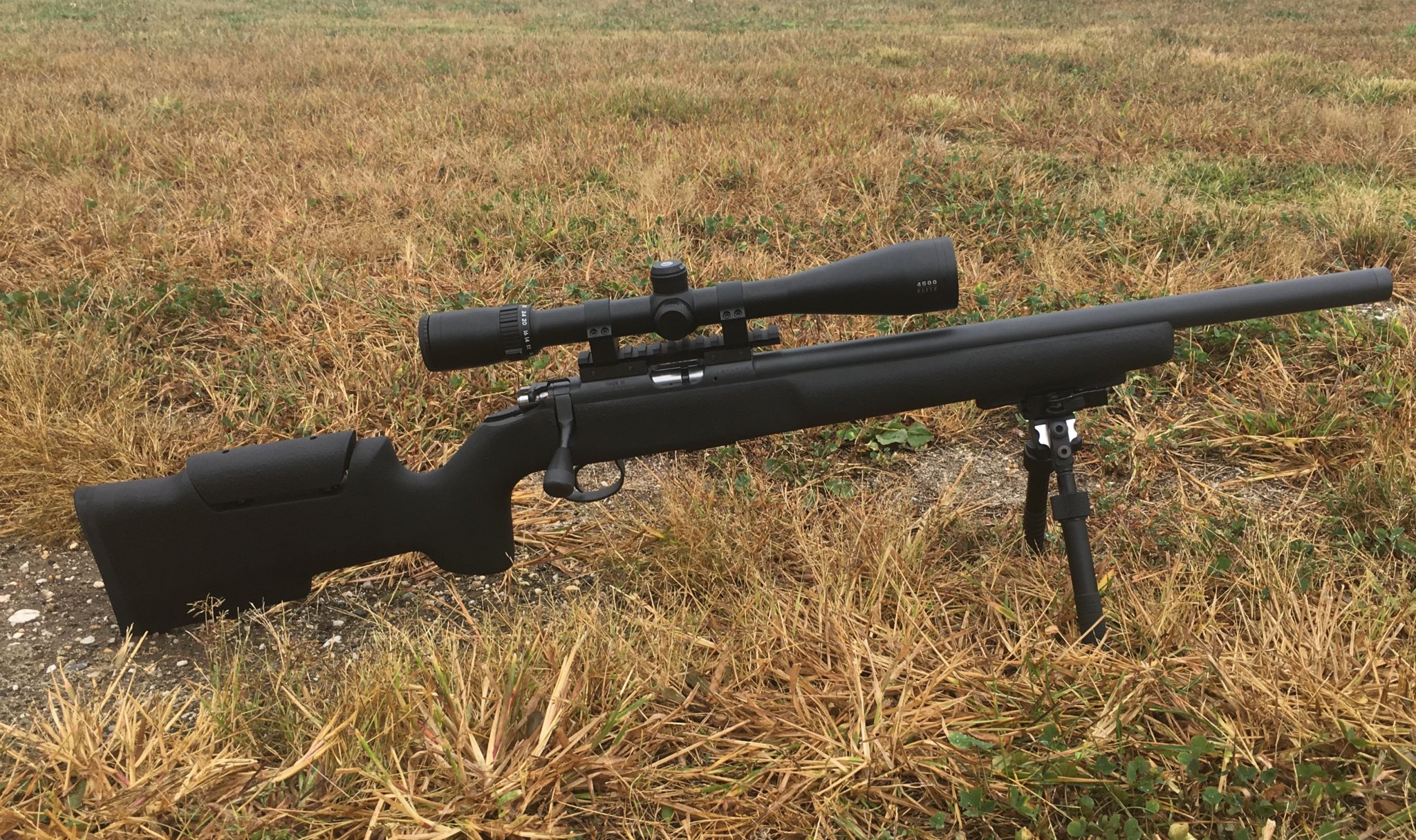

452 was shot off a bipod and the klinsky was off a rest. The 452 had an 18” threaded custom made to my spec Lilja 3 groove barrel with a chamber I designed and the 455 used the same blank but wasn’t threaded and was 24” long. Both where bedded, triggers, full bolt work etc. Both rifles pictured below.
How are you getting the klinsky stocks?
Use to be able to get them from a guy named Denny but he isn’t doing it anymore as far as I know. The one above was bought directly from the Czech Republic and shipped to the USA. It is a pain to do as they don’t speak very good English so it’s hard to understand them and you gotta wire the money to their bank. If your able to deal with all that you can most certainly get one!

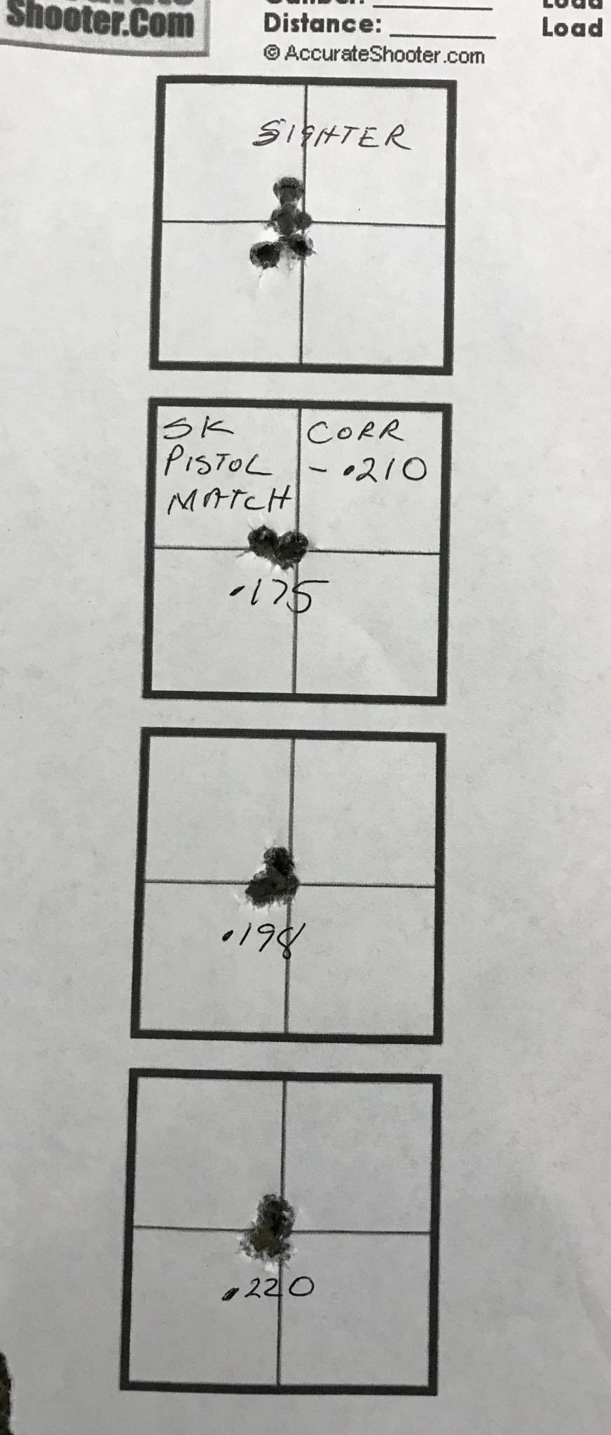

That’s about it. FWIW, I settled on SK Pistol Match for the CZ 455 in the stable. It’s quite accurate, affordable, and has a great BC. I can reach 400yd without holdover, which I can’t do with most other ammo. I tried 50-100rd each of at least a dozen kinds of ammo when making that selection, and a couple were junk, but most Match ammo shot quite well.
