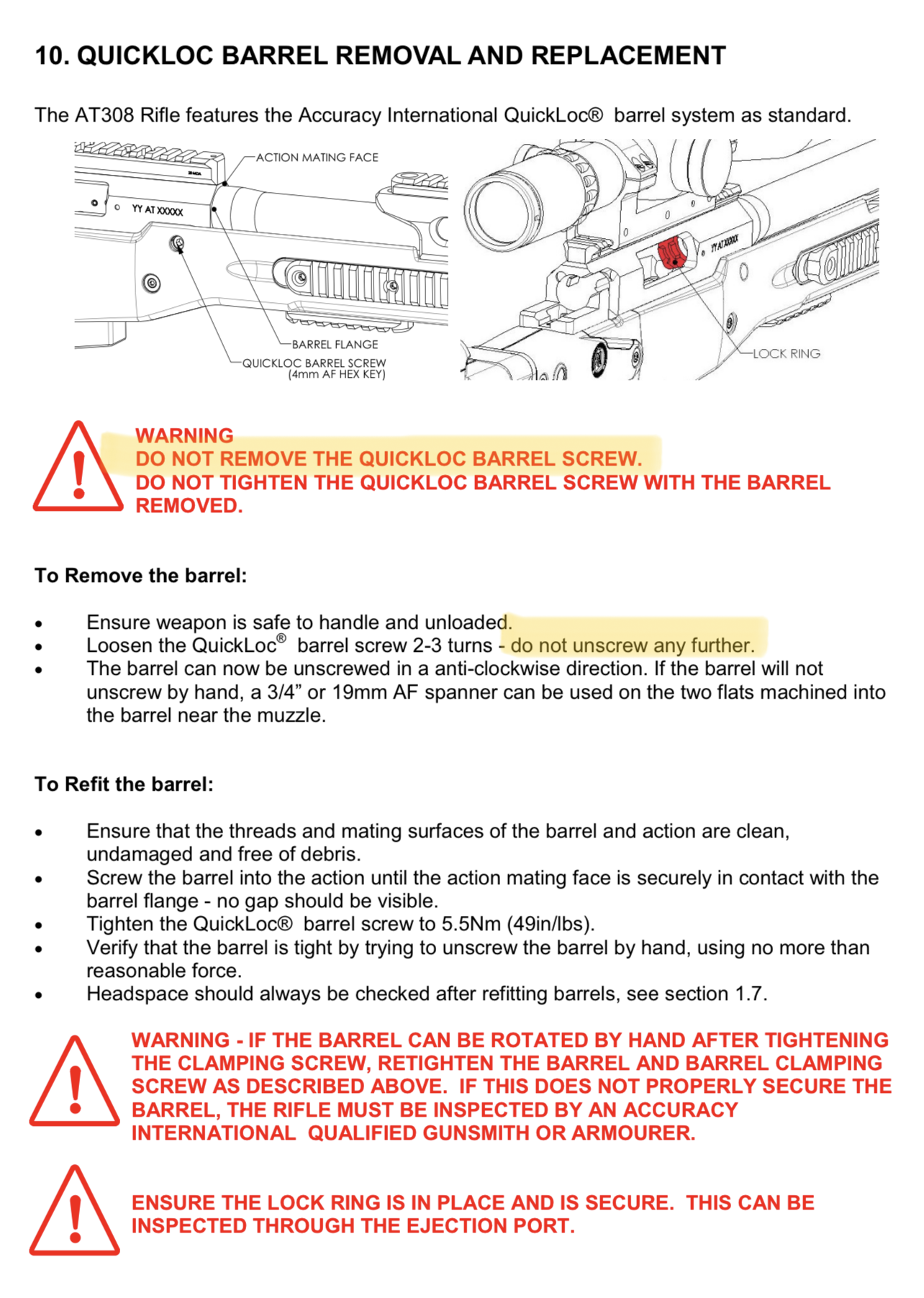

Was talking to a friend who has many more years experience than I with the Accuracy International AT308, and he and his department run Hornady TAP ELD Precision 168gr exclusively as a SWAT Sniper. While I've had a hard time getting this ammo to group tightly despite its superior ballistics on paper, he and his guys are getting notably better accuracy and precision with it, from the Lothar-Walther 1:12 20/24 inch barrel. The difference is, I'm torqued to 49 inch/lbs, while he and his guys are at 55 inch lbs, so 6 in/lbs over factory spec.
Is this common? Have folks here played with different torque specs for the barrel clamp screw? And, what grease if any are you guys putting on your barrel threads before screwing and clamping it in?

I read this thread as well, although it doesn't share much other than stating the factory spec of 49 inch/lbs.

I did a bunch of searching a while back and ended up on 55 inch lbs on mine. There were threads of people having barrels loosen at 49 or be inconsistent. The last bit seemed to help

Yeah, afaik you’re not even supposed to remove that QC bolt due to losing a washer in-between the action and chassis (or something like that).
What you should not do is torquing the bolt on without a barrel.
Bolt heads get worn/round over time and you replace em as if its any other bolt. Ive replaced some of mine a few times already.
The washer is just sitting there. You lose it just get another from mcmaster/ace ect
I’m definitely not torquing a bolt without a barrel installed. Who is doing that?
I suppose if the hex head is messed up, then yeah, you must replace the bolt. AI itself says to not remove that bolt, apparently due to the washer issue.
But hey, if you’ve fixed this issue yourself, more power to you.

Probably on there so you dont lose the bolt on the field.
As far as user level maintenance i called MH years ago and they sent me a baggie of the spec metric bolts to replace and keep spares.

Called Mile High today and asked about if they use any kind lithium grease or anti-seize on the barrel threads. They explicitly said no, as any and all of that can get in the H cutout at the bottom of the action receiver where that screw tightens things down around the barrel, and it's essentially impossible to properly clean in the AT308.
