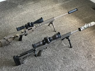

I got my AX and still wouldn't give up my DT
