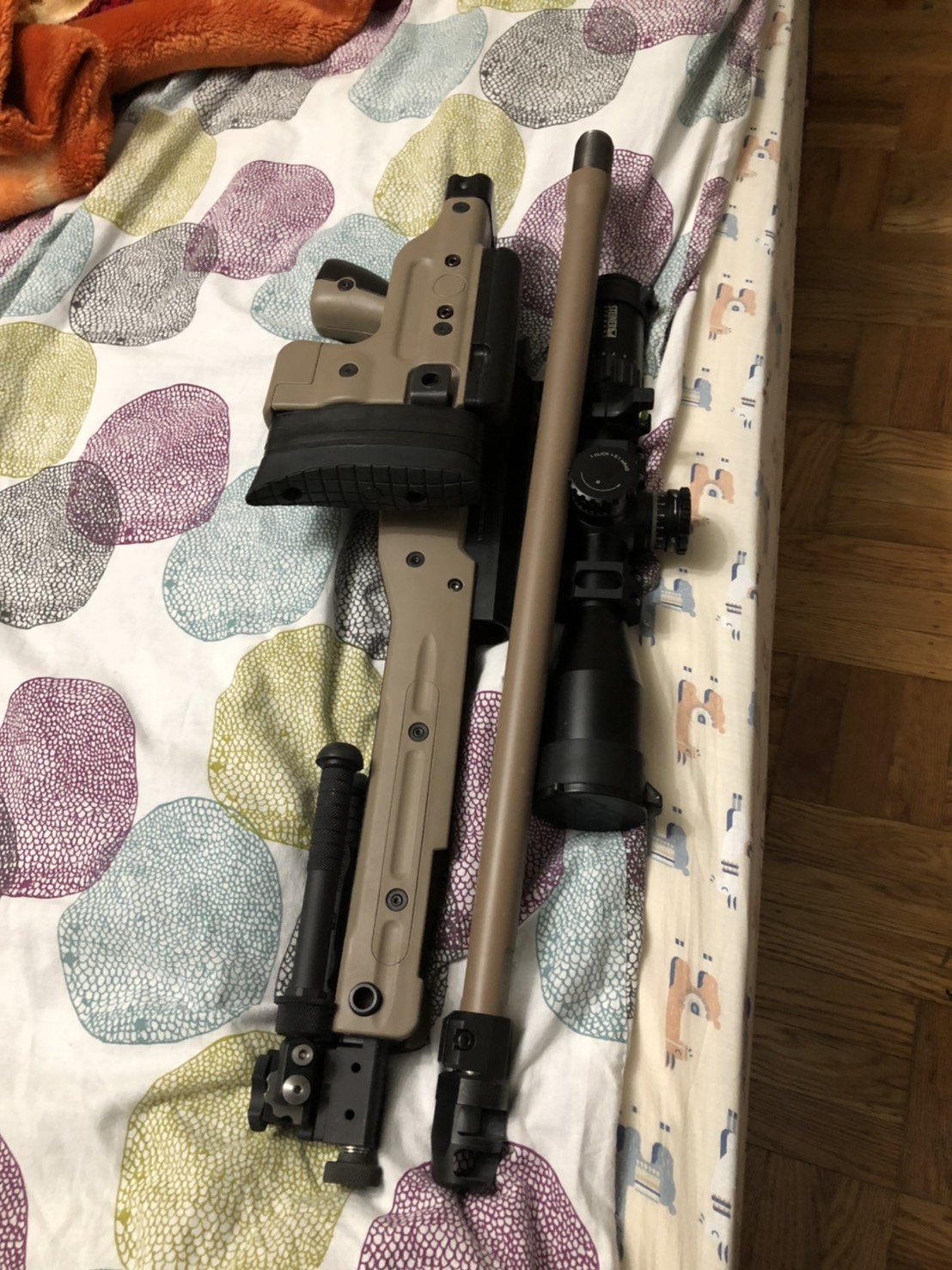

There is one other thing that can affect accuracy. When i got my AIAT i had some accuracy issues, my groups were just about 1 moa at 100 yards. I found that I didn't have the correct torque on the barrel set screw. I got a 6NM preset T handle Torque wrench and my groups dropped to 1/2 moa or better. This was with FGGM factory 175 SMK's. You just need to use the same torque when ever you change or remove the barrel. Also never had much luck shooting anything lighter the 175 gr bullets in my .308 barrel. If i remember 6nm is about 53 inch pounds.

hate to see you getting the results you are. I have a AT with a 16.5" 308 barrel and it stacks them in the same hole at 100 with any ammo ive tried. I would definitely try some quality factory ammo and make sure your tq the barrel correctly. Also maybe try taking the break off and see if that changes things.

Be curious how yours shoots without the brake and torqued in with an issued armorer wrench.

Edited to add. That brake in the picture, I hate, it imho/imhe, is about useless.
Had one on a 338 lapua. It didnt brake ANYTHING... and after trying it on a few other rifles, it is now a shelf rider.
Have it and a APA bastard brake side by side. Hate one and love the other noisy little sucker...
Will occasionally put them on other people's rifles to show them a useless piece of shit brake versus a real working brake.
