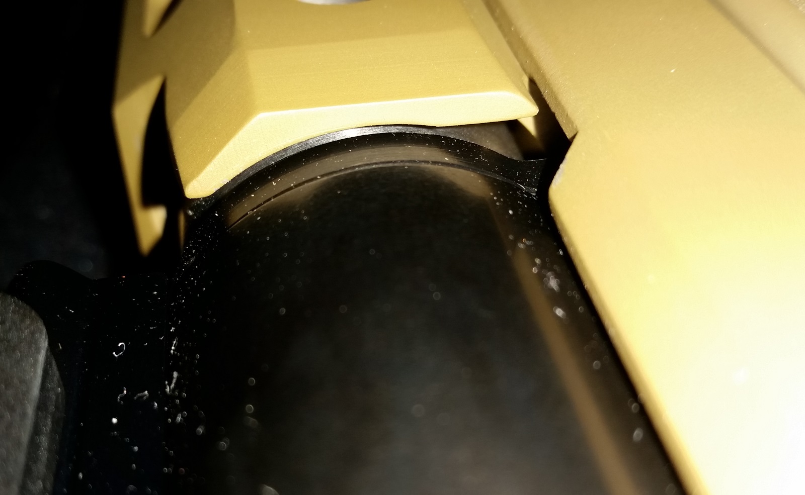

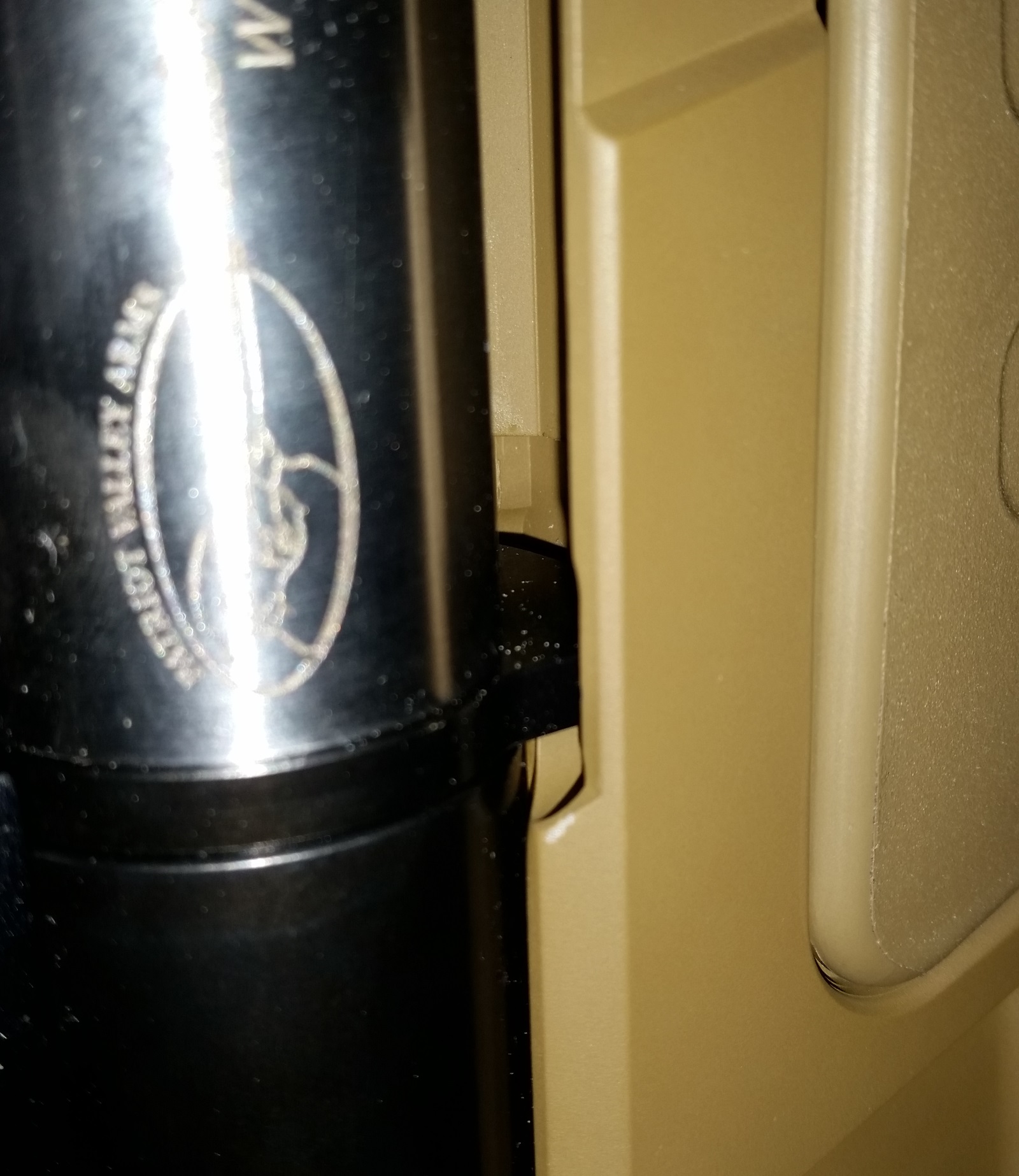

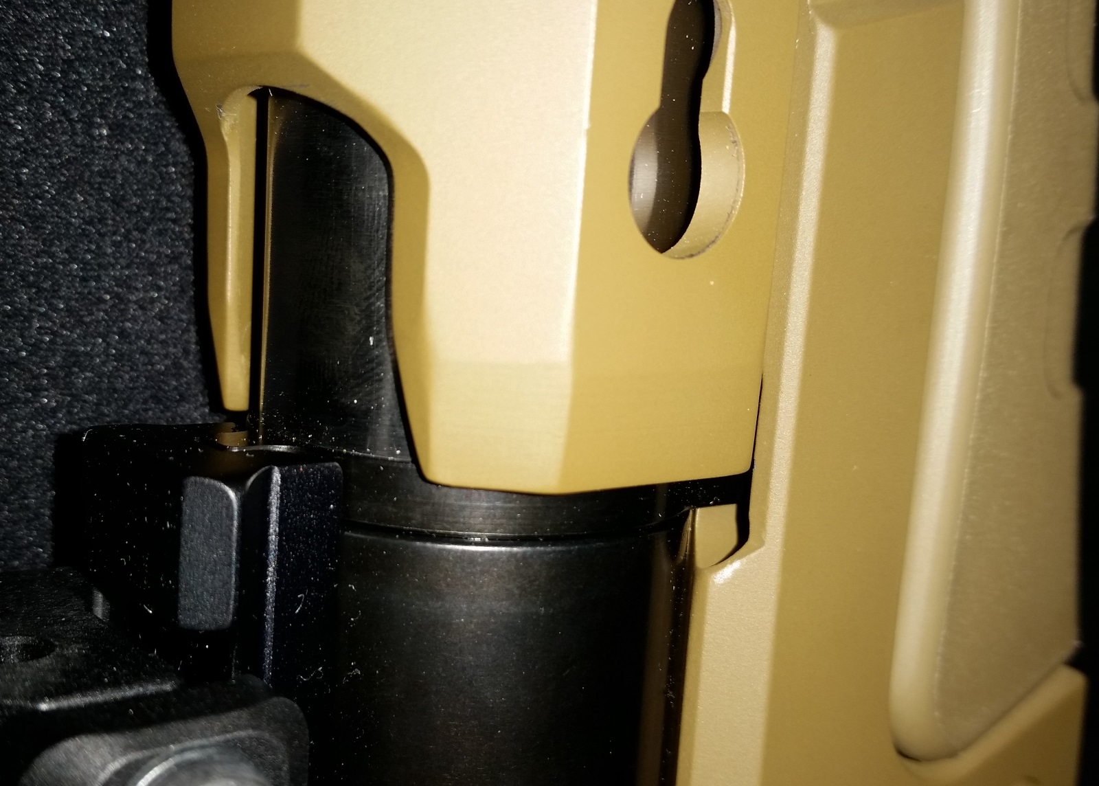

Here's some pics of the AX chassis right near the recoil lug, both with and without the handguard attached.
I think you may be able to get away with simply shortening the back of the handguard a bit to allow more room for the Barloc. I think the Barloc may clear the chassis itself without modding it, there's a decent amount of room in front of the recoil lug.
Note: This is a post-2014 AX AICS, not sure what the pre-14's are like in the recoil lug area. Other good news, the buttstock on the post-14 AX AICS clears the Nucleus bolt handle with room to spare when folded.
