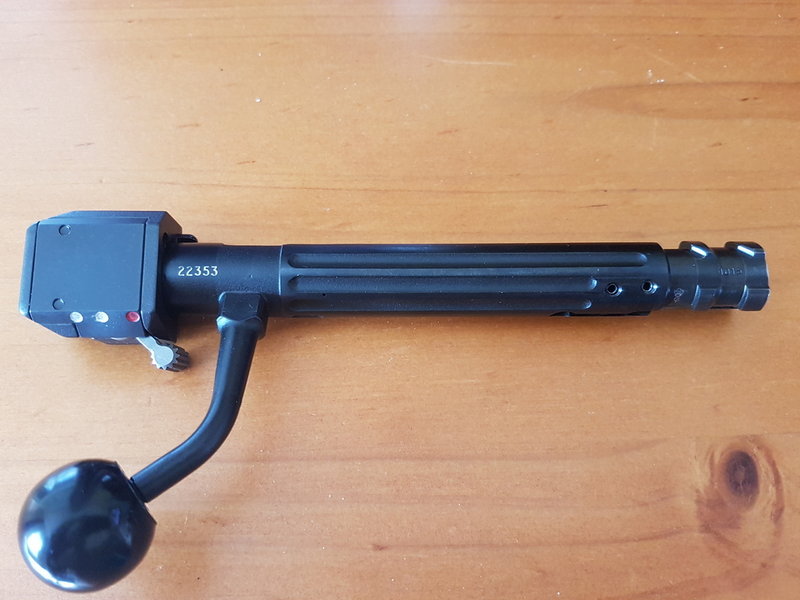

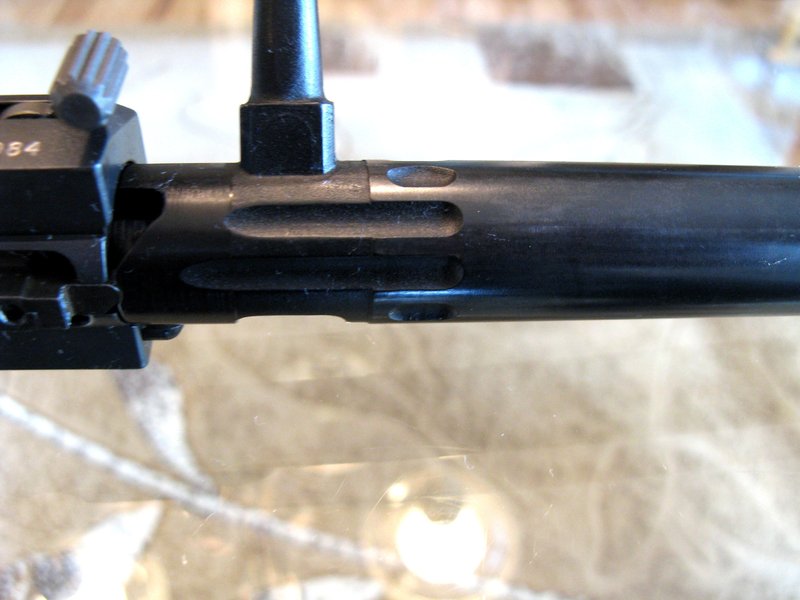

Pictures Courtesy of user " beenjammin " of Auburn, Alabama ... Thank you !

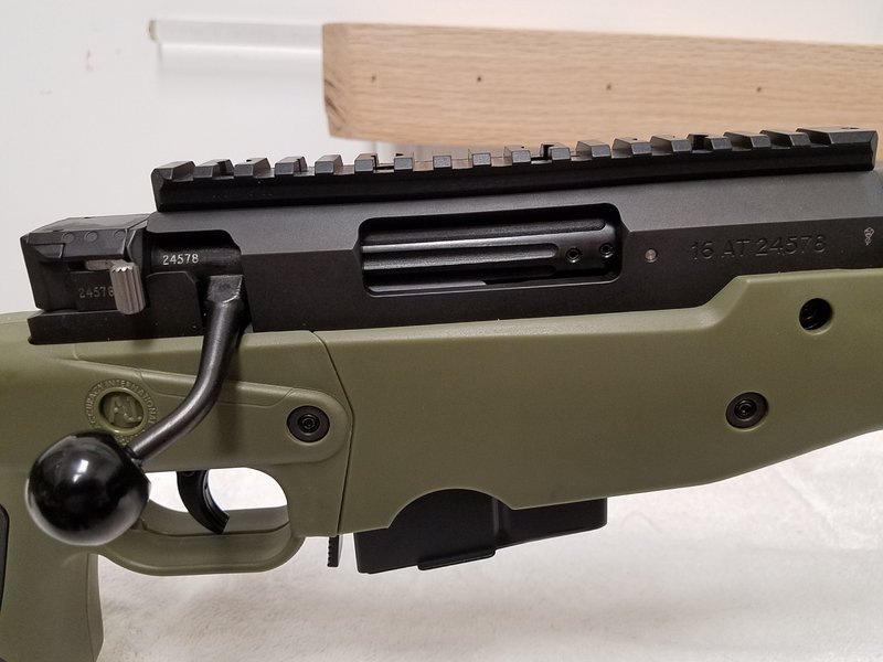

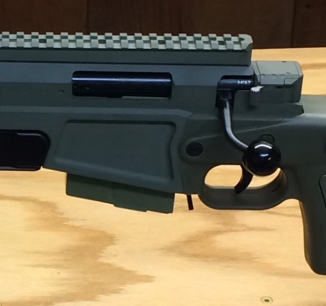

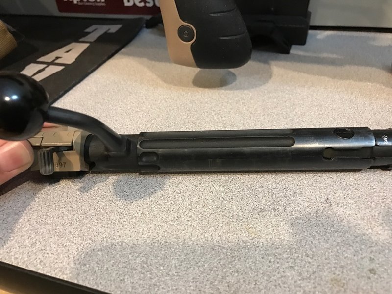

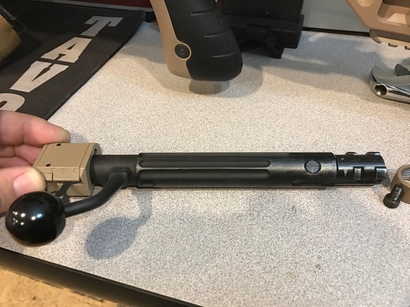

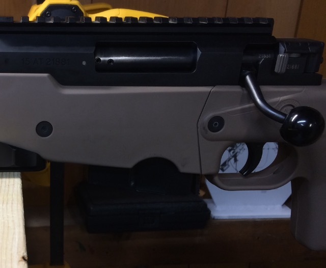

Tom,
I apologize for the crappy pics as I don't have the rifles in hand, but you can see both the 15AT and 16AX (both left handed) have no visible flutes through the ejection port when the bolt is closed. There is one flute that goes the entire length of the bolt approximately 180 degrees from the ejection port, and there are a couple small flutes near the bolt handle where it attaches to the bolt body.

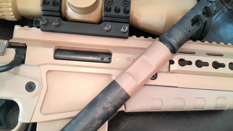

I was surprised that the SH user that posted pics of the brand new AX in Elite Sand didn't have the fully fluted bolt body either:
There has always been flutes since the AW. There was a time when the 308 and magnum had different castings and different numbers of flutes. We then went to a common casting and made 308 and magnum bolts from it. That is why you will see different flute appearances. In one of the photos which look like there are no flutes it is a left hand bolt. If you remove the bolt the flutes will be on the other side.
Tom Irwin
Accuracy International

And yes, the lefty AT and AX I have both have flutes on the backside of the bolt, but like I said it is one long flute, and just a couple small ones (~3/4") near the bolt handle. It is very apparent that the left handed bolts are not the same as the fully fluted AT and AX bolts, but just "mirrored". (See posts #15 and #16 above). Those have 3 long flutes and a couple of the short ones, which are visible through the ejection port.

My 15 LH AT has one flute that runs the length of the bolt on the non ejection port side (no flutes can be seen from ejection port). Does not look like the bolt Jwood posted one the other side.
