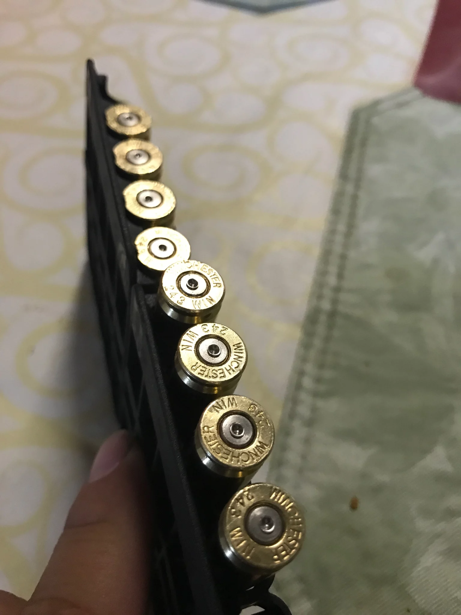

    How do I know that my AXMC needs to be bushed or just back out the firing pin ?
    I'm running 6creed & 6SLR with 210m primers, I can not get any major speeds in any of my calibers without punching holes in primers. Once I start to get into some of the speeds with powder charges some people mention here I start to have major puckering on the primers with the occasional piercing. None of my rounds have experienced heavy bolt lift or had ejector marks on the brass, but I know AI's cover these symptoms easy with the design of the bolt that lift is not hard. Primers are not flat.
    Another shooter in the local club matches advised me to pull the firing pin in a tad. So when my new firing pin arrives I will. The old pin had a nibble on it from piercing primers so another is on its way.
    Any additional help or advice will be greatly appreciated.
    Sent from my iPhone using Tapatalk

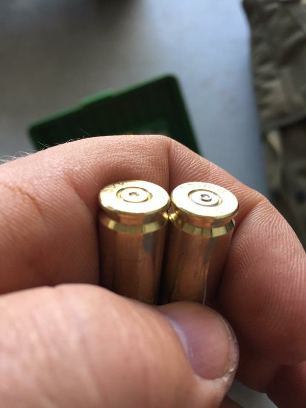

    Looks to me like you have an uncomfortably hot load. The radius' on the primer cups are flattened and you have primer flow back into the firing pin hole. There could be much more going on here that I am not aware of, but this looks dangerous to me. I suppose it is possible the firing pin hole is too large (for the associated firing pin). If so, how it got that way may be a mystery.
    Since day one it's always cupped the primers, if I shoot Federal gold match in my 308 it'll do the same thing, not as much flowback but still noticeable.
    Could this just be an issue with large firing pin ?
    I think pin size is irrelevant. Pin fit and profile are the main factors imo. Well, pressure too in any event. I see a pretty good ejector swipe on that second case up from the bottom. So you're up there with pressure.

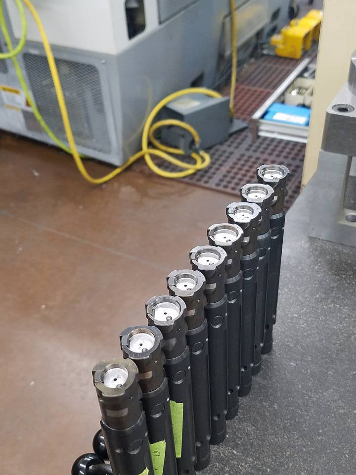

    We've bushed somewhere between 30-40 bolts now on the AI stuff and prolly a couple hundred worth of Rems, Rugers, etc... Judging from this photo it does not appear to me that you are experiencing elevated pressure. I base this off the following:
    1. Absence of ejector marks on case heads
    2. Radius feature of primer cup still present along the outer periphery

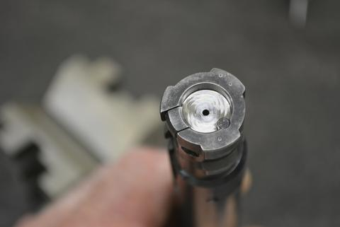

    What I do see is a striker pin that is significantly smaller than the hole drilled into the face of the bolt head. The evidence of this is how the primer strike is extruded between the pin body and the ID of the hole in the bolt head.
    This has been the achilles heel of the AI platform for a long time. One has to remember that the rifle was orginally designed for severe field duty anywhere in the world. Military ammuntion is fire and forget. They aren't policing brass and hosting reloading parties after a day of laying hate.
    The photo of your striker pin suggests severe erosion at the business end. What I have done in the past to avoid the trouble of ordering a new one is just remove it, drill for a .062" pin, install a heat treated piece of drill rod, solder it, and reset the protrusion and contour. Thus far its worked pretty well. The comfort here is there's really nowhere to go but up. The striker is already %$^&@# so you really can't mess it up. :)
    So, what to do? I can offer this: The process is covered in detail so be sure to review the listing if interested.
    LRI Striker Pin Bushing Service
    Here is what you can expect upon returning it:
    We'd have your parts roughly 5 business days. Happy to help.
