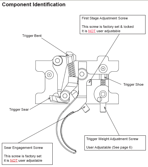

I have an AT that I am not happy with the trigger. There is distinct creep that I want to get rid of. However the only diagram I have seen shows that the only user adjustment is pull weight.
I was tempted by the competition trigger but have been put off by the original thread where several users reverted back to factory triggers.
A friends AT has a far better trigger than mine and breaks more like my old TRG trigger.
What advice can any one offer.

There’s a few more adjustments you can do to the stocker but it’s best you have someone with knowledge of the trigger do them.
There was a thread that showed how to adjust it further. But be warned, it can get to the point where it’s not drop safe.
I had this same issue with my AX trigger, whereas my AT broke very crisp. I called Mile High, and they told me to adjust the sear screw myself, no need to ship it in. I can’t remember which way I turned it (I’d have to find my notes) but it was seriously 1/4 turn at most and the creep was gone.

I’ve noticed anything under 3-3.5lbs on the AI factory trigger is hit or miss as far as drop safe.
It will handle a drop or impact on the side of the rifle. But dropping it directly on the butt of the rifle and it will fire.
3.5lbs and it’s completely drop safe.
Just something to keep in mind when going lighter on the factory trigger.

At or ae? Cause I've had 3 different ae that the trigger was lightened to 1.25lb 1st stage and 1lb 2nd, 2.25lb total, and they were all drop safe
When a rifle is new, trigger parts are rough. They break in over time and the feel of the pull improves.
Sometimes people perceive creep and blame it on sear engagement, but when they adjust it out the rifle becomes drop unsafe.
When all they had to do is shoot it a bunch of times and allow for break in. Or dry fire a bunch. Then, if the creep is still there, make adjustments and/or introduce some JB in there. It will make for a glass smooth break within a dozen cycles. Then you just squirt it away with carb cleaner.

What’s the proper procedure for adjusting the sear?
I realize I'm talking about a Bix'n Andy trigger however the mechanics of sear engagement releasing the firing pin are roughly the same. You unscrew the sear engagement screw just to where the bolt will not cock and stay cocked. You then turn 1/16 at a time until you are getting safe engagement, meaning firing pin not slipping/firing with a drop test and hard running of the bolt. Once that is good you then turn the screw another 1/8 turn to 1/4 turn, do your checks again and you should be set. Unless you already found the answer to this and I was way off lol in that case don't shoot your eye out.
I just got a pre-14 AX, where the trigger has been set to be pretty much single stage. What do I have to do to set it back? Unscrew sear engagement screw?
