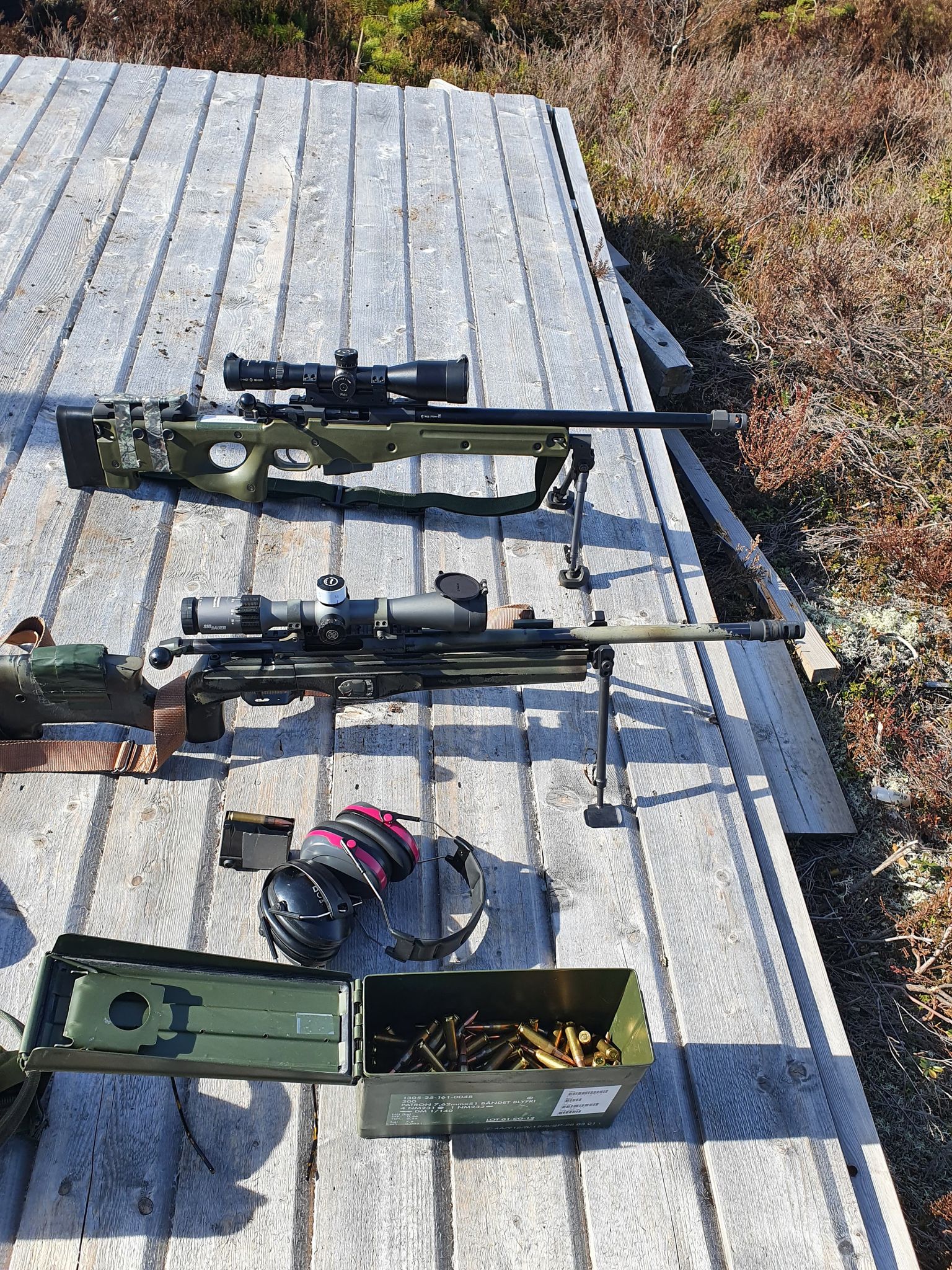

I've got both an AW and a TRG.
The TRG has been 100% reliable except some mag issues that was my fault. The AW has been 100% reliable as well.
I'd be happy with either one in a serious situation.
The ergonomics of the TRG are better than the AW (to me).
It's a coin toss. Both are awesome.

Both are absolutely reliable and accurate. The AI is heavier and has more support since 2014 with the barrel change system. The TRG has the best trigger I've ever used and would win if weight were a major consideration. The TRG accomplishes the job in a more simplistic manner and the AI has the ultimate cool factor. The AI does have the factory folder and a better magazine IMO.
