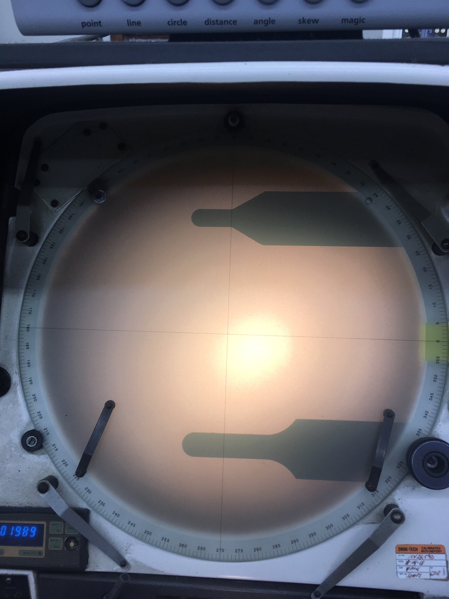

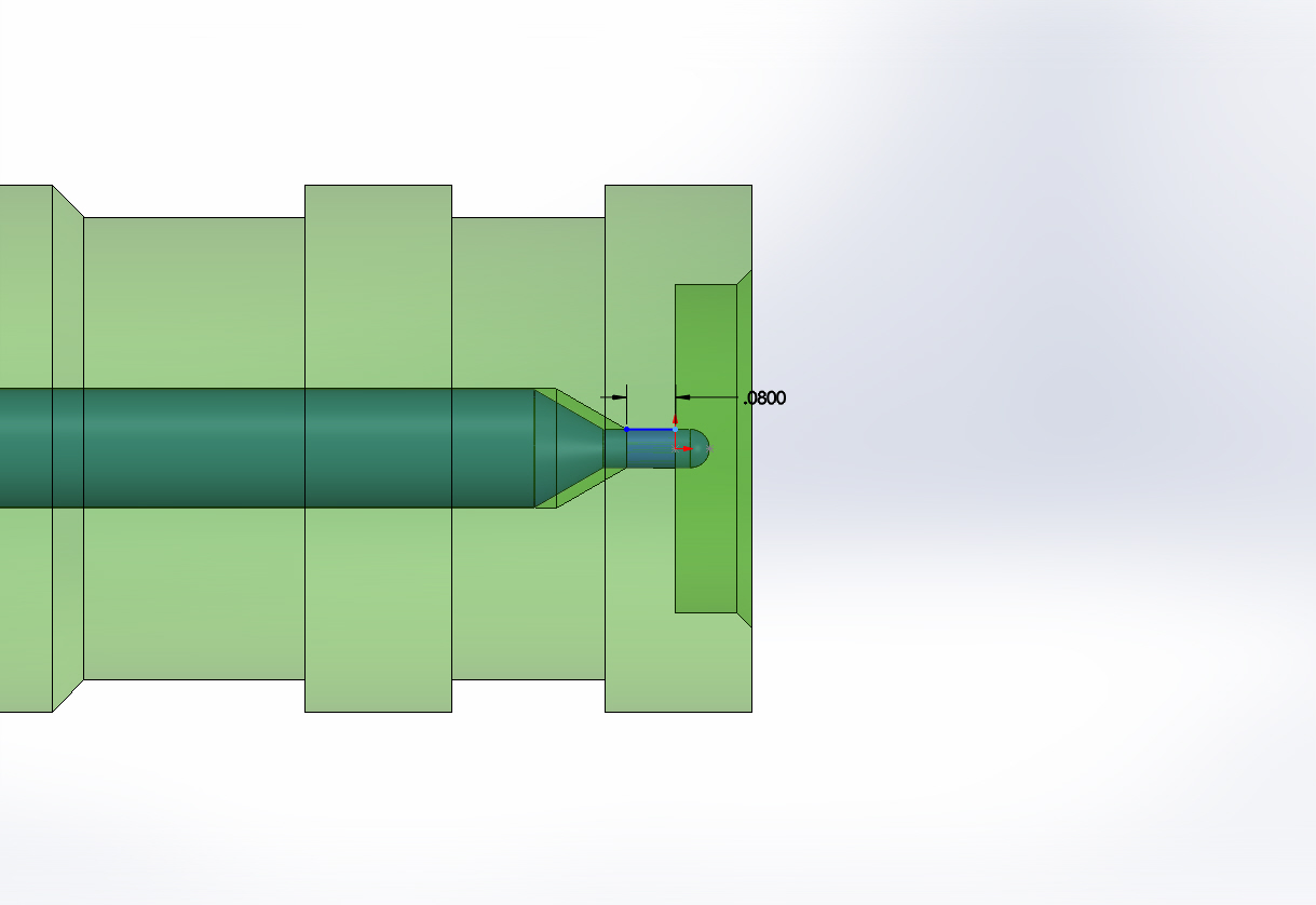

    Below is a solid model of the new striker pin/bolt head assembly. New pins with the .0625" dia are much shorter in length than the old ones. The new bolts are made to suit this. Older bolts however are not. Attempting to bush an old bolt to accept a new pin doesn't work because the threaded insert will prevent the striker pin from traveling forward enough for the required .052" of pin protrusion above the bolt face. This photo of the two pins on our optical comparator shows the differences in the projected length.
    (approximately

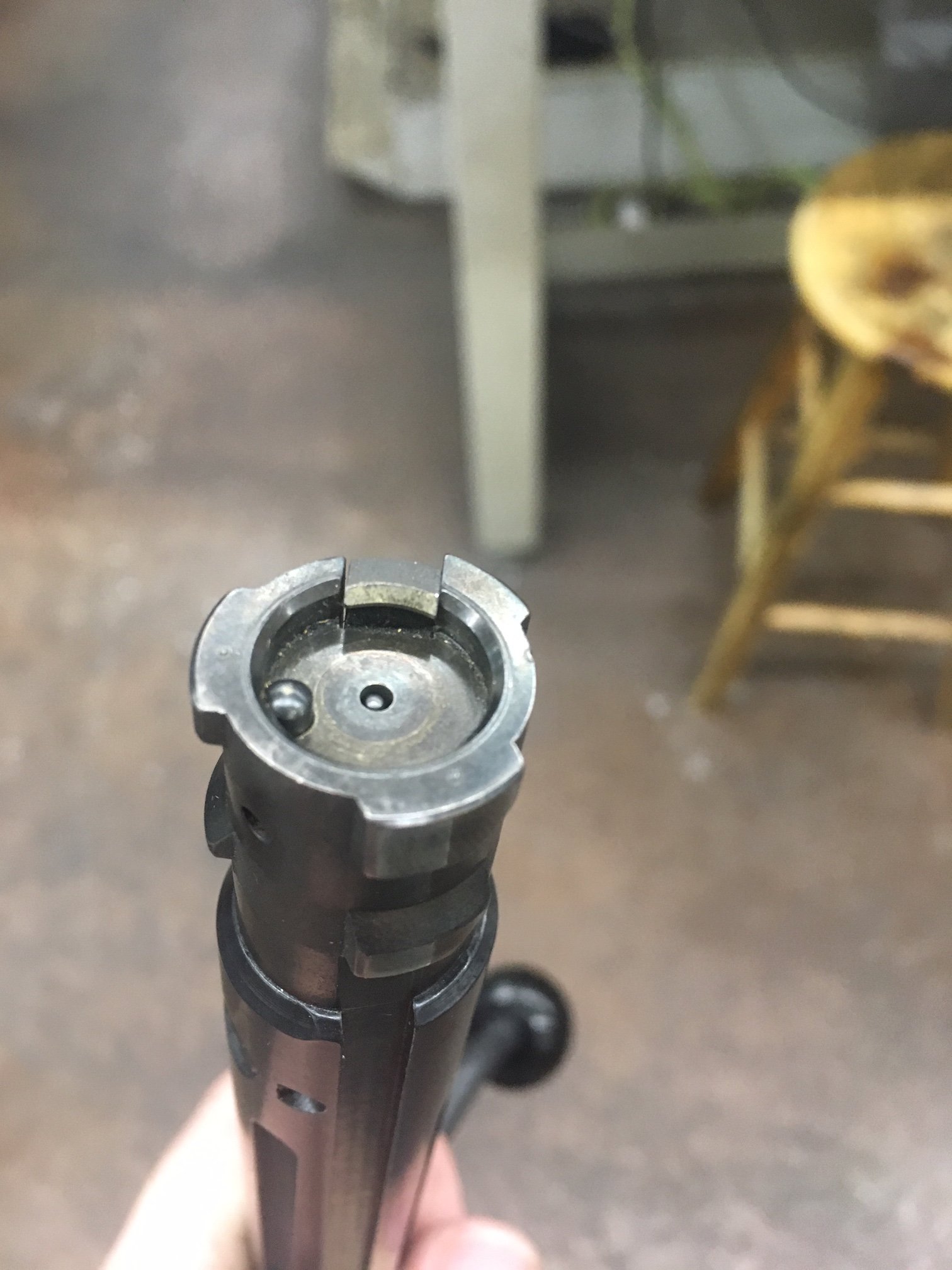

    New striker installed in old bolt. Striker pin tip is below the bolt face.
    If we were to attempt to shorten the threaded insert, you end up with almost no engagement in the bolt body. The distance from the face of the bolt to the 60* countersink on the inside is less than 3/32" in length. .08" is not nearly enough thread engagement for the insert.
