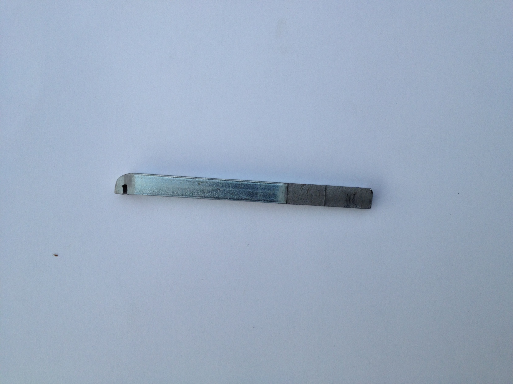

Make a tool like this to bend magazine lips, this one I made for tuning High Standard magazines, but will work on a mags. The slot is .030
