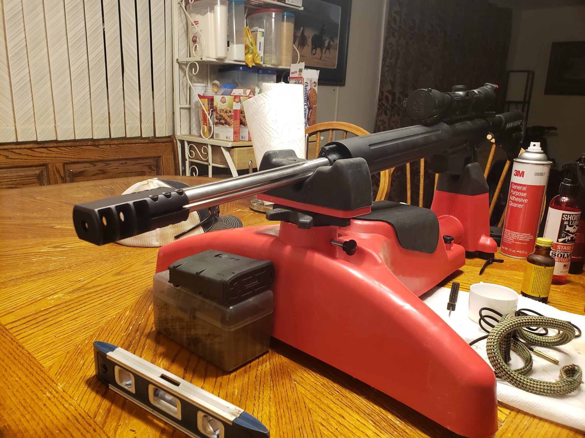

Ive got the jp scs, kahntrol brake and adj gas block on mine, shoots better than my 223. Mines got the 24in barrel and it likes 168gr amax's. Im working up a new load with 168 gr bthp's and win748. Usual is varget or 4064
