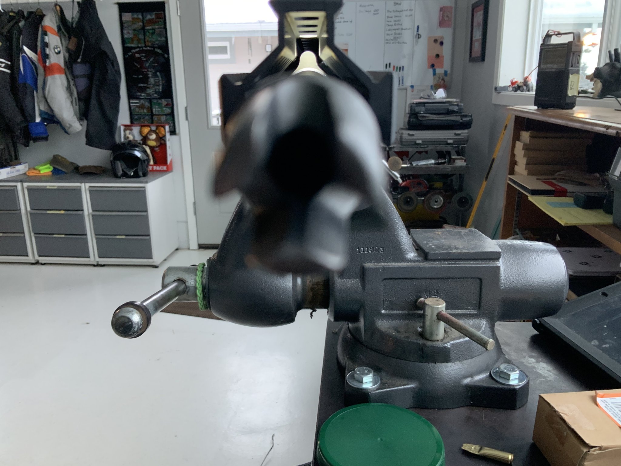

I’m using a Geissele slim hand guard and a LaRue low profile gas block. I had the guard off yesterday and couldn’t see any contact points. Some gas escapes where the gas tube enters the gas block and I noticed a scorched mark on the inside of the rail but no signs of contact.
