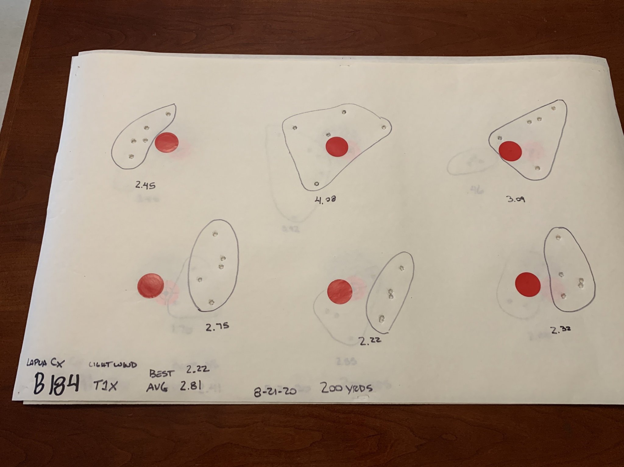

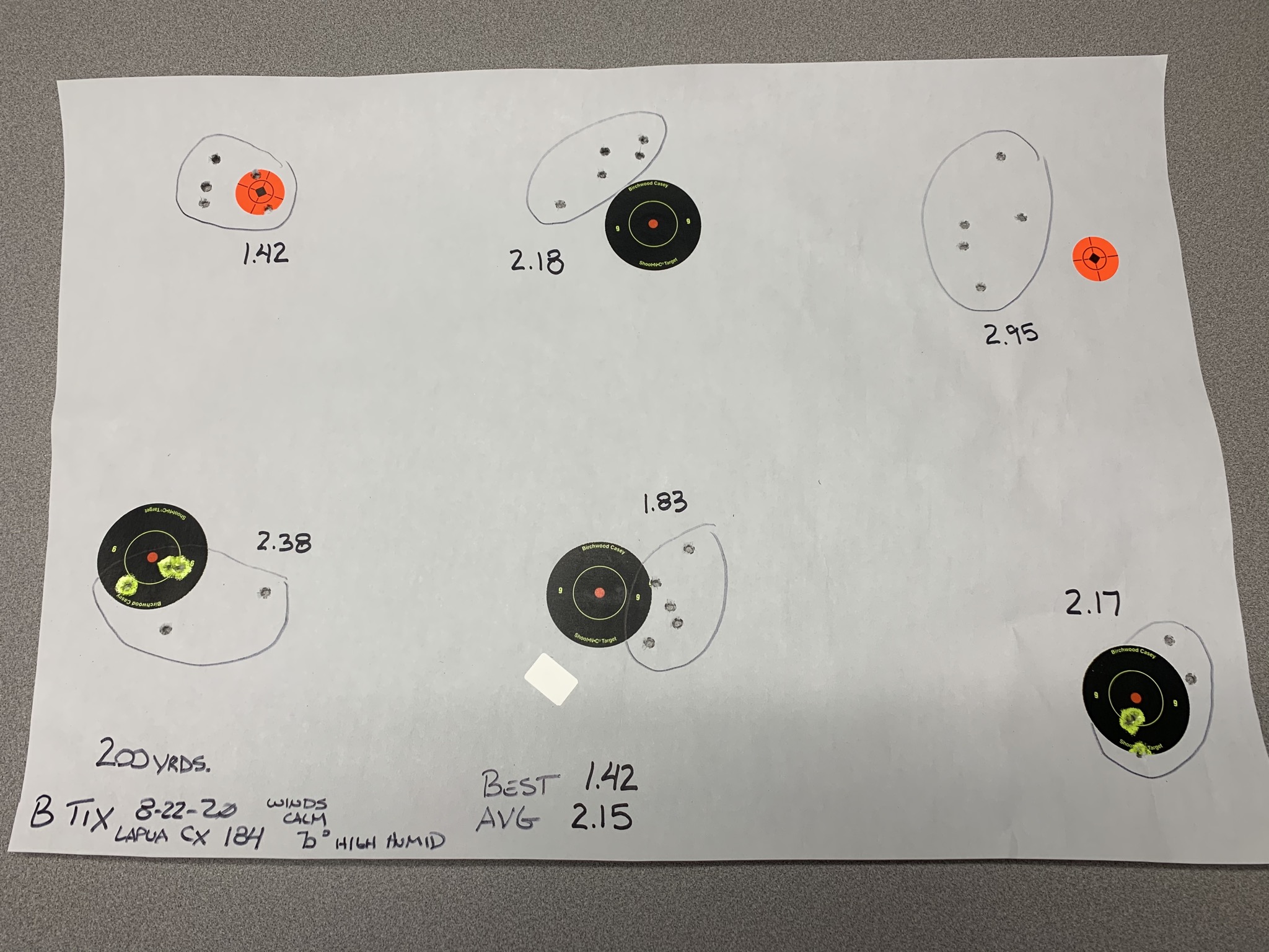

for me I decided to try lot testing various brands at 200 yards to see how things went. This is what I have had to do with my centerfire as well. I’ve found that any closer distance than this is just not able to show a lot of distinction between brands and lots. Again this has been my experience.
So far ive tried
Lapua CenterX ( 2 diff lots)
SK std+
SK RM
Wolf MT ( Eley)
CCI std
once I get the 1000rounds thru the gun that Lapua requires I’ll be lot testing at their facility.
until then my 2 lots of CenterX are doing very well at 200.

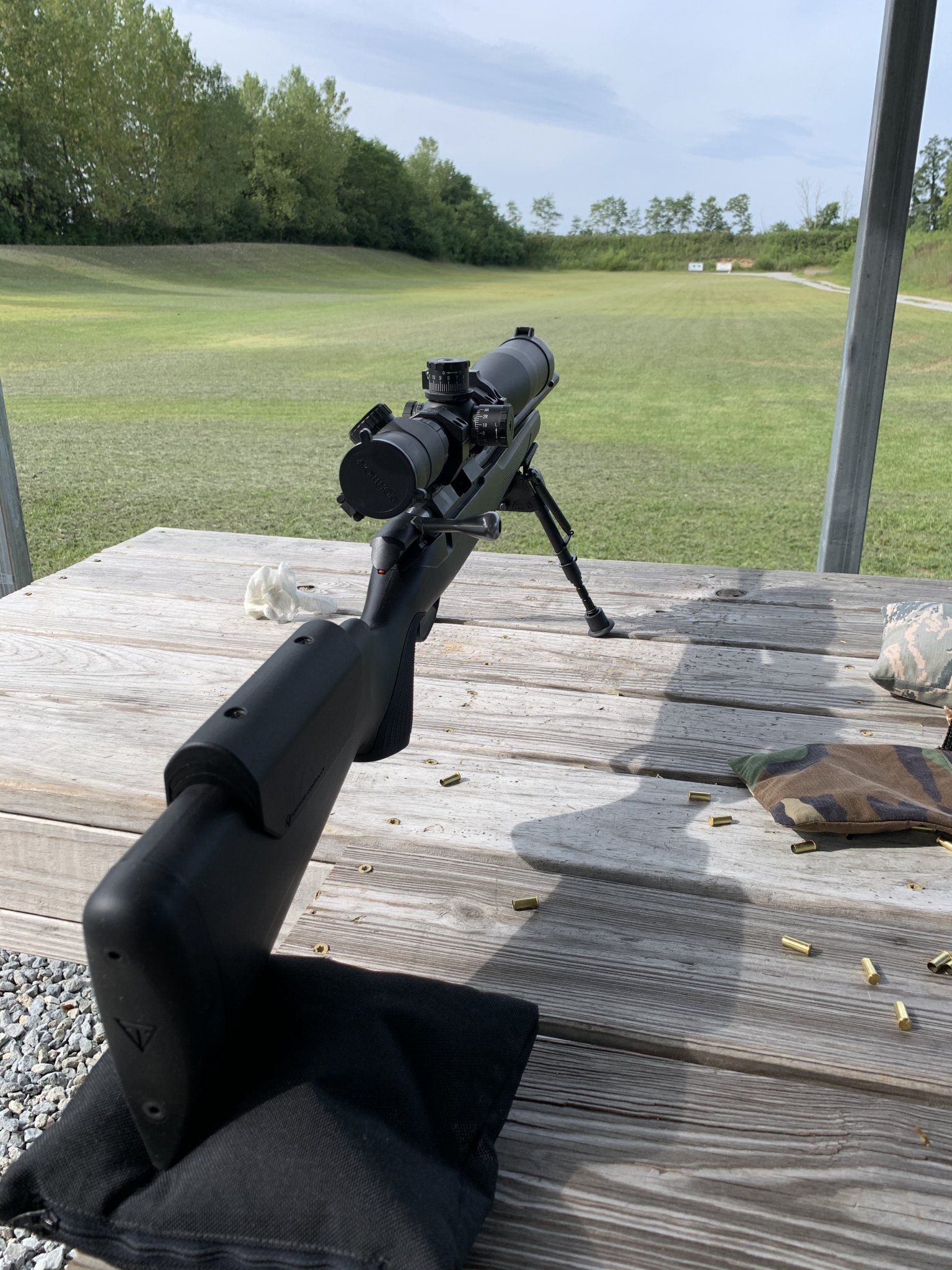

545rf...we need pics....lotsa pics!
Rifle, setup, looking down range and results.
Rifle pron is important around here.
You know the rule...without pics, it didn't happen. :D
Add them to the rimfire at 200 thread.

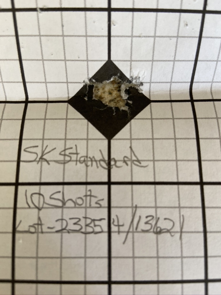

I got a call in for a few cases of that lot of SK+ if they can find it. The same gun shot a .295 6x5 at 50. My other Bergara did .367 and my CZ PV did .365. I figured if all three could do 6x5s at 50 with those numbers it was a good lot.
Thats impressive with SK Std+ , wish I could find some that good.
