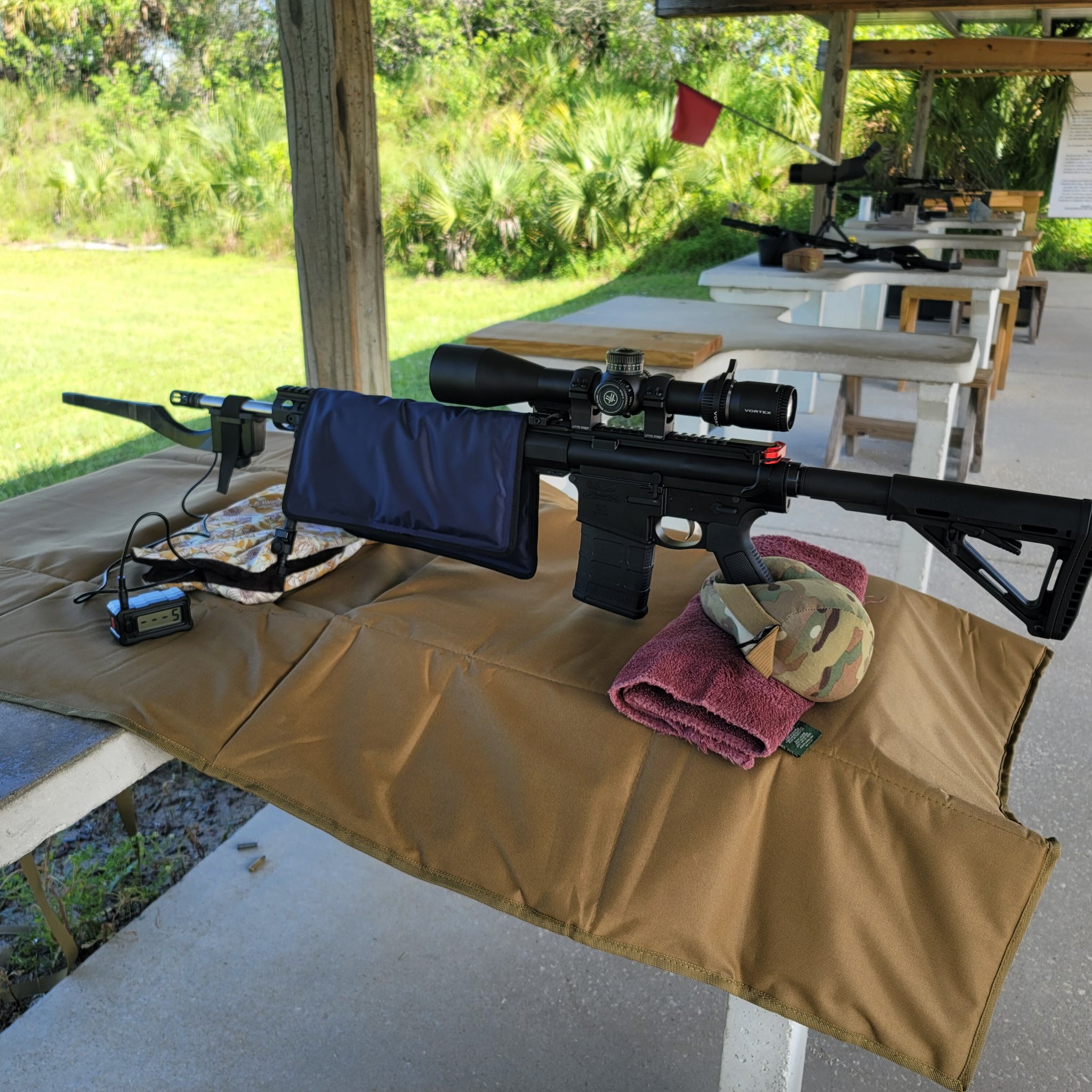

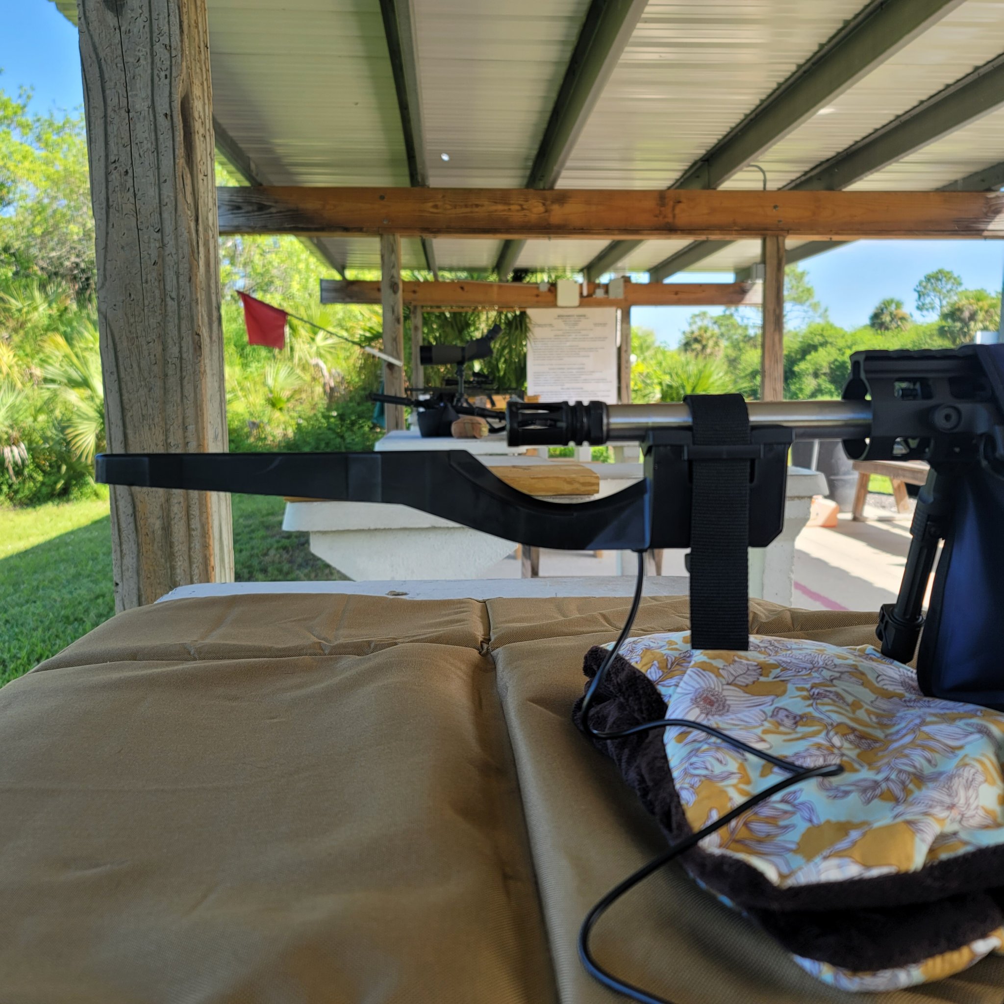

Update - I went back to the same Range 2 days ago (Aug 18th) and shot 10 rounds of S&B 140 Gr FMJ without Chronograph then let barrel cool and shot 10 rounds of S&B 140 Gr FMJ with Chronograph. I had to adjust Scope's Elevation down 2 1/4 MOA (4 1/2" @ 200 yards) once Chronograph was attached in order to achieve same POI. I even changed out the Chronograph spacer (to thicker barrel spacer) thinking my bullet may be traveling a bit close to Chronograph but that didn't change anything. I'm so baffled it hurts - I can understand a small change in POI but not 2 1/4 MOA. Note: I cinched the Chronograph down pretty tight to ensure it wasn't moving between shots.

If you'd like more robustness and adjustability, I've sold thousands of my "Magneto Mounts", and offer a discount to hide members:
As mentioned above, you've attached a weight to your barrel, altering the harmonics of it. You will absolutely have potential POI and accuracy shift, and the mount of your choice will pay for itself in ammunition gathering more data/practice rather than solely velocity.
