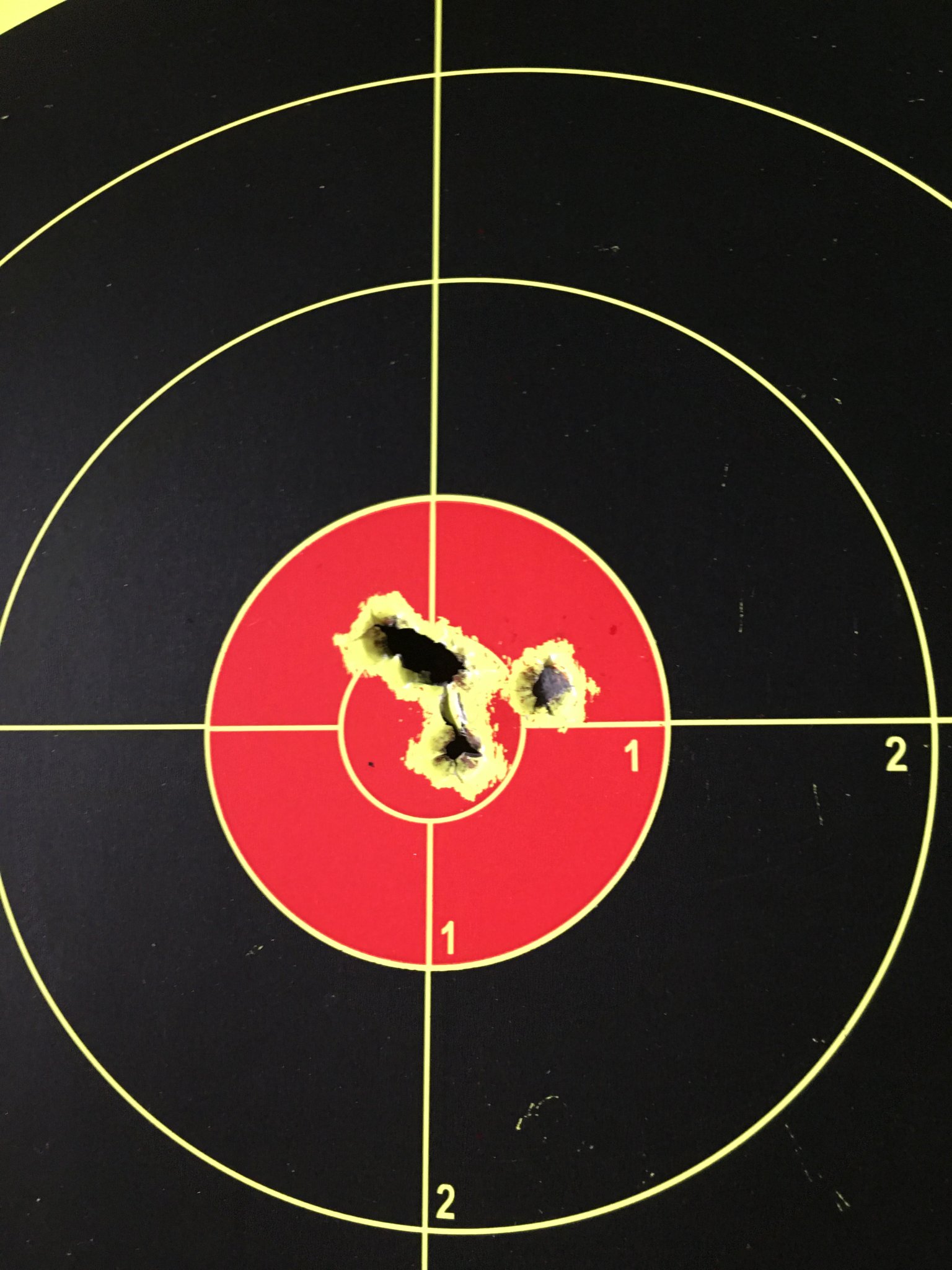

So went to Range yesterday and went to shoot my 6.5x47 at 300 yards . First shot hit bull and subsequent shots went in about a 5-6 in group . WTF ? Last time this gun was shot it was doing 1” at 300 . It was cold so instead of screwing with it I brought out my 6br . First 4 shots were 4-5 inches around the bull . WTF again . I usually shoot free recoil but I was in a panic so I thought maybe I’ll lean into rifle and see what happens . All of a sudden I’m doing 1” groups again . Get the 6.5x47 out again , lean into it and I’m still all over the place . Get 6br back out and with my normal free recoil I’m doing less than an inch again . Now I’m really confused . Both guns are off bench , bald eagle front rest and heavy flat top rear protektor . So then I bring out another 6br but with tactical bipod and I’m shooting half inch groups at 300 . I’m lost ! What do u guys think ? Something loose ?
Thx
Mark

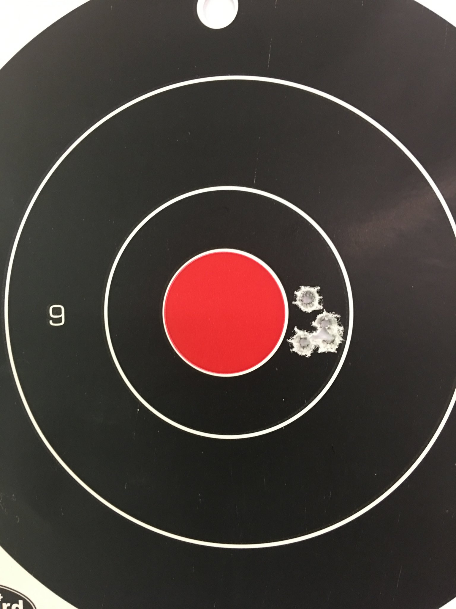

This is what’s telling me it was the rest . This 4 shot group is with the tactical 6br and bipod off the bench . I shot this directly after shooting my 6” groups off the rest . 4 shots that measure .5 .

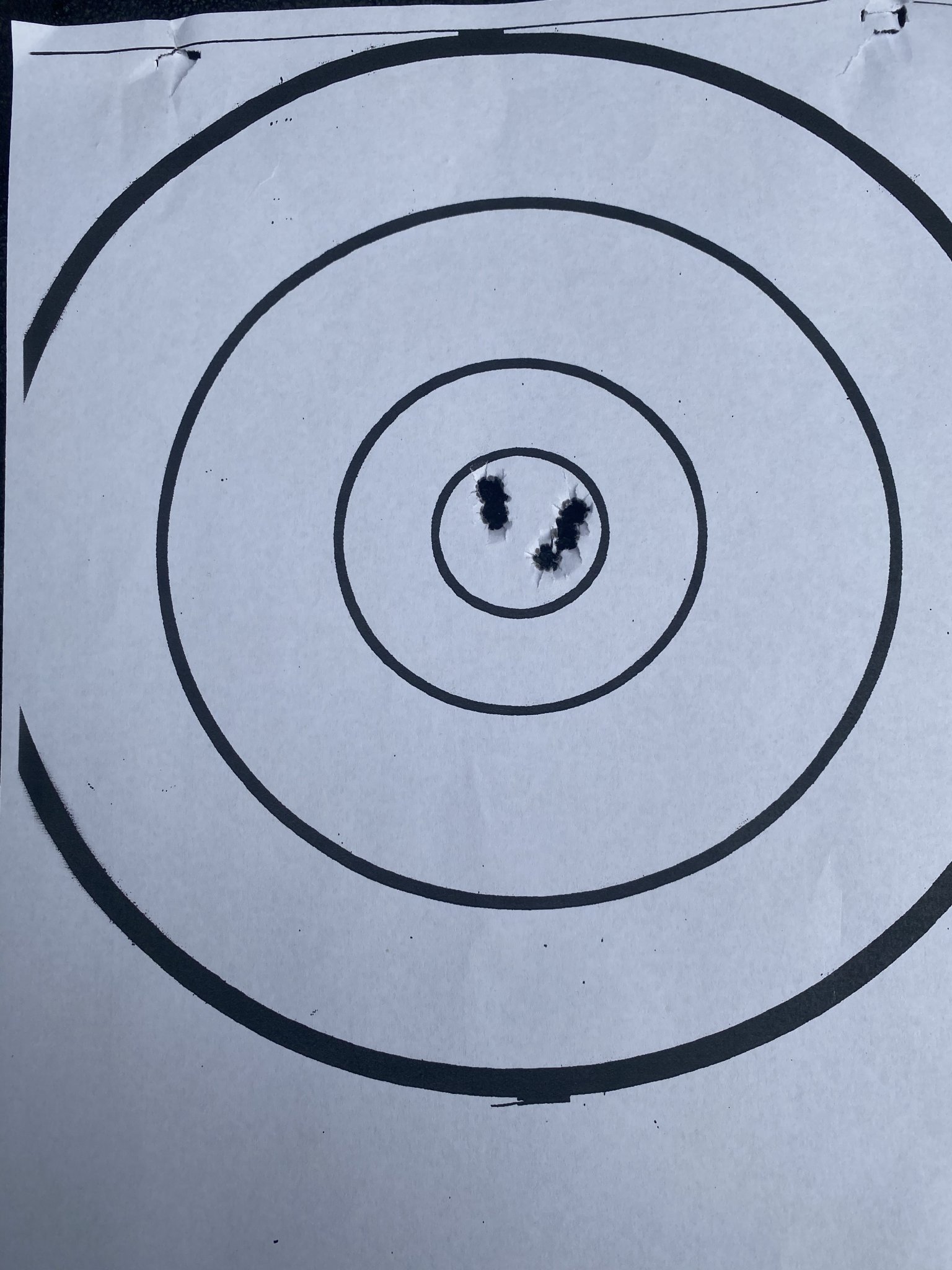

Ok ! I still suck . Didn’t suck as bad as 2 weeks ago , but still suck . I have another idea what’s going on . I normally shoot free recoil and I think I’m not paying attention and feathering rifle a little too much . Here is a 5 shot 300 yard group from when I first got the 6.5x47 . I have to get back there somehow .
