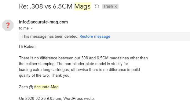

Just got off the phone with Mark at Accurate Mag and he said there is ZERO difference between the .308 binderless mags and the 6.5 Creedmoor mags. He said they just stamp 6.5 on the mags because some OEMs requested it. I asked specifically about feed lips and followers and he said again, "Zero Difference"

Here's what Accurate Mag said when I asked this specific question recently.

Apparently I was mistaken and they’re both mechanically identical.
I’ll even admit to getting a bit too passionate over something I thought I was right about.
