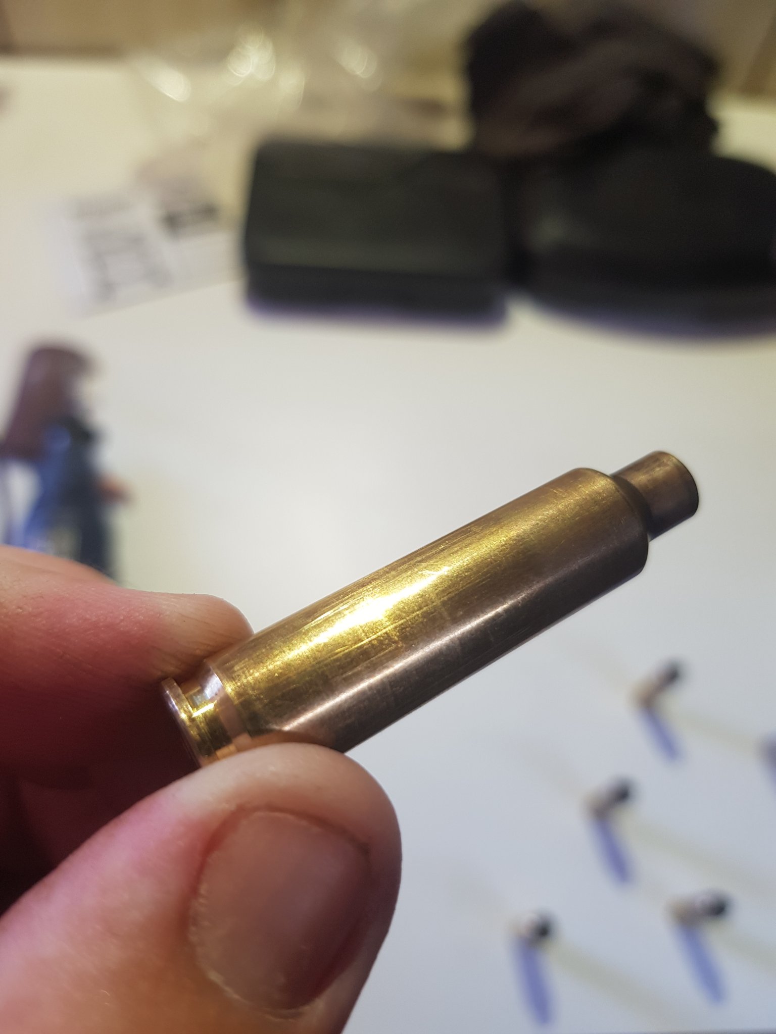

    Evening Gents
    Any of you on here who use the AICS Accurate Mags notice it scratches the absolute hell out of your brass?
    Im using Lapua 260 brass in my 260 AI and just wondering if anyone out there knows of a remedy to stop them big nasty scratches.

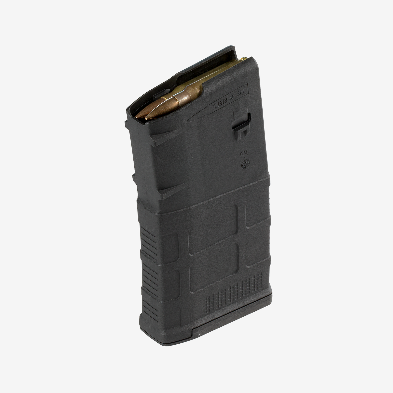

    Bought a MDT 10 rounder, fed beautifully and no scratches straight out of the packaging. Way better mag in this case, but maybe i got lucky or was unlucky with the Accurate mag.

    Somehow Magpul mags seem to not be what the cool kids use. I've heard all kinds of bullshit as to why not.
    I've rested the rifle on them, pushed them into barricades, pulled back on them, rifle still feeds just fine. They work in ARs and Glocks but not in AICS-pattern chassis? GTFO.

    I have tried the Magpul mags. I had to do a fair bit of file work and add some material to the rear to get them to feed reliably (I did get them to work, however). Feed lip tuning is a thing on metal AICS pattern mags but once tuned mine run great (both AICS and MDT).

    Magpul Pmags are injection molded plastic. Once the process specifics are nailed down (and they have been) each magazine will be pretty much identical one to the next.

    He means the LR/SR pmag that existed first for ARs. The RPR can use them in addition to the aics model, they just have a shorter max length suited for factory ammo.

    I guess I’m a unicorn that had shit for luck trying to get Magpul AICS magazines to feed in my rifle. Tried 2 different 10 round magazines...and one 5 round magazine
    I got the 5 round to feed “ok”...but both 10 round magazines were an absolute shit show. I think it was a lack of spring tension causing my issues...just flinging rounds out by hand, I had horribly inconsistent cartridge “seating angles” with the top round in the magazine. Some would be level, some nose down, some nose up...all depended on how many rounds were in the magazine

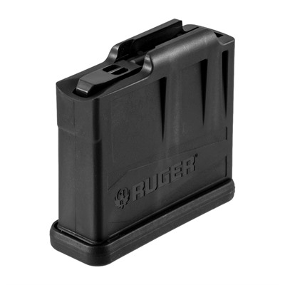

    I finally gave up on them. I use the Ruger branded steel Accurate Mag and ARC magazine now. Once I tuned and polished the feed lips I haven’t had any issues.
    The Magpul AICS mags put a really bad taste in my mouth to the point I avoid polymer AICS magazines at all costs now

    Evening Gents

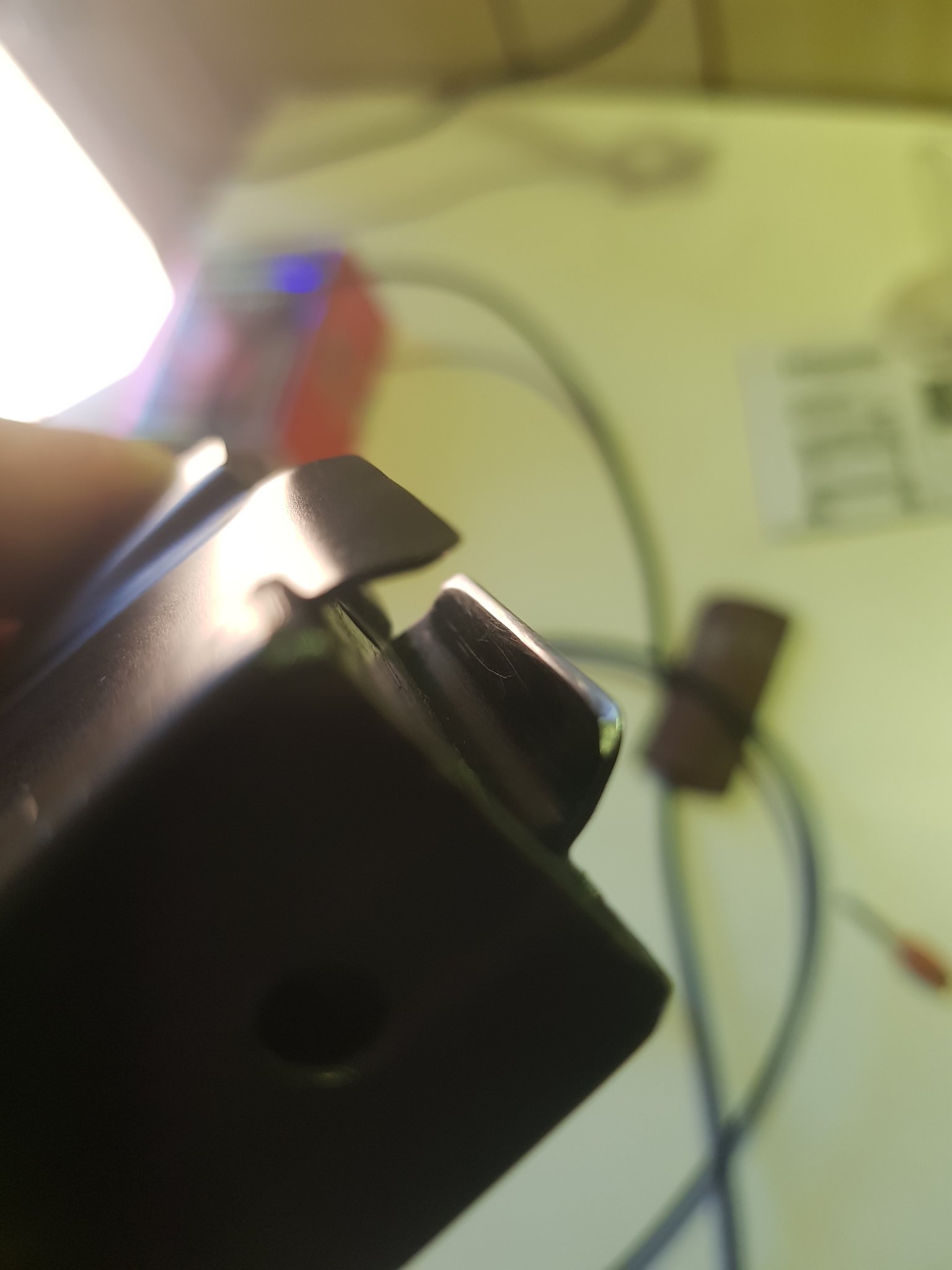

    No I havent touched the feed lips at all apart from some sanding today.
    Using 240 Grit paper at the moment, will try and get ahold of some finer grit/emery paper tomorrow and try and get it really smooth and hopefully no more nasty scratches on my brass.
    Thanks to everyone who has posted, have learned quite abit about the world of magazines! Been a great read

    Just received three .308 Accurate mags, all of them had sharp edges. Took 800 grit sandpaper and smoothed them down. Seems to be ok now.

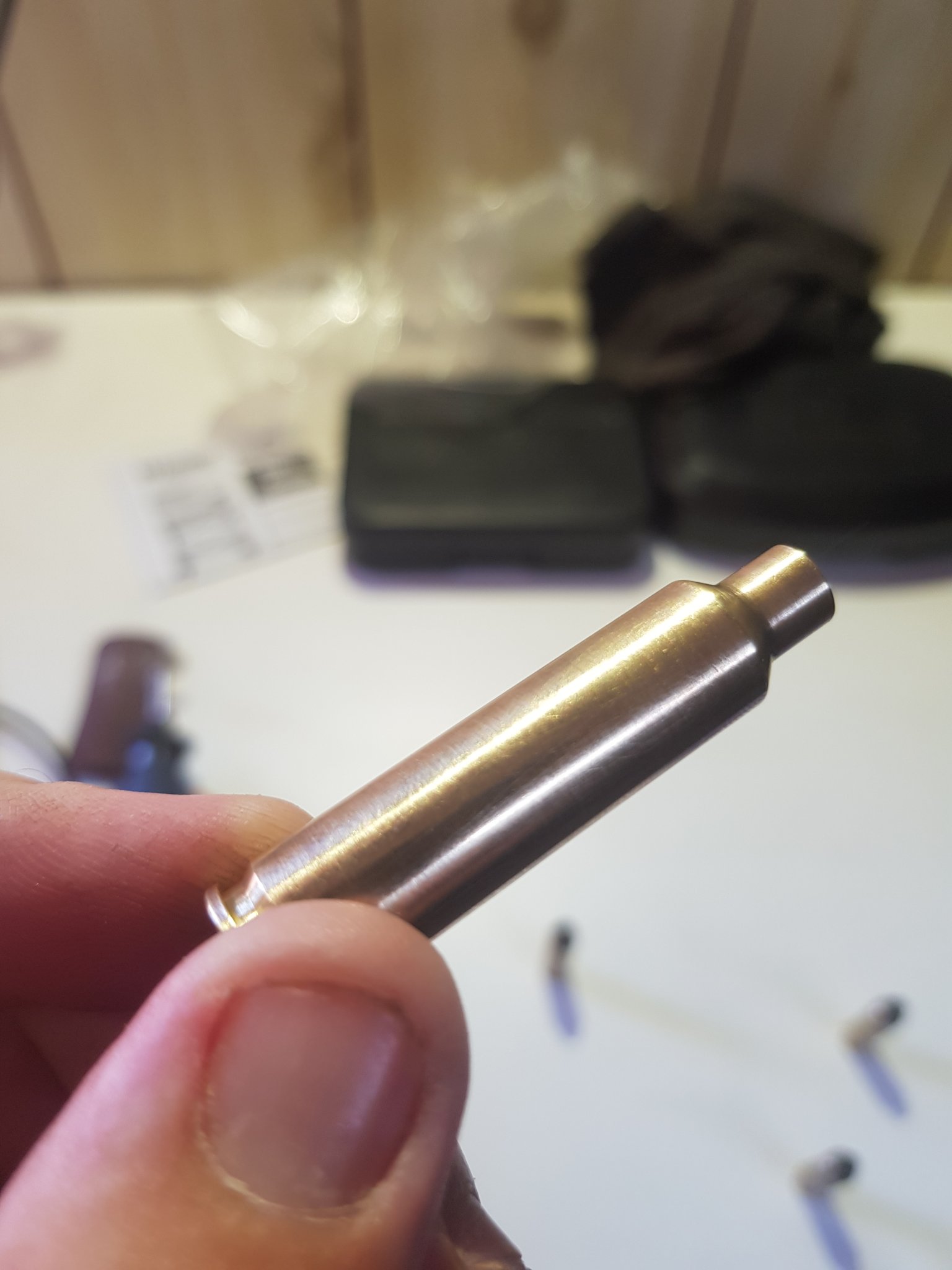

    I ended up getting some polishing wheels on my dremel and polished up the lips after the initial sanding.
    Now all I get on the brass are surface scratches that if you twist the case in some fine steel wool dissapear so im guessing it shouldn't cause any damage to the case? Have attached picture of magazine lips, brass case after being fed and brass case after being touched with the steel wool.
