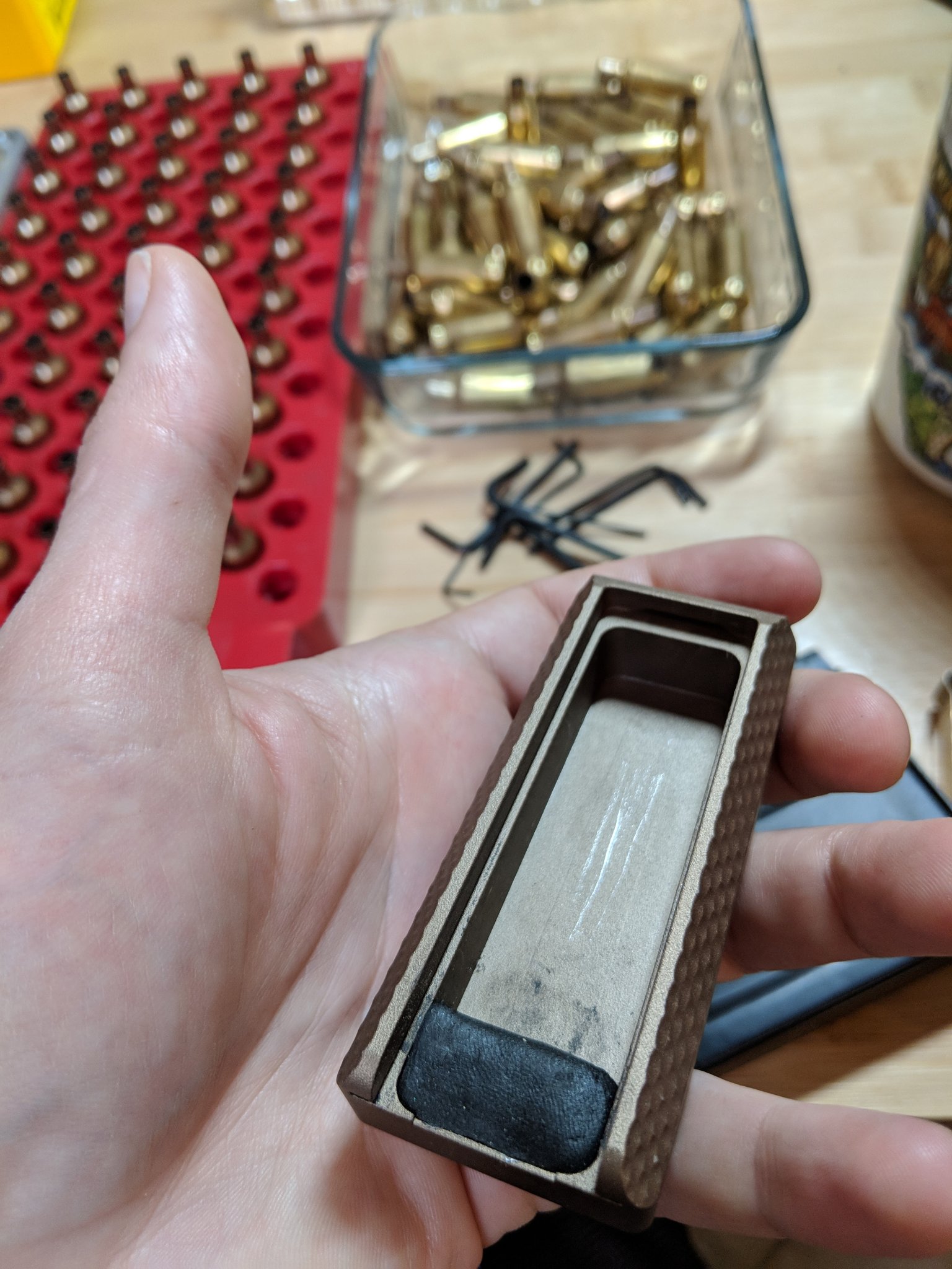

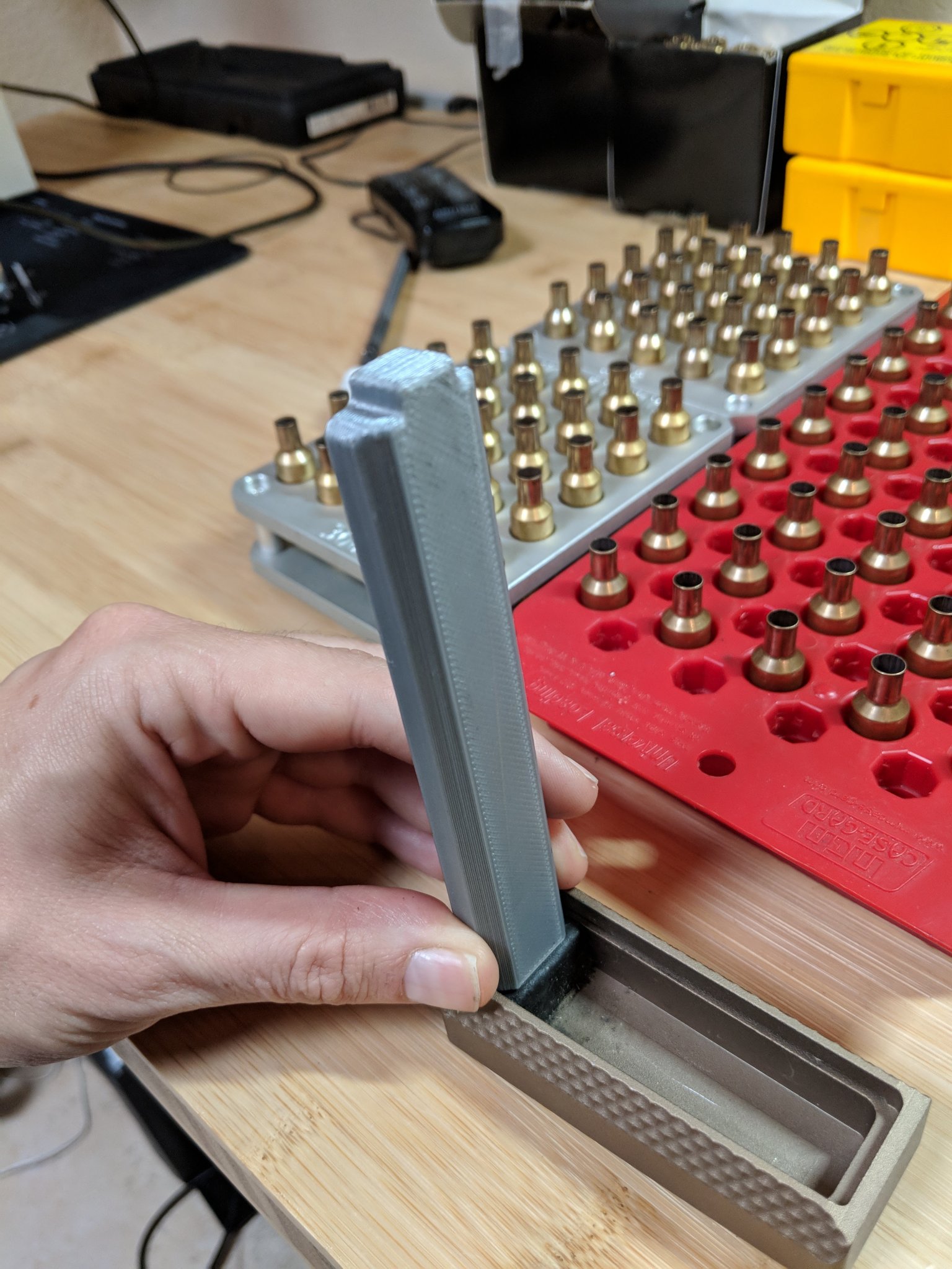

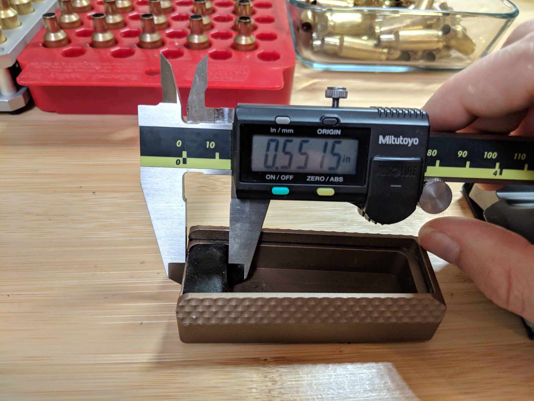

Use something like "Sugru" to build a shelf on the bottom of the extension for the spacer to sit on.
I used Sugru for AICS mags, Primal Rights spacer/6BR kit and Seekins +4 extensions, worked good.
Reactions: Bertoli888
Sugru is a moldable glue. It starts off as a material that is "putty" like in consistency, and cures over 24 hours to something that's rock hard. It's very easy to work with. You can buy it from Amazon or any big chain store.
Here's the "shelf" I made with Sugru:
