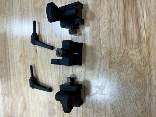

Alright so i just got a good trade on an accutac br-4 G2 so i had to jump on it. going on an sr25. My problem is I don't have any ARCA plates. I don't really want to just have an arca plate mounted to the bottom of my rail all the time for when I want to QD the bipod. Ideally, I would have a small picatinny section at the end of the rail and just take the bipod on and off as I please and leave the picatinny there (but obv id need the picatinny version of the accutac for that).
Anyone have any good solutions or want to trade for their picatinny compatible accutac?
Trying to avoid buying an mlok to arca adapter to leave on my rifle especially because I am a poor now (hence the sr25) but I will if I have to and ready to take suggestions on what piece to get.
also, if you want to convince me to be an arca person now I'm all ears I just think having a huge arca section on a sr25 would be ugly. Feel free to convince me otherwise.

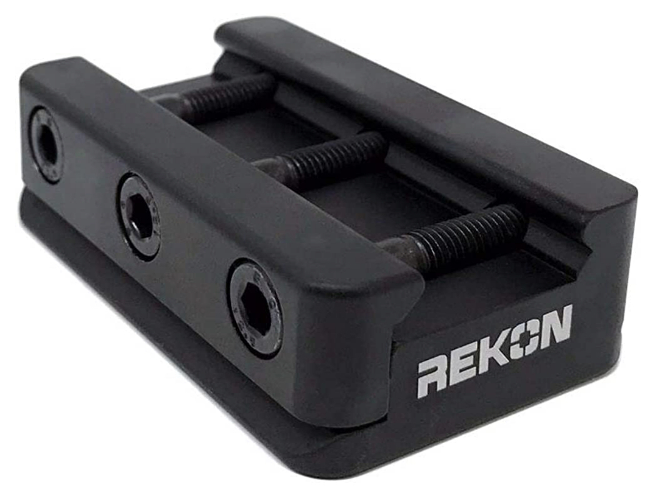

Ok, this is your bipod? https://accu-tac.com/products/br-4-g2-arca-spec-qd-bipod
This is sort of tough.
If you add a short section of pic rail to your MLOK handguard…
Then you need a pic rail clamp that you can attach an Arca plate onto its bottom.
  1. Gun
  2. Pic rail via MLOK
  3. RRS SC-ARC clamp (or that ADM one)
  4. Arca plate with 17s interface (no idea if this exists, might bubba one together with this + any old Arca plate)
  5. Your bipod’s Arca clamp
Here are some random parts that you may cobble some other ideas together.
RRS SC-DUO
Double Arca plate
The most elegant solution would be a quick release pic-to-Arca clamp. But have never seen one. Like the unit below but QR.
But at the end of the day, you’re going to better off either getting the pic clamp version of that bipod (maybe they sell just that part?) or selling it and getting a different bipod.
Here are some other bits and bobs.
This thing is what would work without futzing. But it’s made in Czech:
Also, Magpul makes an interesting little clamp.
I’m out of ideas. If you don’t want to spend $80…sell or trade it away.
