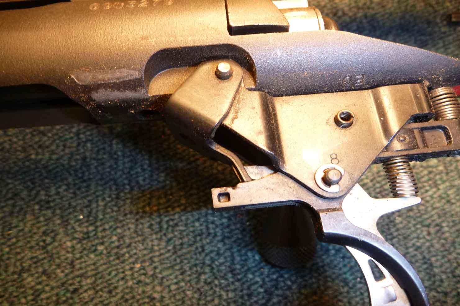

The picture below is what I found when I pulled the action out.
I went back re checked some things. With my handy dandy RCBS trigger gauge I found the trigger weight was at 1.75 lbs. I brake cleaned the sear engagement and cleaned every thing else up too. I re set the weight to about 2.245 lbs and put it all back together. I was pretty thrilled I was able to find that little adjusting tool.
I'll do some dry firing and beat up a little bit to see if it will lock up again. At 1.75 lbs it doesn't seem like thats to light.

hard to tell for sure but from the pic
your trigger looks like the edge the sear rest on is not square
-at least the edge of it
Ive had a t's that wouldn't hold 3 lb sping weight
then square up the angles - then I could easily get down to 1 lb
they are a good trigger -but if your not a tinkerer - just replace it
