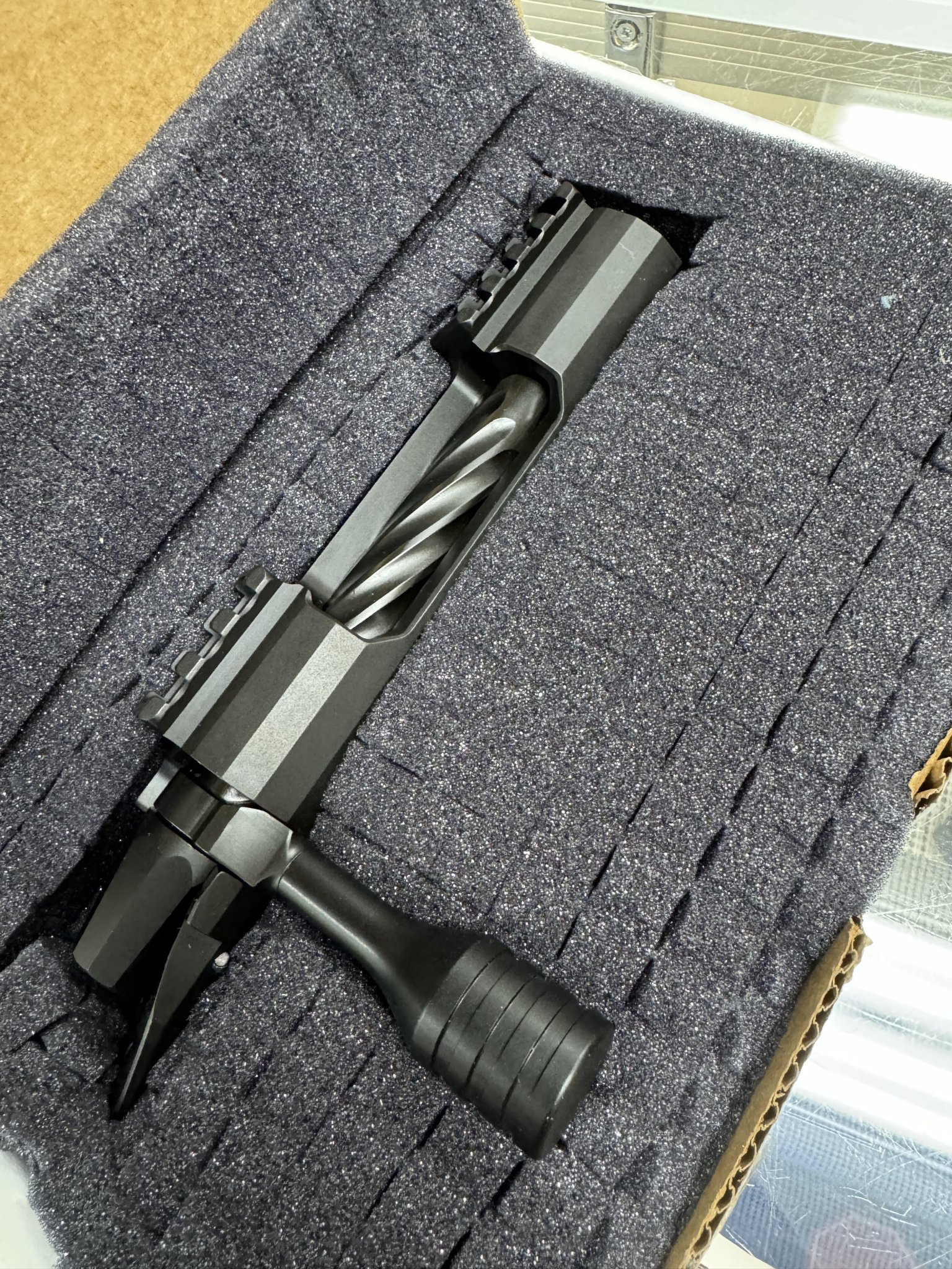

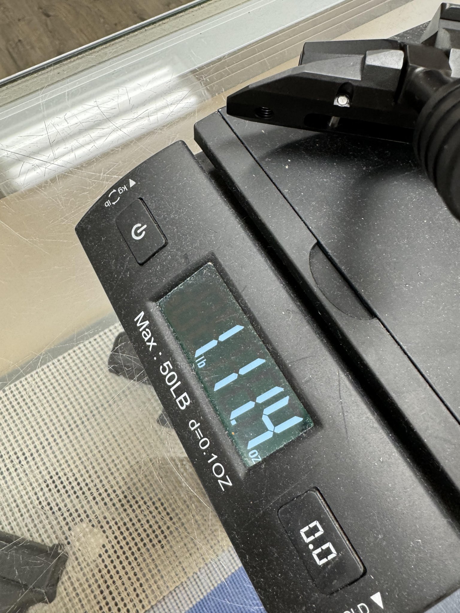

Just did my paperwork for this new beauty. SA Lone Peak Fuzion Alpine Cut (steel). Only 27.4oz with the magnum bolt. This is going to be a fun build for a 6.5 PRC with Barltein Carbon Fiber Barrel in a Manners PRS-TCS stock.
Really impressed and can’t wait for the dumb WA 10 day waiting period so I can pick it up.
