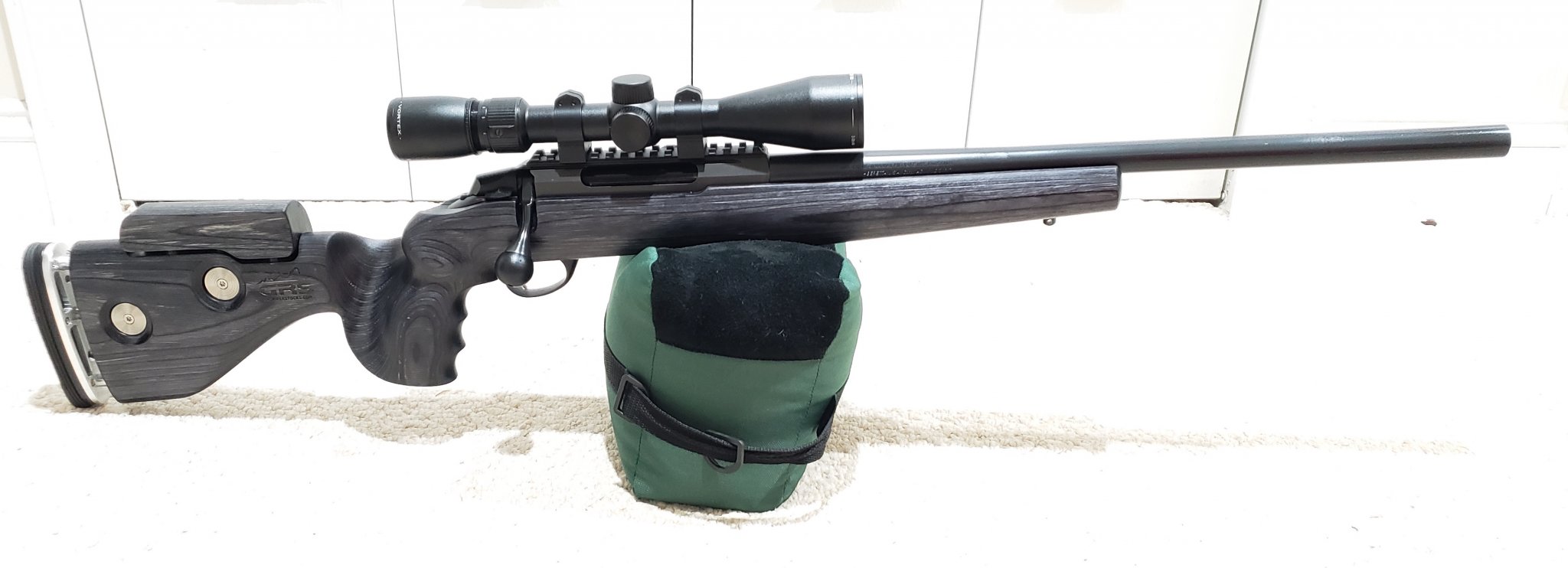

In the end I decided that since I'm such a fan of Tikka rifles, and they provide me almost everything I'm looking for, why not build something custom off that? So I can get a completely custom rifle for roughly $1,500 instead of spending the same for just the action, or maybe the action and trigger. Not saying you should go this route, just that these super-expensive actions are not required to build a beautiful, high accuracy rifle.
Picture below is of my "Tikka" T3 action, Criterion 18" 7mm-08 nitride barrel (threaded) with custom contour (close to a medium Palma), 1.5 pound factory trigger, GRS laminate stock (that I got on sale for 50% off), Zeiss Victory HT scope. Cerakote work and bolt fluting done by LRI.
HTH
-Stooxie

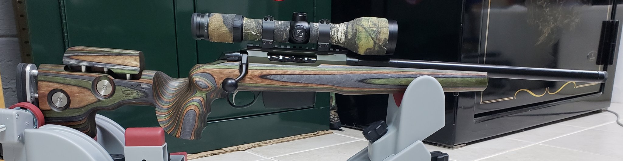

Just for the "marketing" message bit, the rifle pictured below is a sub 1/3 MOA all day rifle, with AE GTV 223 or Hornady AG HP 223 ammo. It's a bone stock T3 Scout (a limited run from 2010-2012 with crazy heavy 20" barrel, heavier than the CTR). I added the light trigger spring and bedded the action myself in a GRS stock. Total price: $1,300 for everything but the scope.
It's just not true that you need to spend thousands of dollars to get what you're looking for. Just have to pick and choose the right components.
That said, if I had the cash would I be buying these expensive actions. Probably! :LOL: I like cool toys as much as anyone!
-Stooxie
