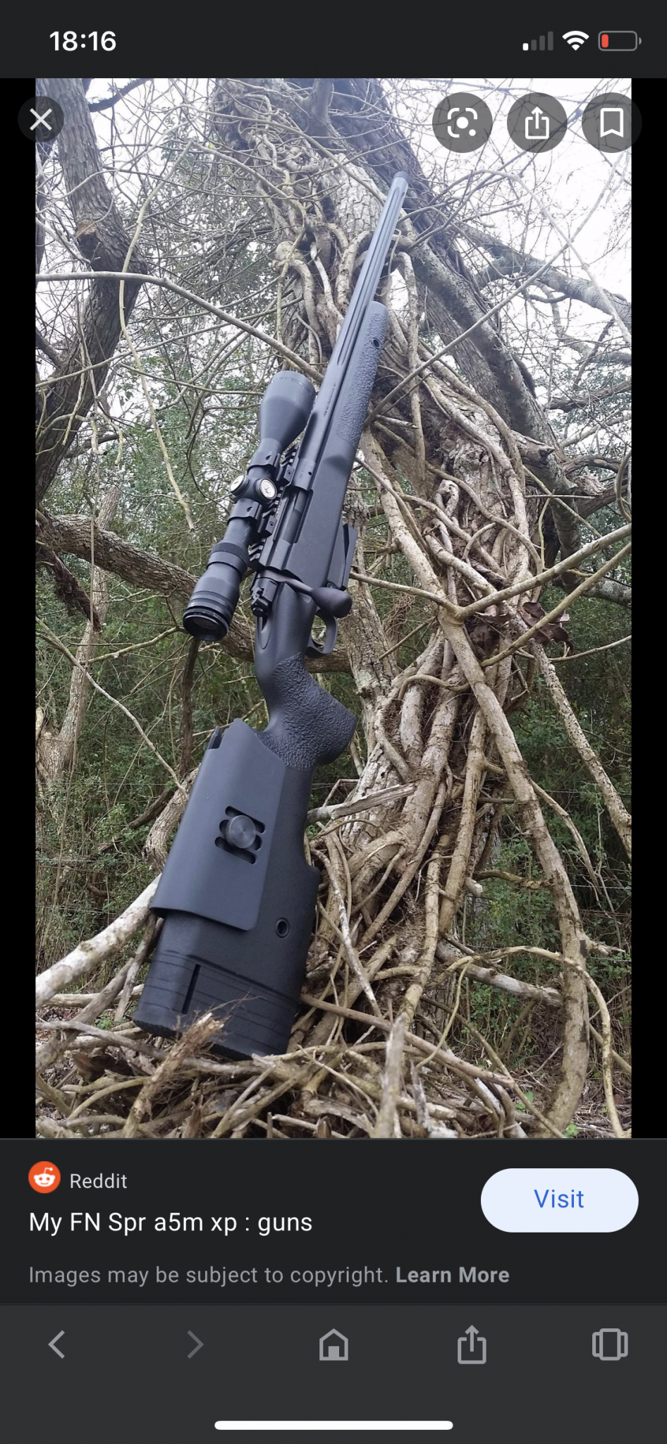

    Picking up an fn spr A5. Model has the detach mag bottom metal.
    What are you guys running on these models for action screw torque?
    My research so far shows 55 inch lbs. Some say 65 but not sure if the stock spot bedding on the tang and by the lug will handle that or not
    I’m planning to take stock and scope base off. Base will be retorqued to 20 in lbs and stock to 55 in lbs unless I hear different from you guys. Never used a McMillan or stock without a full aluminum block in it
    Want a set torque value so when I remove stock in future I can return to same when reinstalling. I know full bedding would be best but looking to test in factory configuration when I get the rifle to see how it shoots first
    Thanks in advance
    Not my pic but same rifle for reference
