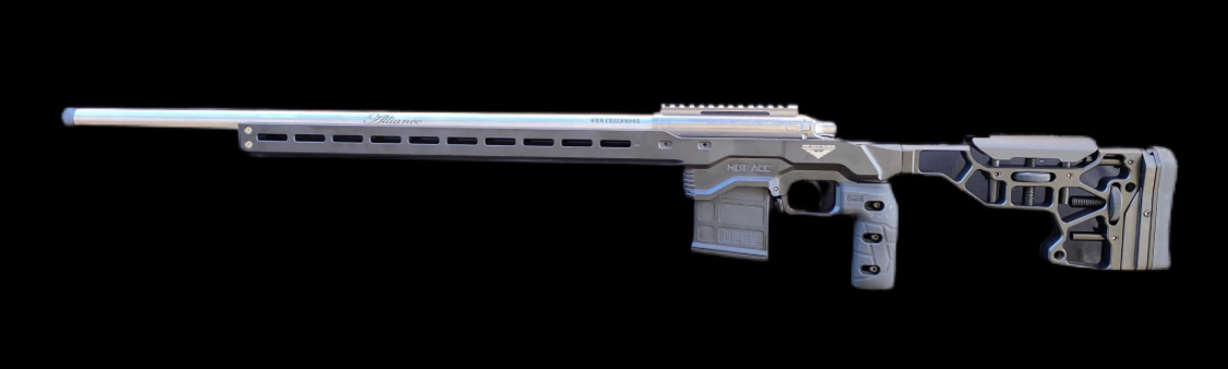

Actions options for an MDT ACC Elite Chassis (REM700/SA)
eprom
Nov 12, 2022
134
178
Ring0
I recently got a pretty good deal on a MDT ACC Elite Chassis for a Remington SA 700 action. Now I need the action and the barrel that goes with it. Problem is, in my country we are pretty limited regarding parts availability, and both the actions and the barrels are controlled-items which require a license and registration :mad:.
I'm inclined to do some smith job on this build, but I want to keep the chassis as-is, without alterations.
So far I have found two options:
1) Get an Area 419 Barrelled Action on a Deviant Tenacity Action.
2) Get a Zermatt TLR3 with a Prefit Savage (Short Shank) Barrel.
I have contacted Area 419 about option 1 and they said that everything if fully compatible; the barrelled action should drop-in without issues. Later I have found out that some people report issues with the bolt-stop (which would require inletting), that are in fact larger than most rem 700's.
Option 2 is probably the most cost-effective option for me, even with the TLR3. What do you guys think about it? A savage prefit barrel will do or I miss something? That would be my first semi-custom "build", that's why I need the guidance.
Been here before... ( I am in Italy so feeling almost the same pain as you if not more) I went with TL3 and no regrets. TL3, LP Fuzions and Impact 737 all open you the magic world of shouldered prefits, that even with the additional cost of Duties and EU burocracy are a far better kool-aid drink than anything else, provided that you would also get a barrel vise and the action wrench to do the barrel swap yourself.
Custom Actions are almost a lifetime investment and the US market is a pretty mature market where you can't really go wrong (or it's very hard to go wrong) if you stay with the 'big names' I mentioned before. If PRS is th intended use, make sure you have it AW-cut and not just AICS. Last tip, buy a decent set of spares (strikers, spring, bolt head if you would lik to add calibers to the standard .473 (.308) bolt face) just in case something breaks with use (never happened to me, but just in case it's a cheap insurance when in the field)
I have a TL3 and an ARC CDG in the making, and believe have all bases covered for present and future.
With a prefit-capable action you can then literally buy barrels from hundreds of smiths in the US, and factories like Proof for less than half the price of a chambered blank made in EU ( and my understanding CH isn't cheaper, btw)
Hope this helps
Post Scriptum: MDT Acc Elite here too, no fitting issues with either the TL3 or the CDG.
Reactions: eprom and Tx_Aggie
Hope this helps
Thanks for the suggestions, especially regarding the AW cut. I can also get an Origin action, shaving off a few hundreds bucks, but I will have to install the recoil lug accordingly, which is an additional step over the TL3.
So if I understand correctly, regarding the barrels. I can use an Origin with a prefit barrel OR I can use a TLR3 with a shouldered barell (not a prefit) and torque it to spec, in let's say a SAC custom barrel vice. The later option would be 1000 USD more, which is not insignificant.
As for the intended use, as far as I know, we have no PRS type matches here, which is a shame. However, we are a few crazies here that regularly practice a mix of positional and precision/target shooting, mostly at 300 meters. That's not PRS or NRL for sure, but we have to start somewhere.

Read it again. You aren’t using a stock. The acc is a chassis. It’ll clear by miles.
Pic stolen from Deep South tactical
The waterline of the ACC Elite chassis is very low and the bolt handle cutout is very roomy, any popular round bottom 700 clone should drop in.
