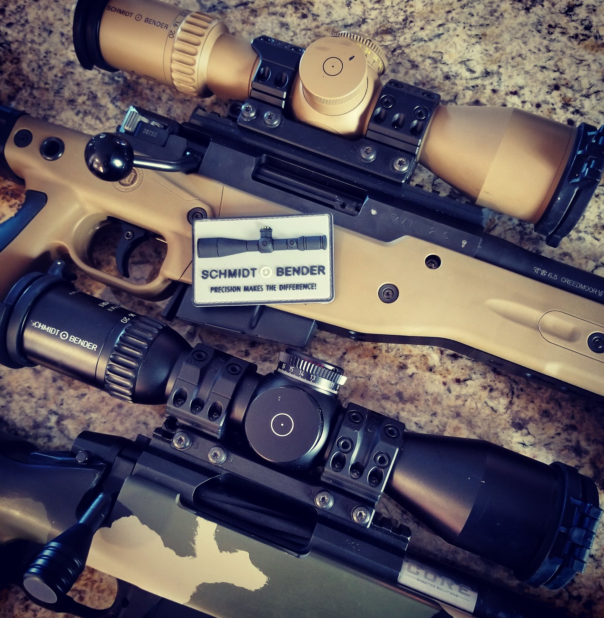

I have a McMillan hunting stock on order and it’s too late to change the inlet. I told them TL3 but I think I want to try something different. I’m curious what I can try with a similar/larger ejection port cutout. I can always remove material from the stock but can’t add any lol.
Any help or pictures appreciated.
Thanks
I had to lengthen the ejection port cut out for a Kelbly Atlas Tac action that is also basically a rem 700 footprint like the TL3 but also releave the stock for the trigger hanger and bolt release.
The stock was made for a standard Rem 700 SA otherwise.
Here is an Impact in a TL3 cut Sentinel. I had to file a flat spot about 1/16" for the bolt release.
