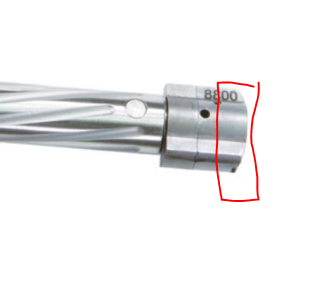

I dipped my toe into precision rifles with a Savage since I liked the ability to change calibers/barrels in my workshop. Put a McGowan barrel on and rented some go/no go gauges and I had a shooter in 6.5cm (before Savage was even offering that caliber, I think.) Pretty neat.
But we know Savage lacks refinement and, importantly, after market support is a little slim.
The Nucleus action isn't in my budget.
I just read there is a barrel nut for the Tikka from PVA. Does it work like my Savage, or is something else needed to be done to the action to allow the Tikka to accept a prefit barrel?
What about Howa?
I understand Bergara is a no-go.
What other actions accept the barrel nut/change system?
Thank you.

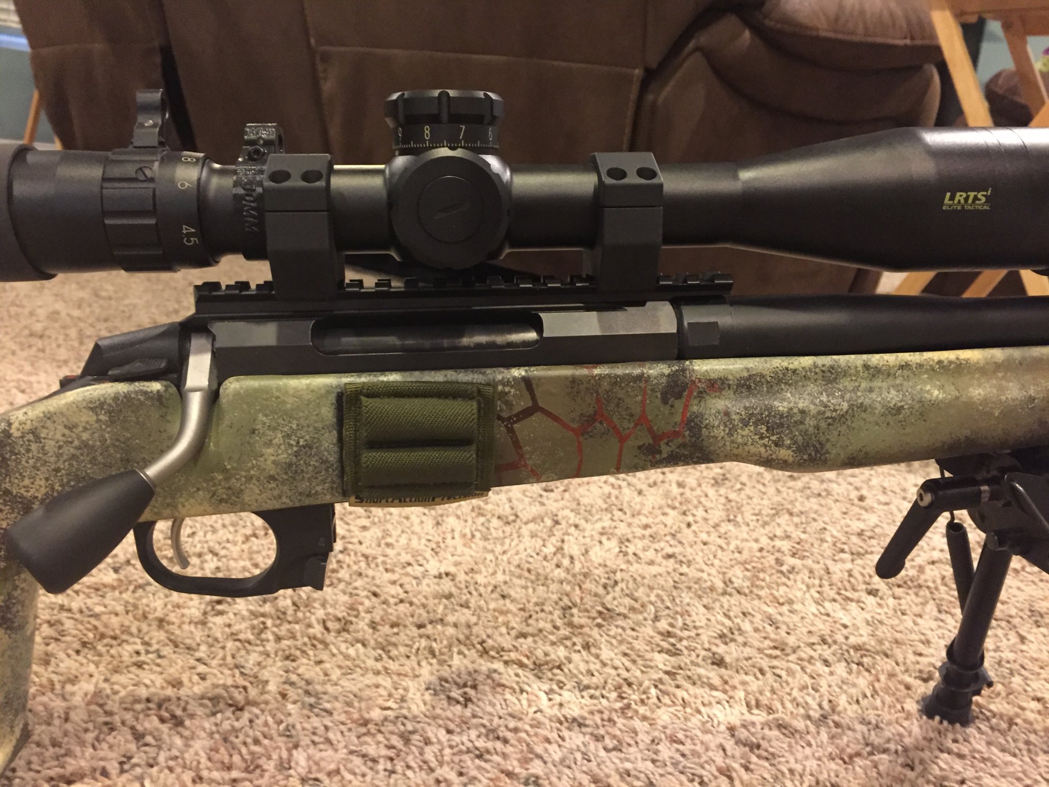

I have a Tikka CTR that currently has the BugNut system on it. I have a PMA Tools vise and I use a PVA inside action wrench to swap barrels. I did have a local smith cut my old barrel off, but I have heard the universal outside action wrench that Brownells will work with the cap reversed. I picked up a new unfired 20" CTR takeoff barrel that headspaces perfect on my action. I can swap between it and the BugNut barrel in 20 minutes or less. I just bought another Tikka for the action and trigger. The same local smith will be fitting a new barrel to it when I am ready. He can fit shouldered barrels that I can still swap at home.
All nut set ups work just like the savage. Instead of cutting the shoulder (controls how far it screws in) precisely on a lathe you just screw it in until its in the proper location and use the nut to lock it in place: its an adjustable barrel shoulder.

Howa has some offerings now.
Bergara has a remington threads but the bolt isnt recessed making all of the prefit remage barrels a nonoption, the bolt will hit the barrel before it can go in deep enough to rotate and lock closed. You could get a nut set up cut for that non recessed bolt, it would just be a custom job and not one of the "remage" prefits sitting on the shelf ready to go. (My 2 personal remage set ups were all custom jobs anyways, its not the end of the world, just a bit of a wait)
Bergara
Remington
Other than that pretty much everything can be made to a barrel nut set up. Remington, savage, howa, tikka, ruger etc all have offerings right now from various sources.

I did the Tikka PVA barrel swap yesterday. Or should say I finished it yesterday after 3 weeks of tearing my hair out. The PVA internal wrench for the Tikka is designed to shear at 135 lbs I believe and mine sure did before the OEM barrel popped free. A $20 Tektonik 31mm wrench off Amazon however fit the receiver flats perfect and easily took the barrel off with a cheater over it with just mild hand pressure. I did end up using a strip of beer can to shim between the wrench and receiver so as not to mar it and that was tight enough I had to tap the wrench on with a hammer and a bit of grease. Used a Brownells barrel vice BTW. I wanted to keep the OEM barrel for hunting so did not make a relief cut on it.
The PVA barrel was ridiculously easy to put on and headspace with the nut. Took less than 10 minutes to get it right and triple check it. It was my first time using a barrel nut so it took more time to watch a Youtube video on doing it than to actually do it.
Action wrench and barrel vice. Or if you have a sturdy chassis you can probably make it work with just a barrel wrench with a torque wrench socket.
And a go gauge to check headspace. You can either use scotch tape or paper on it for a no-go or buy a no-go to check it.
I started to tweak my PVA inside action wrench trying to break my factory barrel loose. That is good to know about the 31mm wrench.

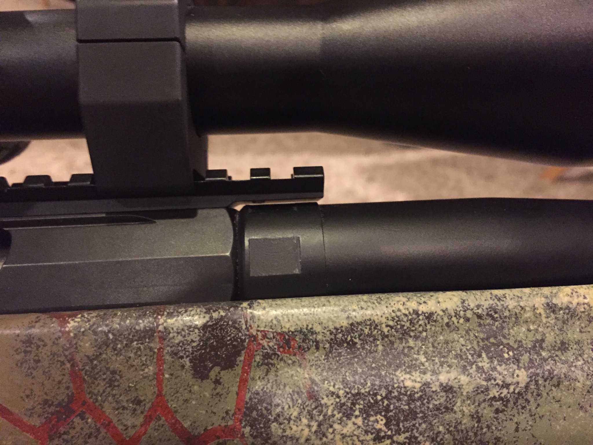

I also used a Bugnut system. Original barrel threads were not as bad as I had heard they could be. But then, I kroiled and PB Blastered it for 4 days waiting on tools to arrive too, so maybe advance preparation helped. I used a brownells universal wrench and a viper barrel vise. I'm looking for cheap tikka actions now for my kid to have his own switch barrel setup.

The BugNut for Tikkas uses the small shank Savage barrels.
In most cases, all it takes to put a Remington prefit on an action that does not have a nose recess is to cut the recess off the prefit. Should take your smith 15 minutes. I've done this to a couple prefits to put them on my Curtis Axiom.

You can do it 2 ways. Either with fired brass or with sized brass(could be fresh brass or sized brass). I would prefer using fired brass as you are setting it to a max.

So the bugnut for Tikka is limited to savage contours?
Or can Greg use any normal contour like with bugnuts for Remingtons etc ?
Also, the Tikka action is a little too small to use a full contour barrel. The shank needs to be turned down to around 1.1875" in order to not have the shank bigger than the inscribed circle of the action.
Greg did my Tikka bugnut barrel with a regular barrel, he just turned down the shank to Tikka's action specs.
