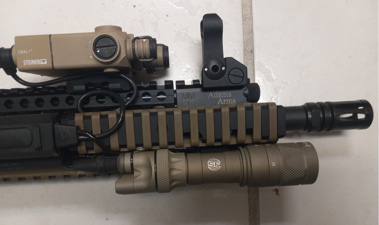

This is the FSP on the 11.5" showing how the gas block fits in the rail and extends. Troy front sight folds down in front of the laser.
