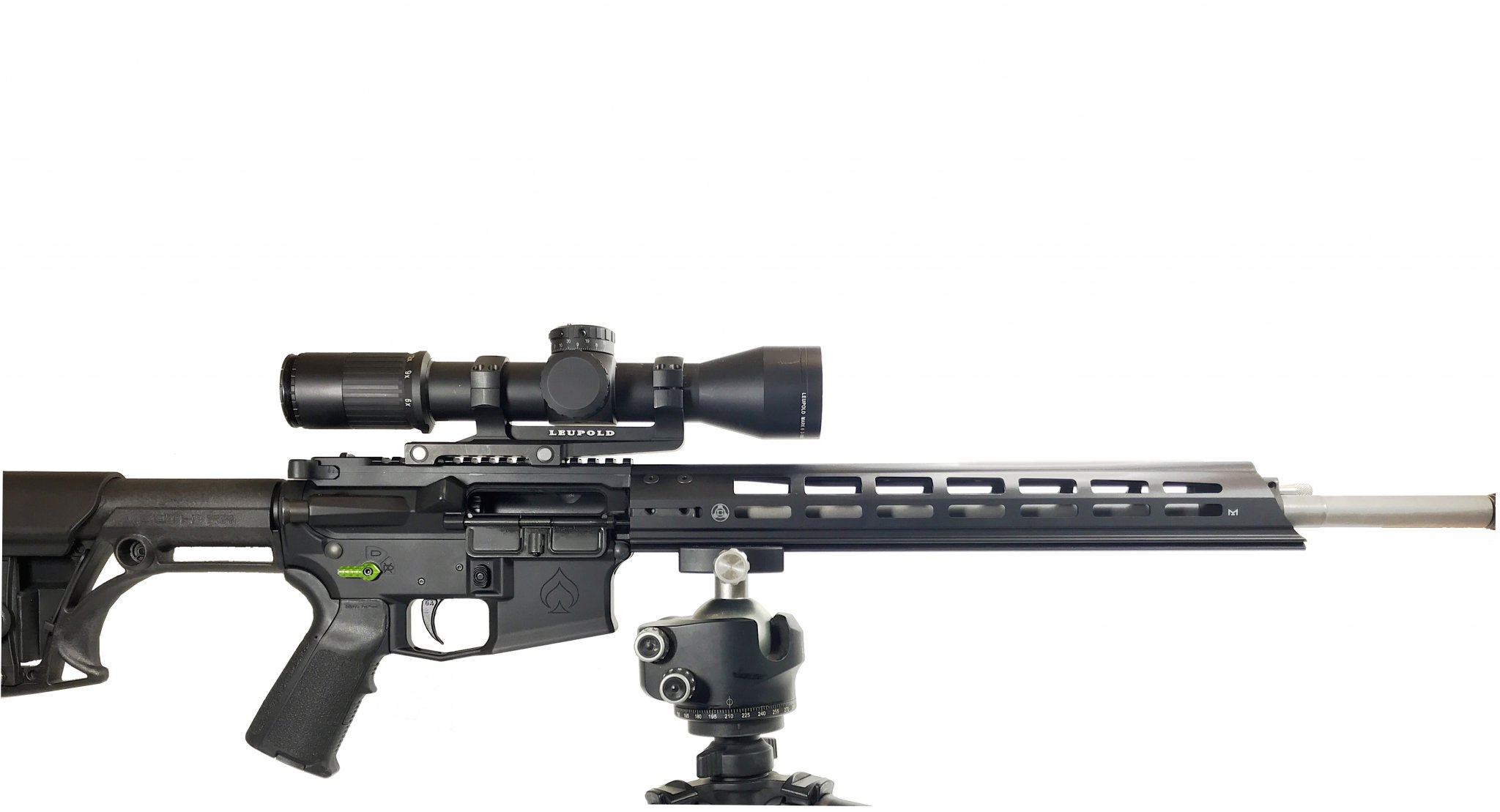

I have an upper with the BCM MCMR hand guard. It's relatively slim on the bottom and I'd like to add an Area 419 MLOK ARCA rail. The rifle is an 18" 6.5 Grendel that will be used in DMM type shoots.
My first thought was to swap this hand guard out for a Seekins SP3Rv3 with the wide flat bottom and then add an ARCA rail.
But, if I'm adding the ARCA anyway, do I need the Seekins wide flat bottom? The ARCA would become the most bottommest part of the system, right?
Would adding a rail to the narrow BCM hand guard seem out of place, unstable, etc? WOuld it give weird geometry/grip for off hand shooting?
Current hand guard:
