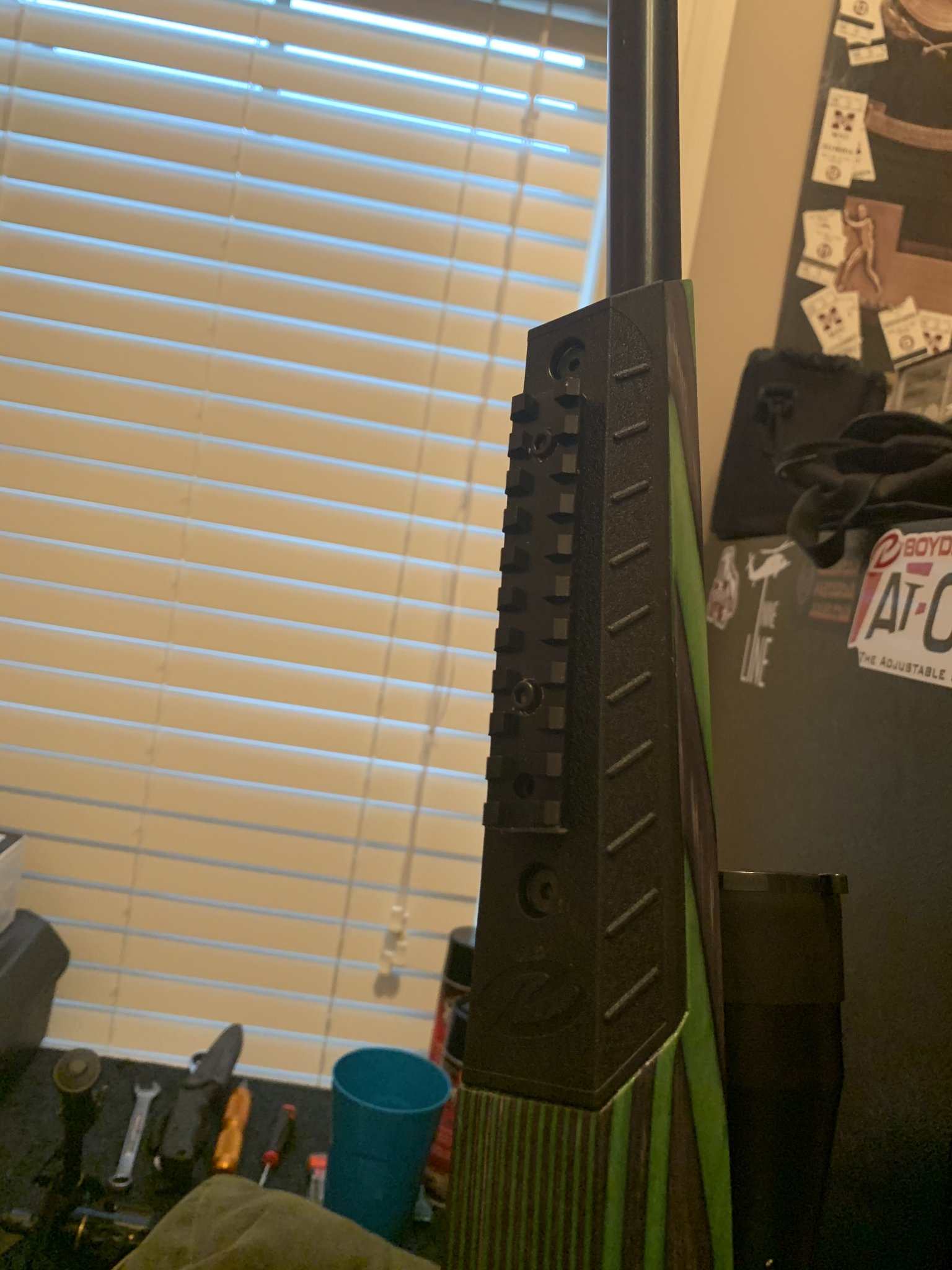

    I put a picatiny rail on mine and drilled and counter sank #10 screws the attached to the sling mount nuts. Plan to put the area 419 universal on it as soon as it comes in with the same screws.

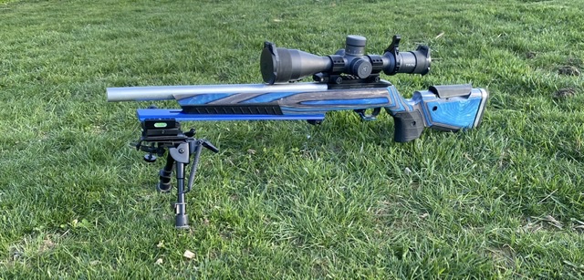

    I added one to two At-One stocks. I made my own though. I’ll get some photos and post them later. Making an Arca rail is pretty simple with some basic tools. I cut the ones I made out of G10/phenolic sheet. You just get a 1/4” thick sheet from amazon or fleabay, slice it to 1 1/2” wide and put a 45 degree bevel on each side. I use a router to cut mine but there are plenty of other ways to do it.
    This is the rifle with the rail. I’ll post some photos of how it’s attached when I can get some photos. If you notice I also added a barricade stop as well.
