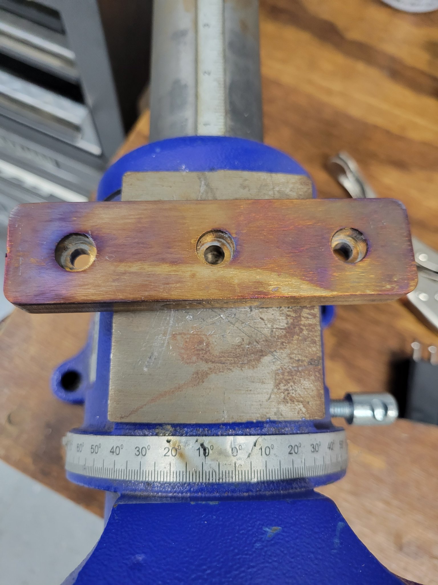

So I decided to try something. I made these today which should come out to about 1lb each( second one not pictured) and will bolt directly to a mlok.
The reason behind the color is due to I work alot with stainless and have always loved the colors of heat affected zones.
We will see how it works, if they don't I'm out a little time. They are 0.5" thick so about the size of the ones you can purchase.
