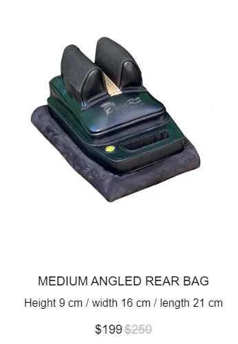

what rear bag?
I'm running a Dima. That is the reason for the "custom build" on the bag rider it needs to fit the groove in the bag I'm running.
