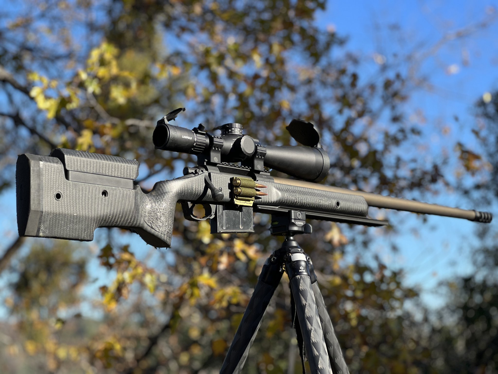

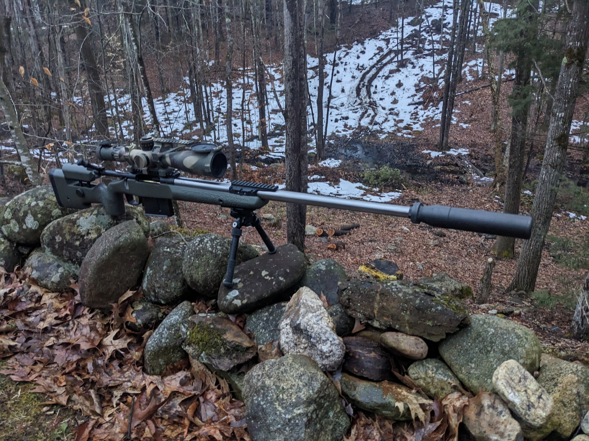

    I have a new 300 PRC build. It weighs 18 lb with a suppressor and ammunition. I'd like to get it closer to 22 lb.
    Are there any do-it-yourself options for me to put weights somewhere in the stock? It's definitely front heavy with a 26-in M24 barrel.

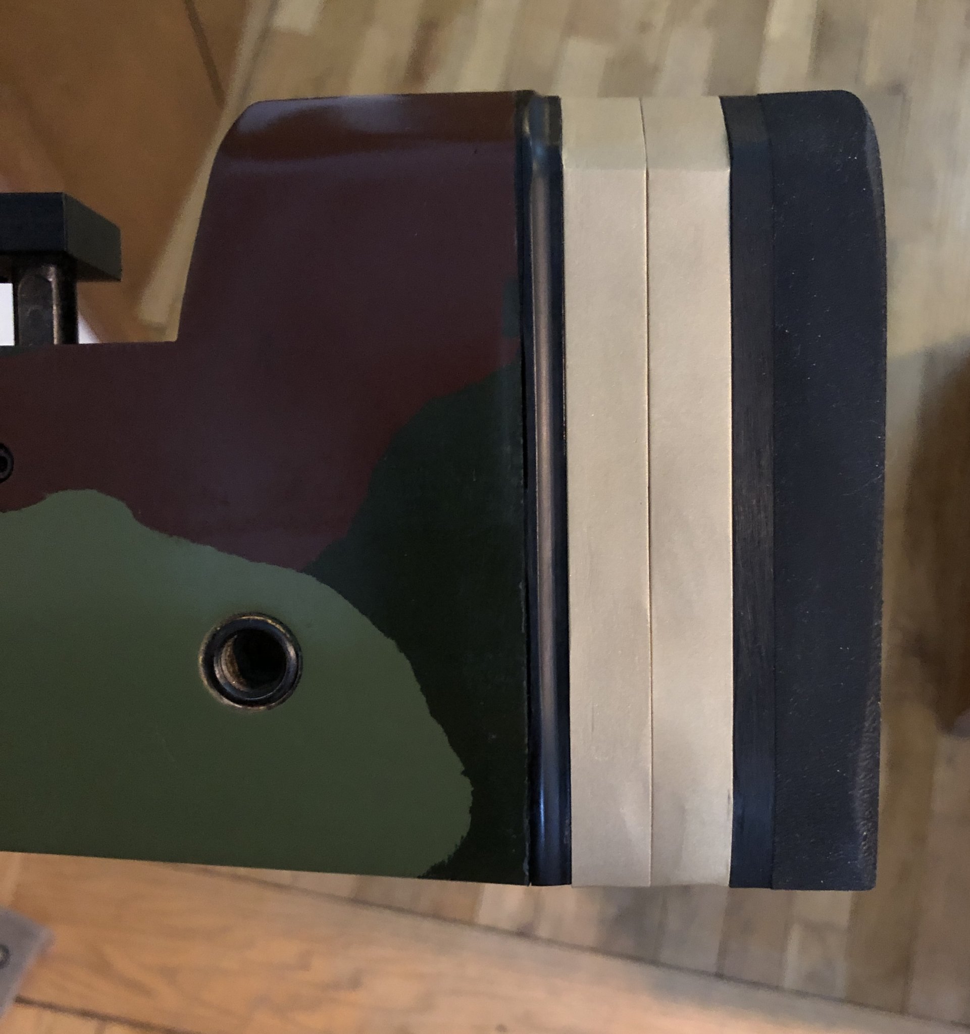

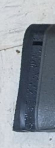

    You could add a weighted arca rail as well. Also if you could remove the buttpad there might be room to drill and fill with some shot there also.

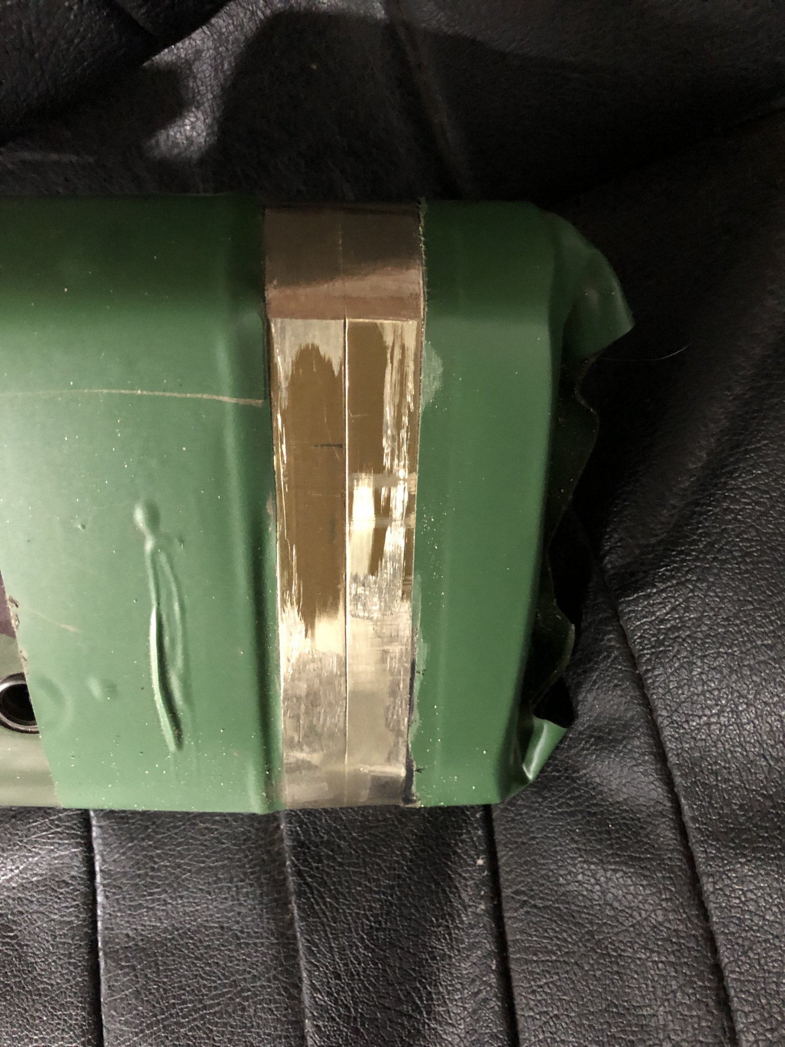

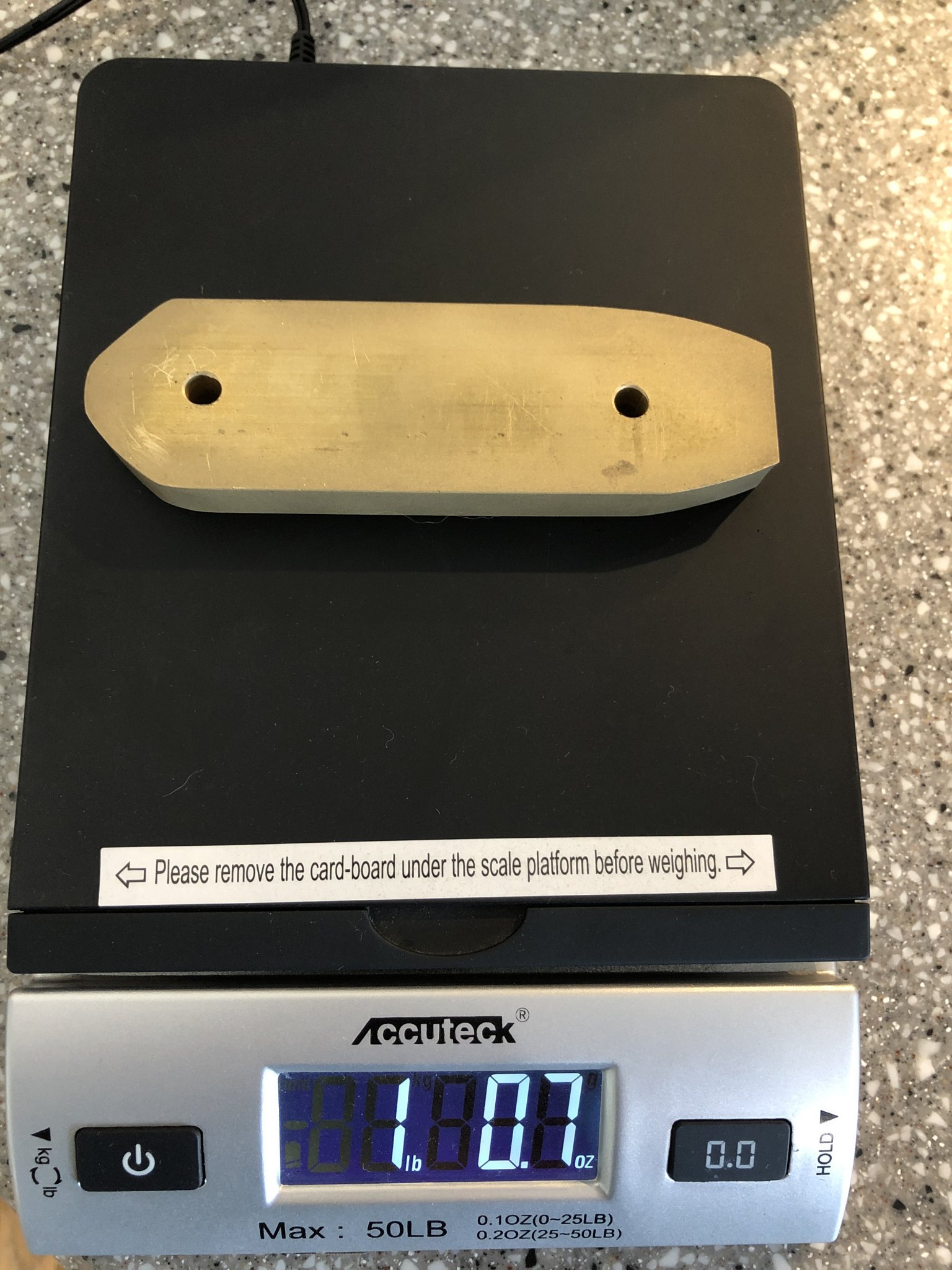

    If you have a vice, a hack saw, a file and maybe some sandpaper, you have everything you need. An angle grinder would be handy. Those spacers are easy to remove and use as a pattern.
    Or make a template by tracing the outline of the stock under the butt plate and find a metal fabrication shop near you and ask them to laser cut 4-5 of them (not sure how many you will need but extras cost less than having a second batch made).
    I haven't but having the small amount sticking out doesn't hurt anything especially if you are just looking to make it heavier. You could always cut it off yourself easy enough and just smooth out the end.

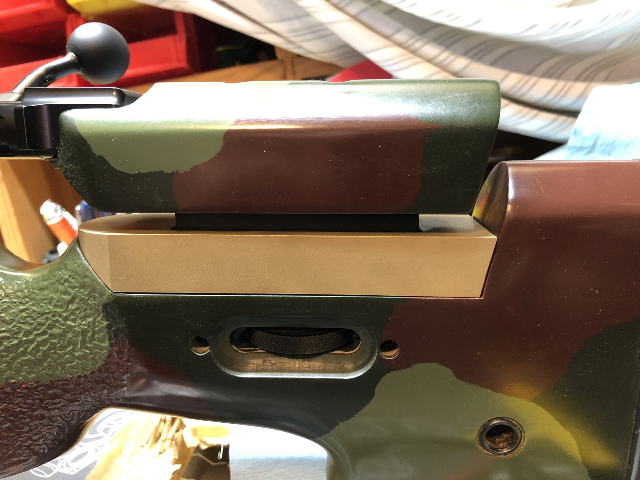

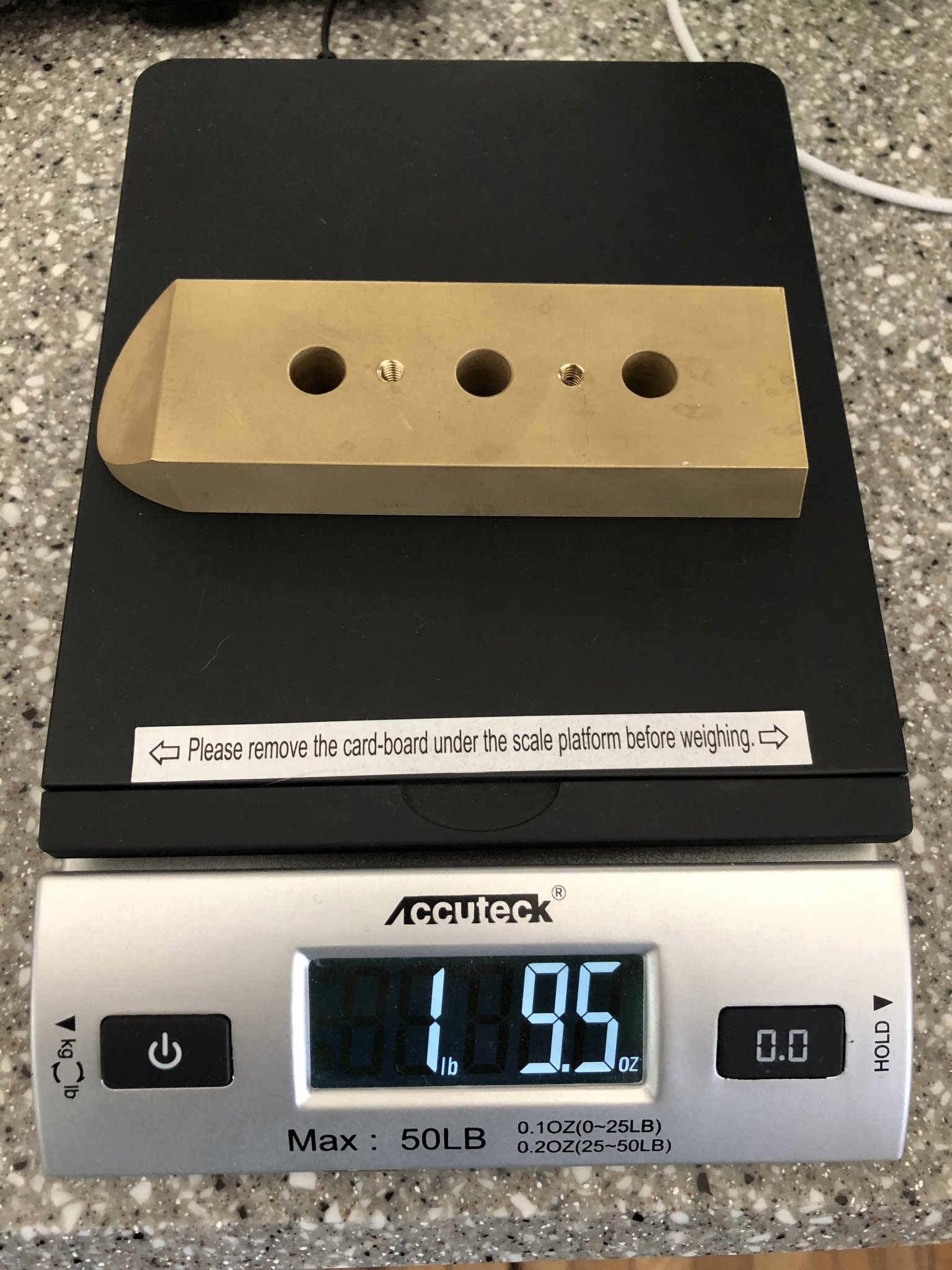

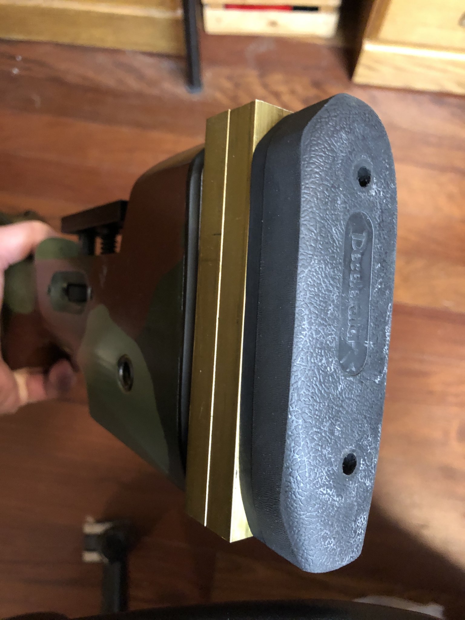

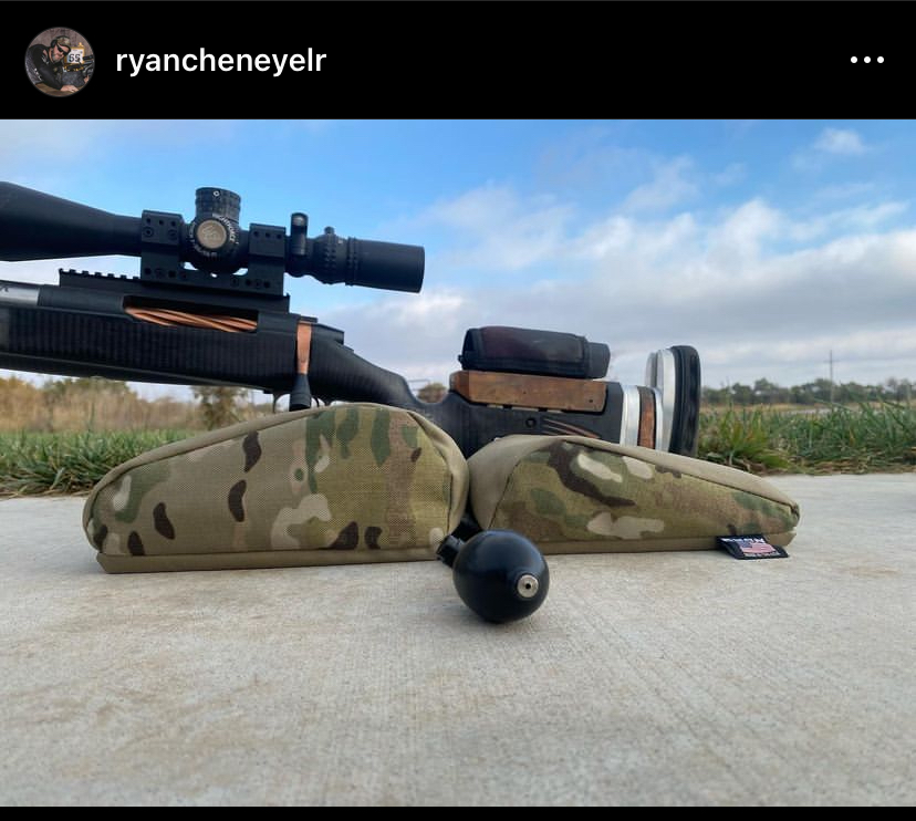

    I’m not making any more of these, nor selling them, but I did make a few steel ARCA rails for some shop rifles that were tapered at the rear so they sit flat against the Manners T4 stock, and some steel “spacers” that fit between the stock and the cheek piece for weight and ballast.
    It worked out well for me. I’m not sure if any one is offering these commercially, but anyone with a mill should be able to make similar.

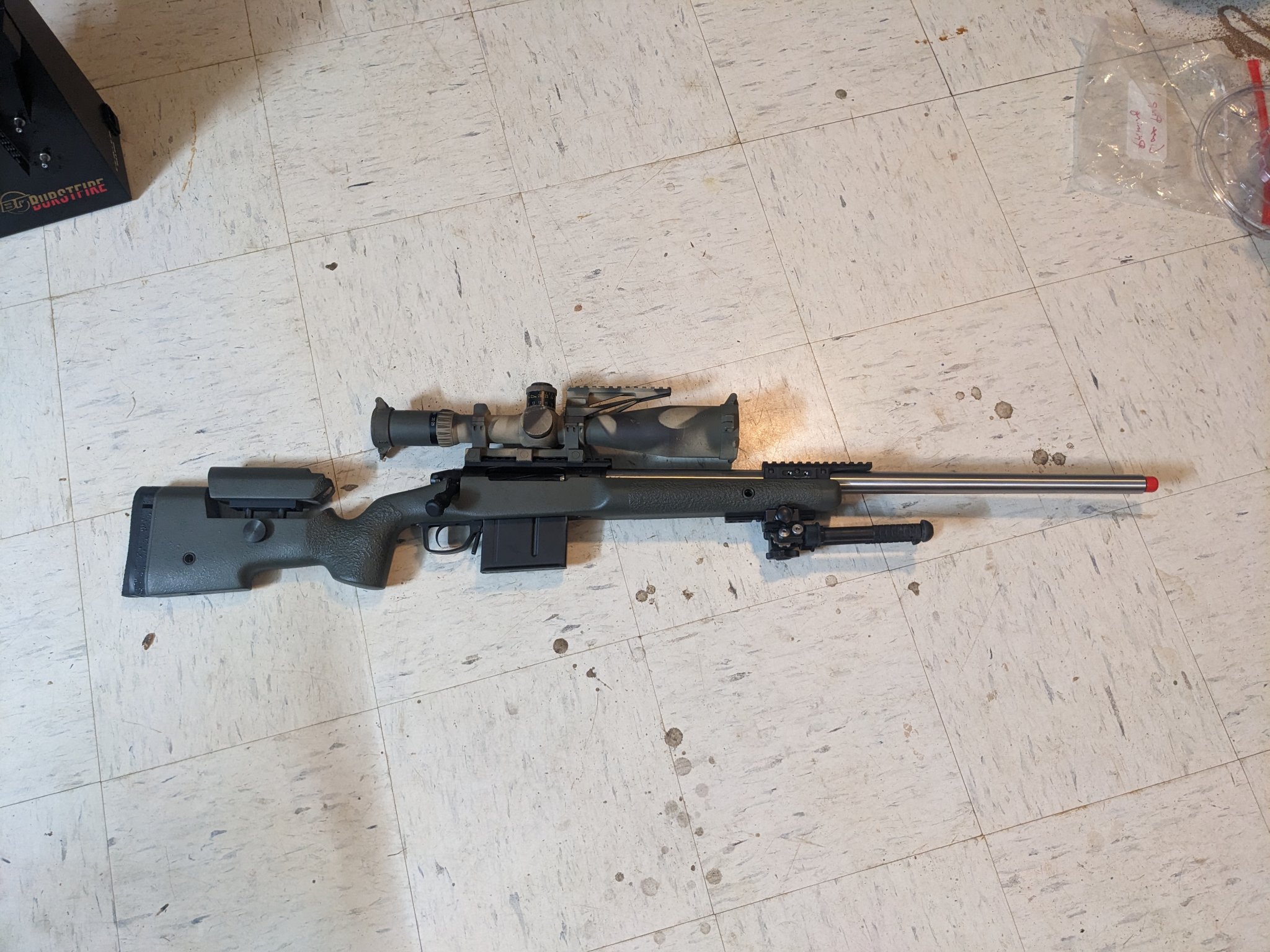

    I got a piece of round stock and had a flat milled into it and some holes then put some threaded inserts into stock to bolt it on as a bag rider type of thing. I think it added like 1.5lbs. I can take a picture if you need

    Man wish I could get one of those buttstock weights. A while ago I saw a manners video with similar weight on the TCS. When I contacted manners about it the said it’s something they had planned to release but decided not to.
